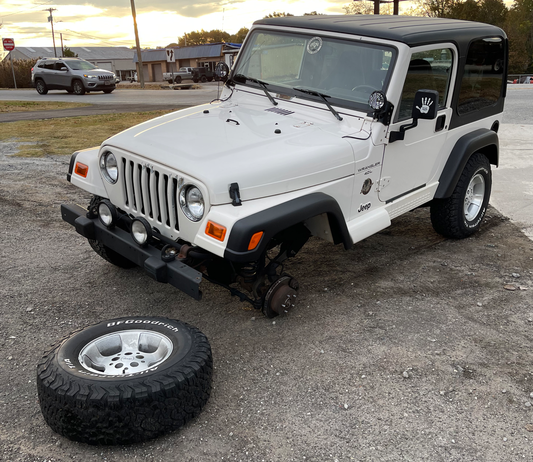

This is more of what my TJ did to me this morning. BMB rotor and pads will be ordered after I inspect the damage at my garage.
Before you ask, the lug nuts were torqued to spec weeks ago. I have no explanation as to what caused this.

You mention that the nuts were torqued to spec weeks ago but were they retorqued about 50 miles later. Alloy rims need retorqued. I found out the hard way with my first set of alloys. Chevy 1/2 ton with camper and car trailer hauling my cj5 at 70mph on I90. Felt a little vibration and next thing I know is the back of the truck dropped and I see my driver's rear tire pass me like a bat out of hell. Took me about 1500 ft to come to a stop. Started in the right lane and ended on the left shoulder. Didn’t hit anyone, tire didn't hit anything, brake drum didn't hit anything but ended up on the far side of the opposing lanes. Every time I hit the brakes it would hook left so it was a lot of on and off the brakes and a lot of sawing on the steering wheel to keep from rolling the whole thing. Les Shwab torqued the wheels and failed to inform me the alloys would need retorqued. They paid for all the repairs. So incase anyone missed it, RETORQUE YOUR ALLOYS!!!
You mention that the nuts were torqued to spec weeks ago but were they retorqued about 50 miles later. Alloy rims need retorqued. I found out the hard way with my first set of alloys. Chevy 1/2 ton with camper and car trailer hauling my cj5 at 70mph on I90. Felt a little vibration and next thing I know is the back of the truck dropped and I see my driver's rear tire pass me like a bat out of -. Took me about 1500 ft to come to a stop. Started in the right lane and ended on the left shoulder. Didn’t hit anyone, tire didn't hit anything, brake drum didn't hit anything but ended up on the far side of the opposing lanes. Every time I hit the brakes it would hook left so it was a lot of on and off the brakes and a lot of sawing on the steering wheel to keep from rolling the whole thing. Les Shwab torqued the wheels and failed to inform me the alloys would need retorqued. They paid for all the repairs. So incase anyone missed it, RETORQUE YOUR ALLOYS!!!
That is some good advice. I have never heard to re-torque specifically for alloy wheels. I have done that with all of my suspension component replacements, but not for wheels.

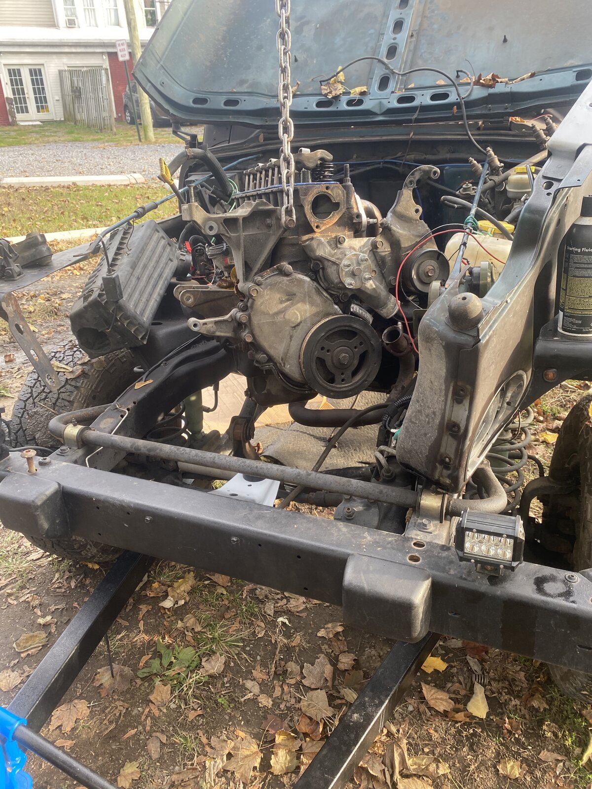

While the transmission was out I took a stab at putting in some DEI tunnel shield. Nothing but bedliner top and bottom on this Jeep. Top side coat was reasonably think but this bottom side was a piss coat. Started scraping it off with a razor blade then got out the flappy disk...took it to bare metal, two coats of primer, then flat black and the shielding. Heater running because it's 39 degrees out. Transmission from Novak should be here this afternoon. Might be driving sans pouring transmission fluid by tonight or tomorrow.
