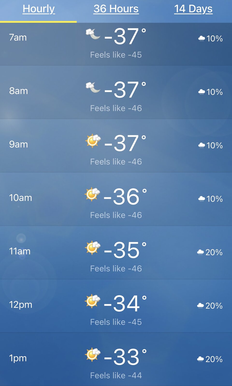

Don’t think I’ll be installing my rear bumper frame tie-ins tomorrow…
(This is celcius btw)
