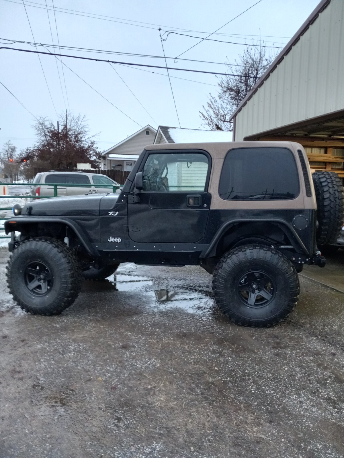

Paramount brand abs. Don't know if I want to smack them very hard. I see some GR tube fenders in the future.
GR Tubes in aluminum are what my Xenon came off to replace them. Xenon are the same style as yours. I rubbed by plastic flares on a couple trees without too much damage - definitely will scratch or gouge the plastic but that hit that damage doesn't show those rubs at 10' away.
Reactions: All 4 Wheelin'
What size did you go with?
