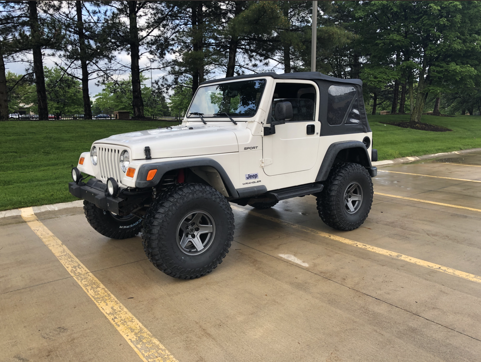

Yeah, that's really a great looking stance.
What all have you done to it to accommodate the lift and tires?
In that pic 4” Currie lift, 1.25” Savvy BL and 1” MML. Being LJ it was ok with no driveline vibrations.
Have since added SSSYE, rear driveshaft and Savvy tummy tuck. Gears and lockers are in works pending life to stop taking all my toy money.
So that's 5.25" lift total? It looks great!
Just curious, if you didn't have any vibrations what made you decide to do the SYE and driveshaft anyway?
The tummy tuck is equivalent of something like 2” additional lift. So almost certainly would have had vibrations at that point. Factor in great deal on t-case with SSSYE and drive shaft from forum member made it a no brainer.
Gotcha.
Thanks for the explanation! I'm a NOOB and learning as I go. Appreciate it and again, the Jeep looks amazing.

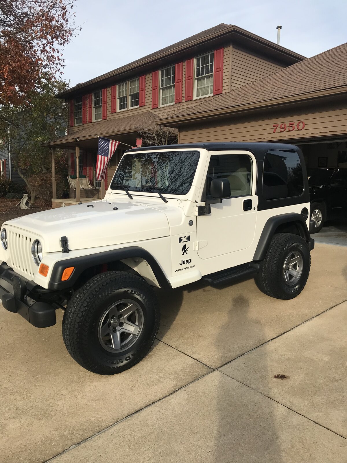

I fully agree with this
same setup here for me.

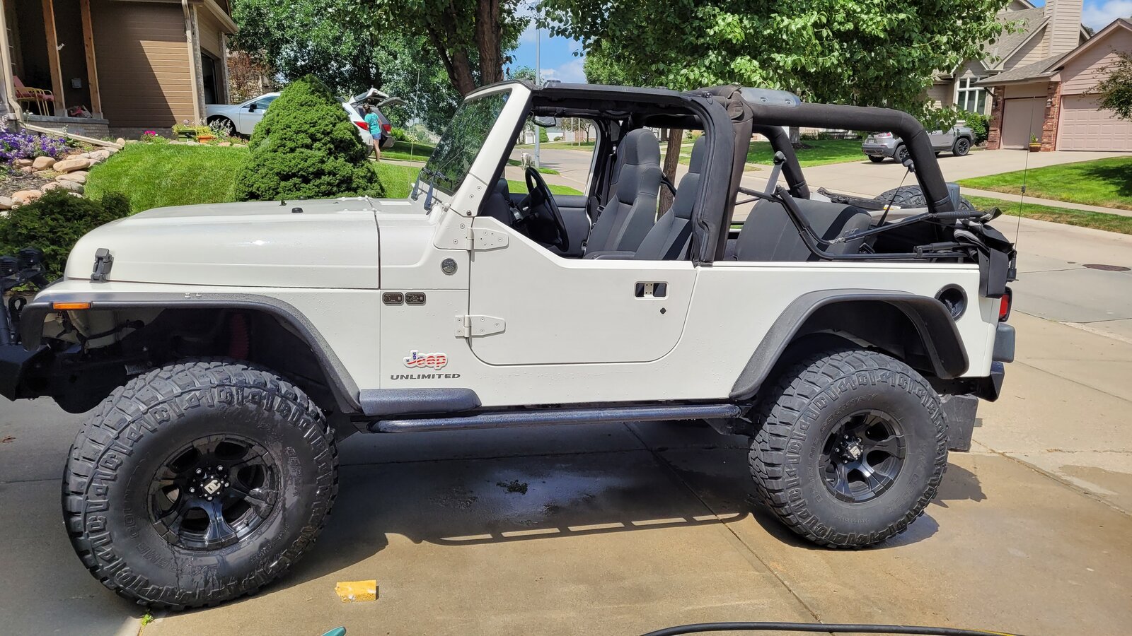

Got the new Nerf bars delivered last night (just ordered them on Monday) and bolted them up quick today before I had to leave for a quick trip. Decided to drive the Jeep an hour and a half for this trip and was glad to have the steps done before we left.
Jeep handled the trip great and cruised at 75 (in torrential rains) for half the trip with no problems. 😁

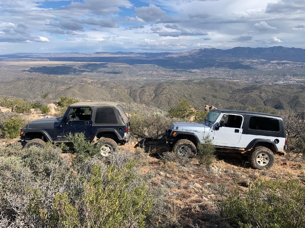

I thought that’s why Greg visits you every winter? Clean your Jeep.
That darn mid-westerner likes to get mine dirty on his exploring missions. Doing some more exploring tomorrow out north of Florence.
Like this exploring trip. We tried to find a connecting trail down the mountain and into Black Canyon City.

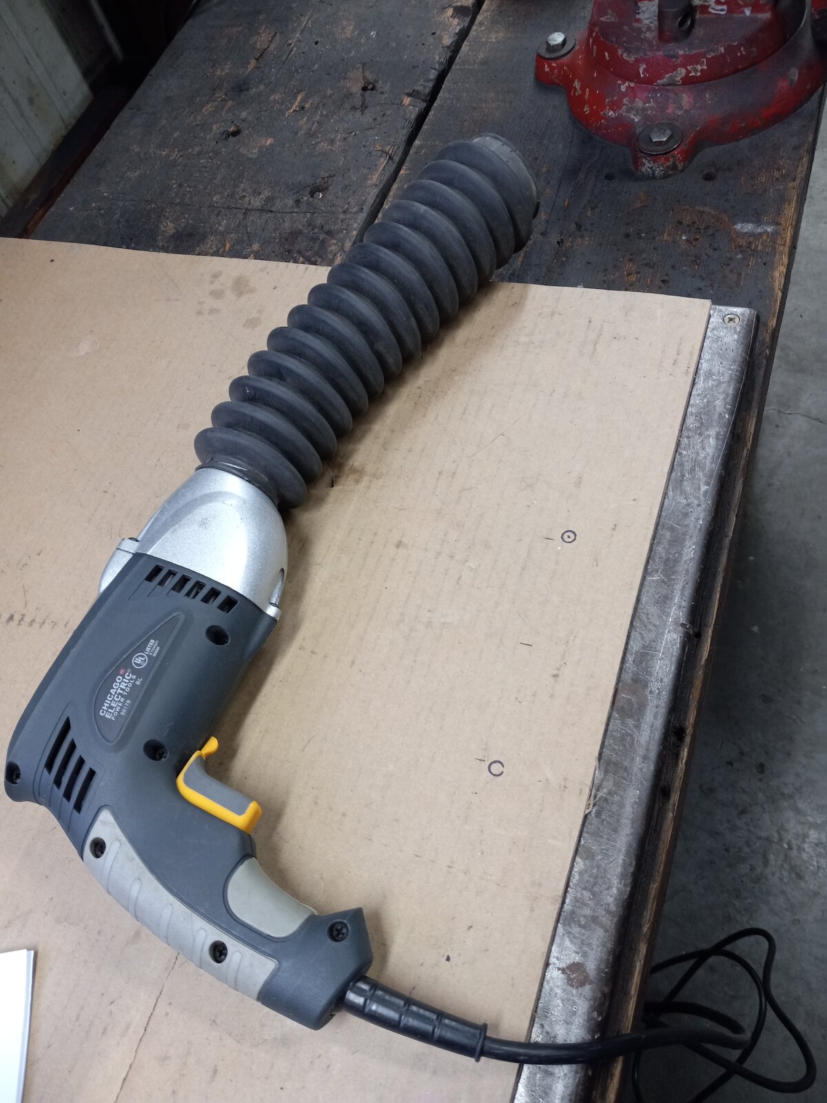

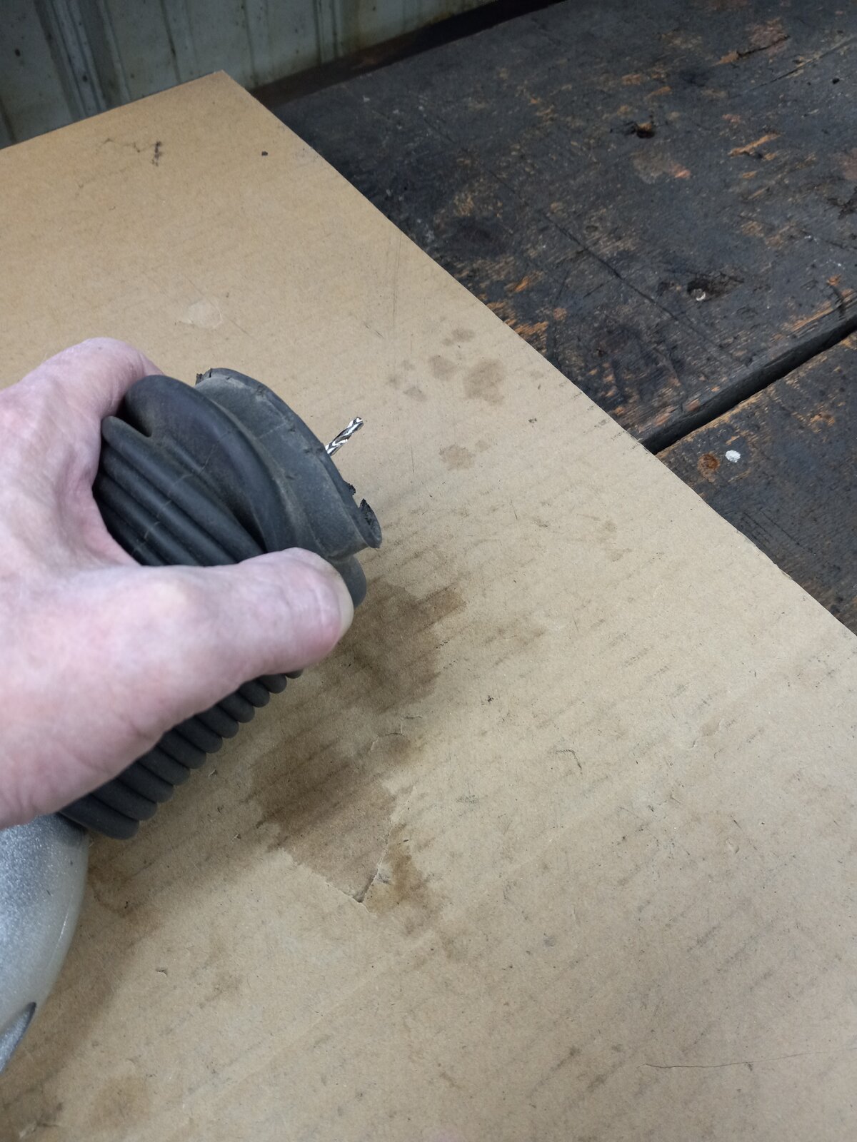

I had to relocate my cb towards the windshield so I could actually see the controls. That meant drilling new holes for nutserts. (I love nutserts) This gives me a chance to share a hack I thought of a few years ago. Don't know if anyone else has. I needed a way to mitigate drill material from flying all over. I had an old rubber shock boot and it just so happens to fit the small opening over the front bearing housing on 3/8 corded drills. The large end will actually form to the surface being drilled. I drilled 2 holes in 5 steps with zero metal shavings.
I have a boot from my new steering stabilizer what was about to go in the trash. Great hack - saving that for the day I need it!
