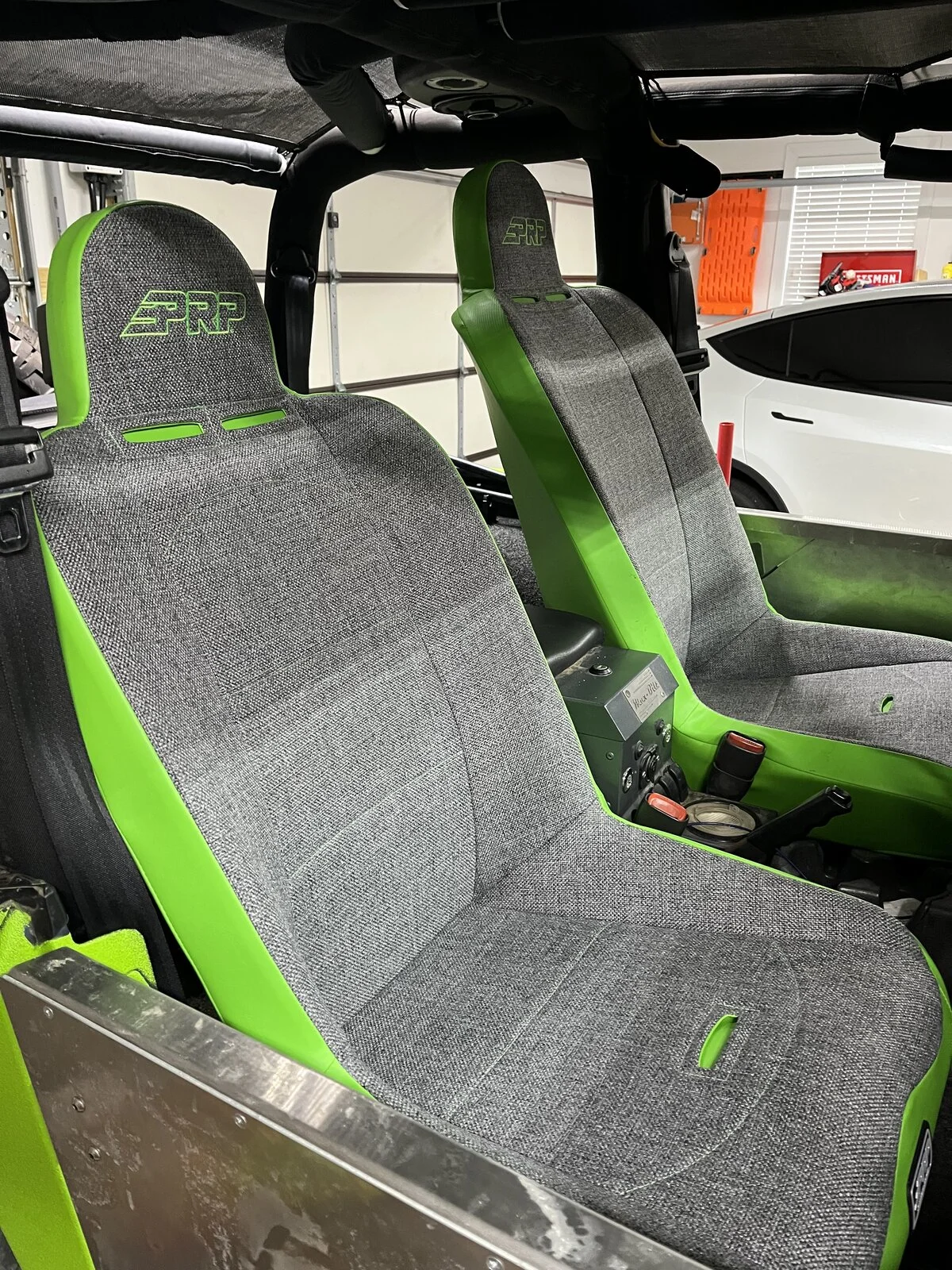

I installed these seats today. The driver side has the +4” and I’m just about to hit the roll bar while sitting in them.
It sounds like the 03-06 seats sit lower than the 97-02. Does anyone know if it all because of the bracket height? I might swap them out if that’s the case. Not sure how to lower the seat otherwise.

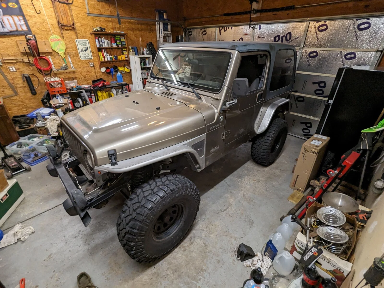

He drove for the first time in 2 years!
Got him buttoned up for a first drive this morning. He was a little sketchy to drive. Definite alignment issue (complete adjustable suspension installed, new steering). He was twitchy, floaty, and dodgy - taking every road bounce as a want to steer the Jeep.
I know the rear track bar @ axle isn't torque b/c it stripped at final depth and stuck there (wouldn't reverse off). I welded the nut in place while the replacement is in the mail (ordered Fri night) so I could drive the first time.
Took a pic of his first meal in 2 years...
Took him over for a 40-mile roundtrip (backroads) to get the emissions test completed so MD doesn't cancel my registration. PASS! Gov is off my back!
It was white-knuckle driving. Took it slow and got there and back. Really need to get the alignment issue figured out. But he drives (barely).
In all the sketchiness of the test & emission test drive, I didn't get any action shots of him out and about other than the above but here he is with a lot more buttoned up.

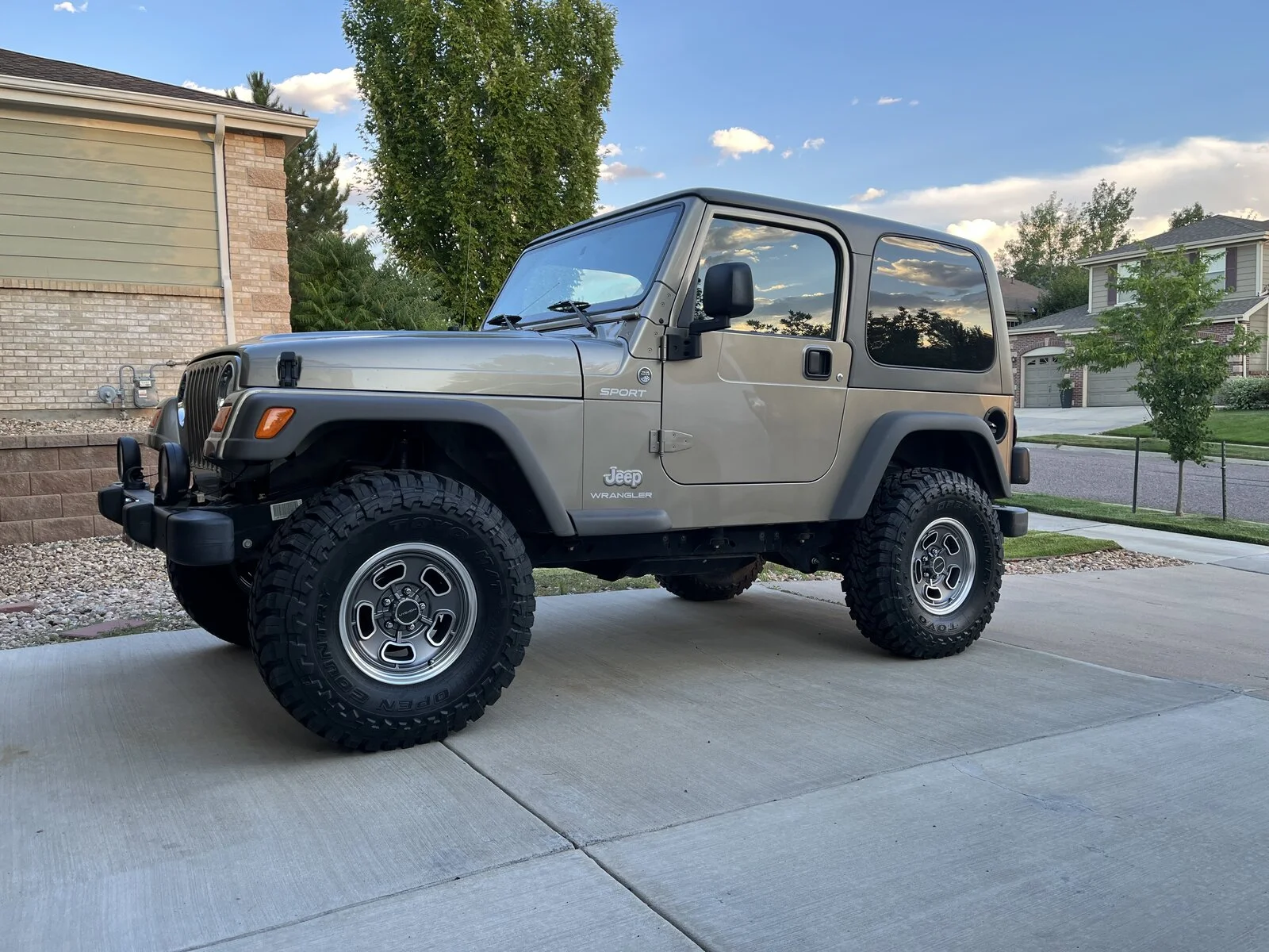

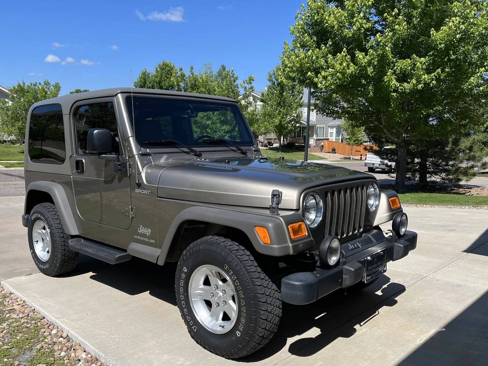

Not just today, but today and the past 2 days after work resulted in going from this:
To this:
Tomorrow I have to install the SwayLoc and winch and get spacers so I can put the spare tire on it.
The wheels are a kind of different take on a classic style slot mag. I went with them because they were the only alloy wheel I could find in 15x7 with between 4.25 and 4.5" of backspacing. I'm probably pulling the tires off the Ravines, selling the tires, and hoarding the Ravines. I would have stuck with the OEM wheels, but I don't really care for 10.5" wide tires on 8" wide wheels.
