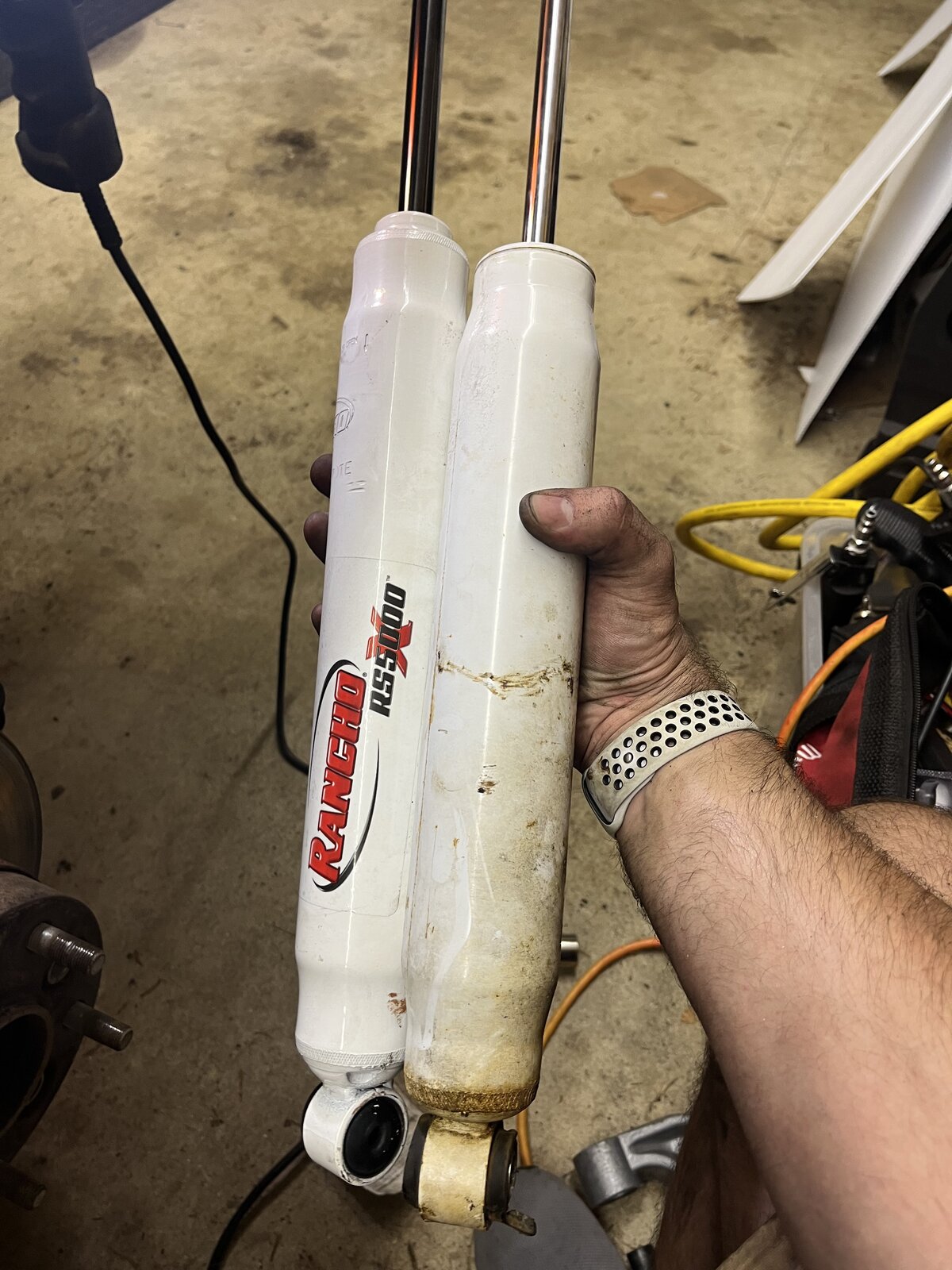

Shocks were shot so I decided to follow the general recommendations and threw some Ranchos under there. Finished just before midnight so I’m putting off the test run for the morning. They look much more well built than my previous hydros so I’m eager put them through their paces.

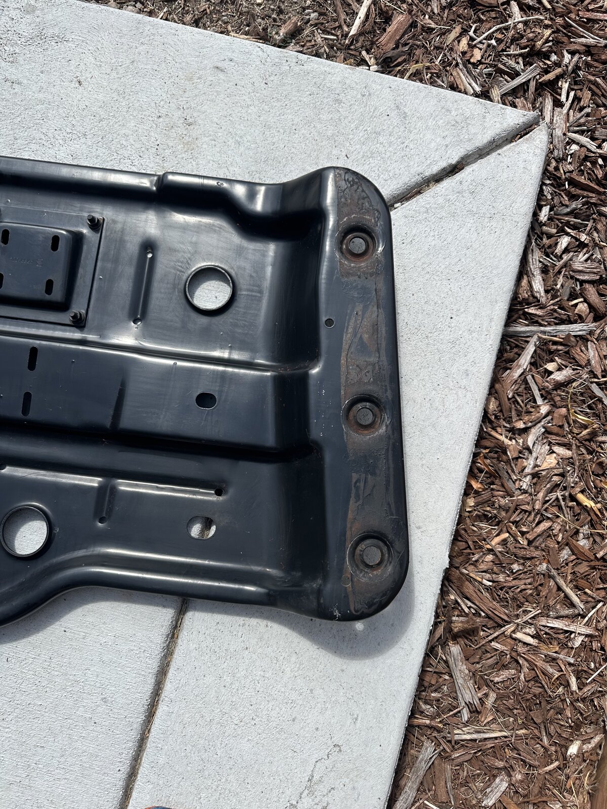

Been tracking down a transmission leak. It wasn't obvious so I removed the skid plate and placed paper towels around every point that could leak above the pan gasket and let everything sit for a day or two. Turns out it was the shift shaft seal. Following some information on this forum, I was able to replace it today without dropping the pan and valve body. Drove it around for a good while tonight and will check in the morning if everything is still dry. I sure hope so.

I replaced my shocks yesterday with the highly recommended Rancho RS5000x as well. The forum was right, they are a very soft ride. I had the Bilstein 5100s and they don't compare. Great ride!

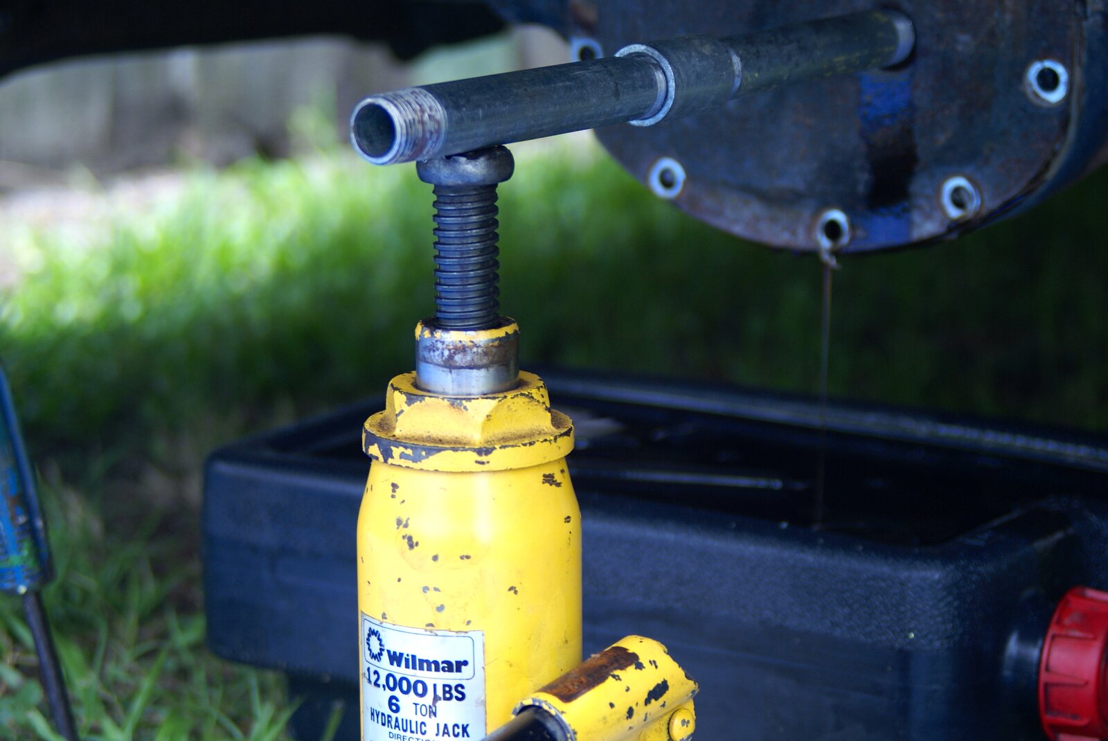

This won't work for a stock rear cover, but my front cover was stuck so I did this:
Didn't need the hydraulic jack to get it off per se, but it gives nice gradient control as opposed to tugging on the thing.

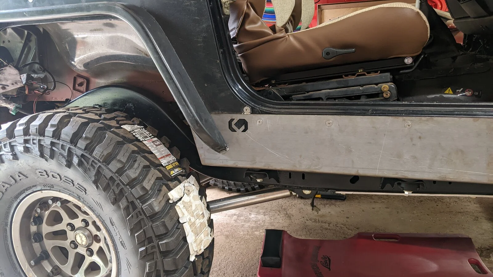

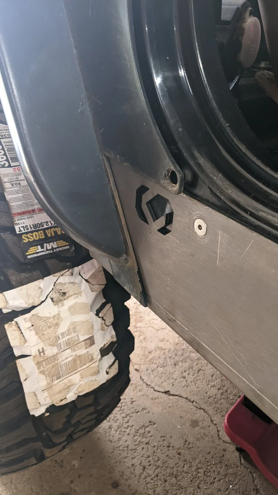

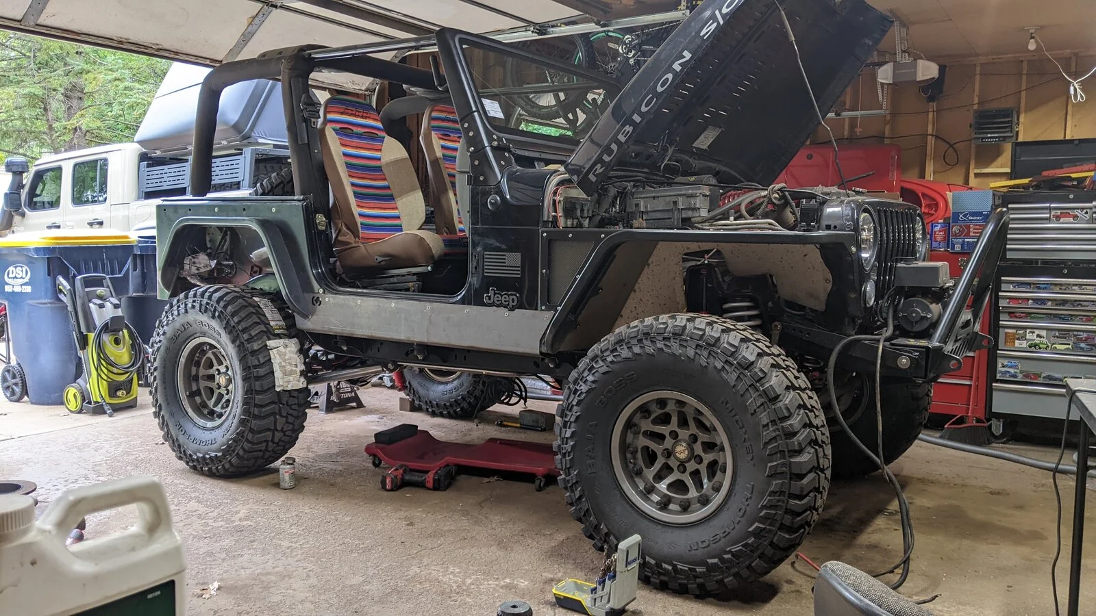

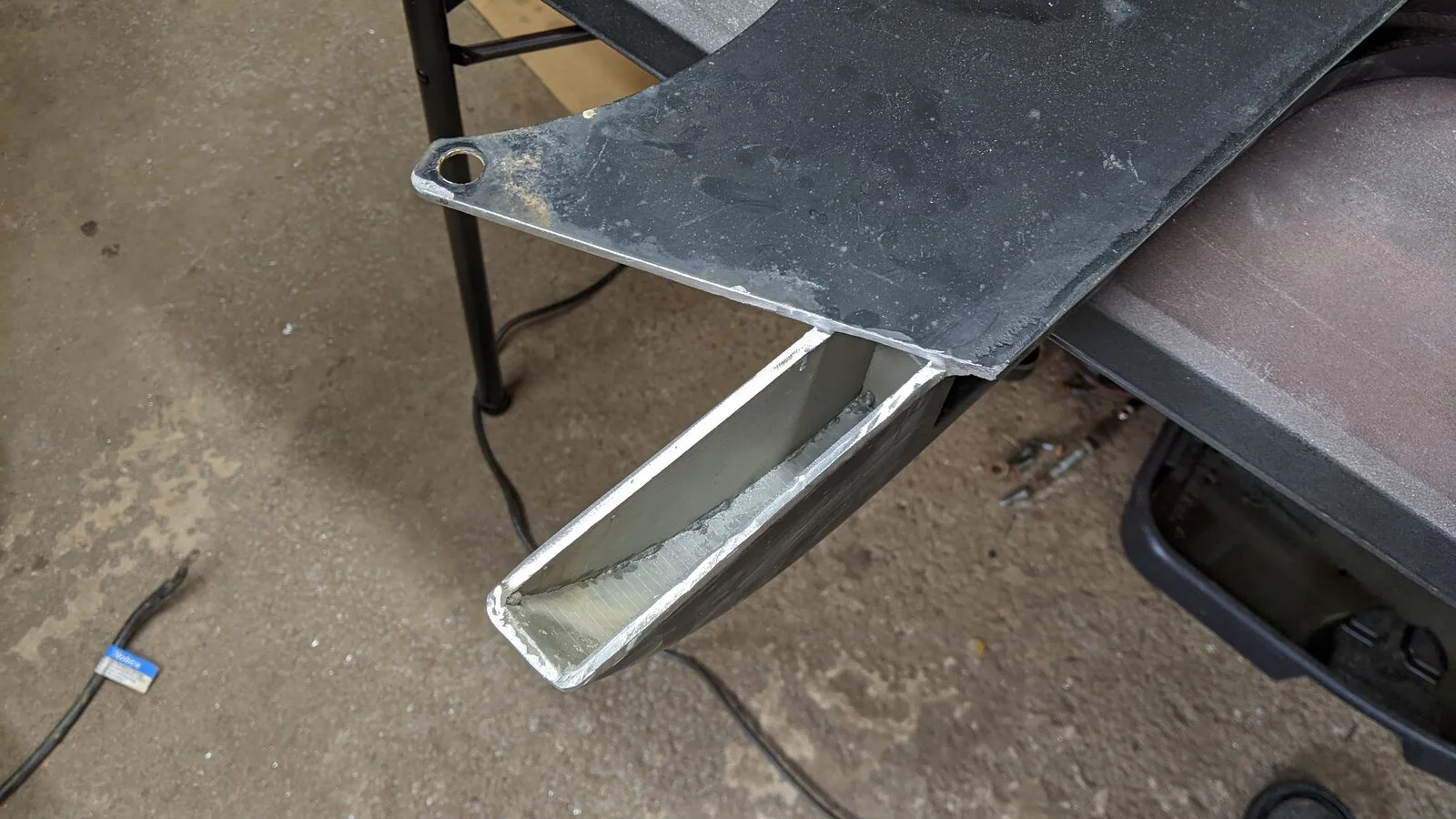

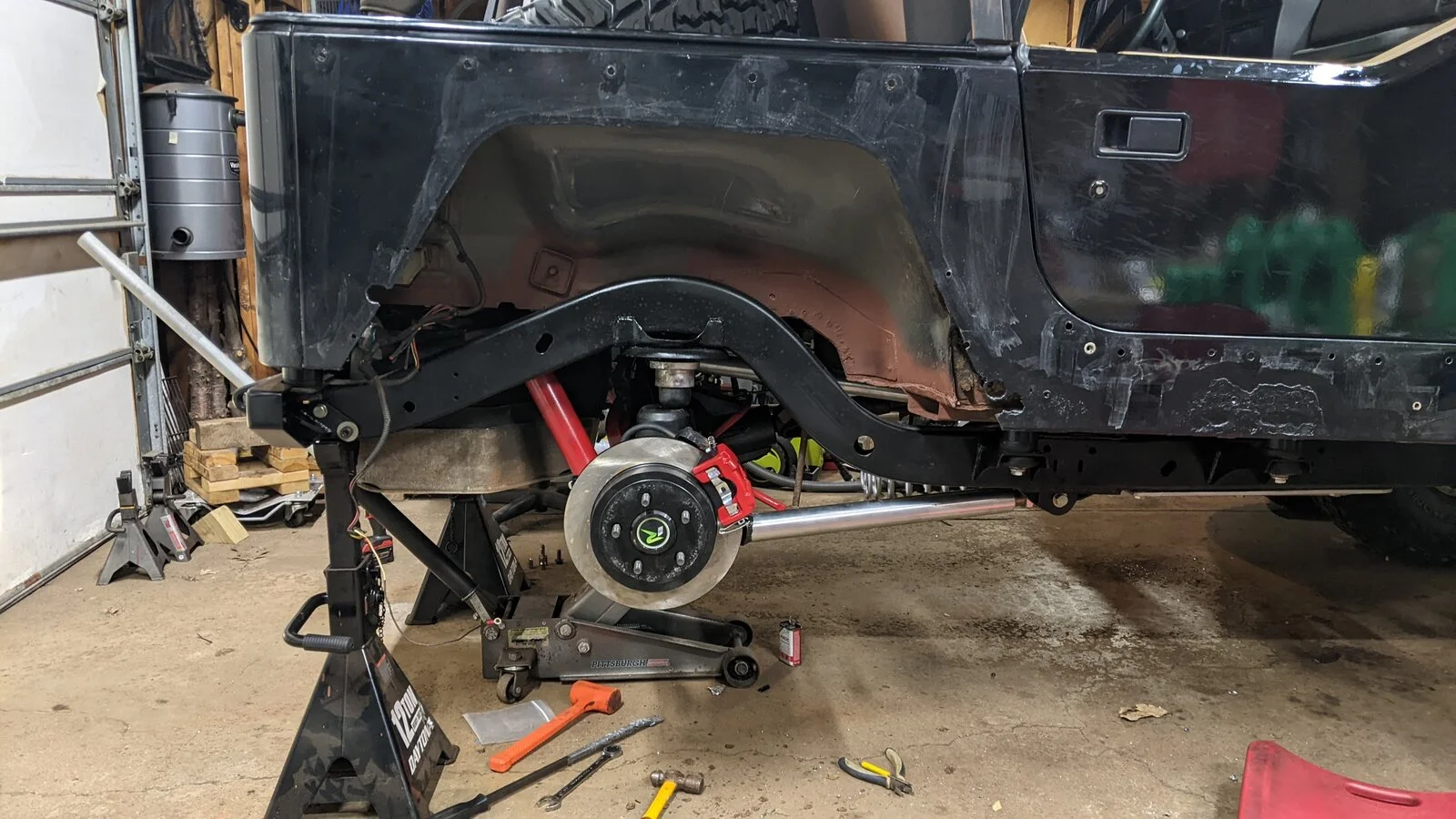

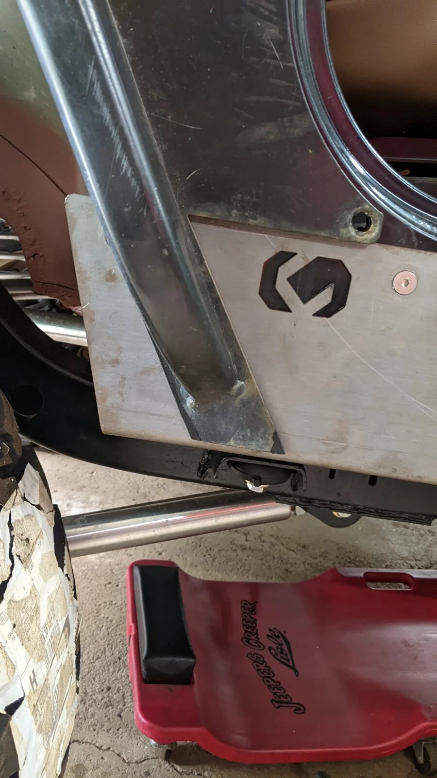

I spent something like 40 hours in the garage over the weekend, I'm not even sure what all I did. Rear coils in and out 12 times. fine tuning axle positioning. Mocked up CavFab sliders. Trimmed poison spyder corner armor to fit over them. Finished installing the interior, windshield header, top, etc. Figured out the OEM seat belts with the PRPs. Painted the sliders. Put the gas tank back in. Maybe I did that last weekend? I don't know. Adjusted the parking brake. Started the process of tying up all the fuel and brake lines and wiring along the driver's side. Not happy with how that's going, but whatever. All hinges, doors, mirror hung and adjusted. Fire extinguisher mounted. In between all that I installed some slightly longer shock extensions on the Foxes on the Gladiator and pulled out the rear track bar to replace with a Currie track but they sent me the wrong parts and it's a solid 4" too short. Removed the rear seats from the Glad... busy weekend.
Leave thursday morning to tour Colorado in the Glad for 11 days. Then I'm home for a week with an overtime shift in there before I'm meeting folks in northern MN for a wheeling trip with the TJ. So... I essentially have 1 day left to get the TJ done.
