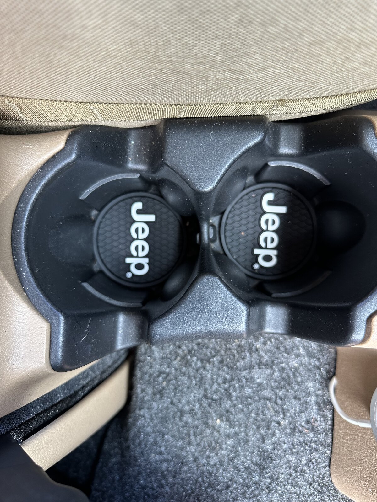

I just removed a matching one of these from my LJ if you're looking to put together a breeding pair...
