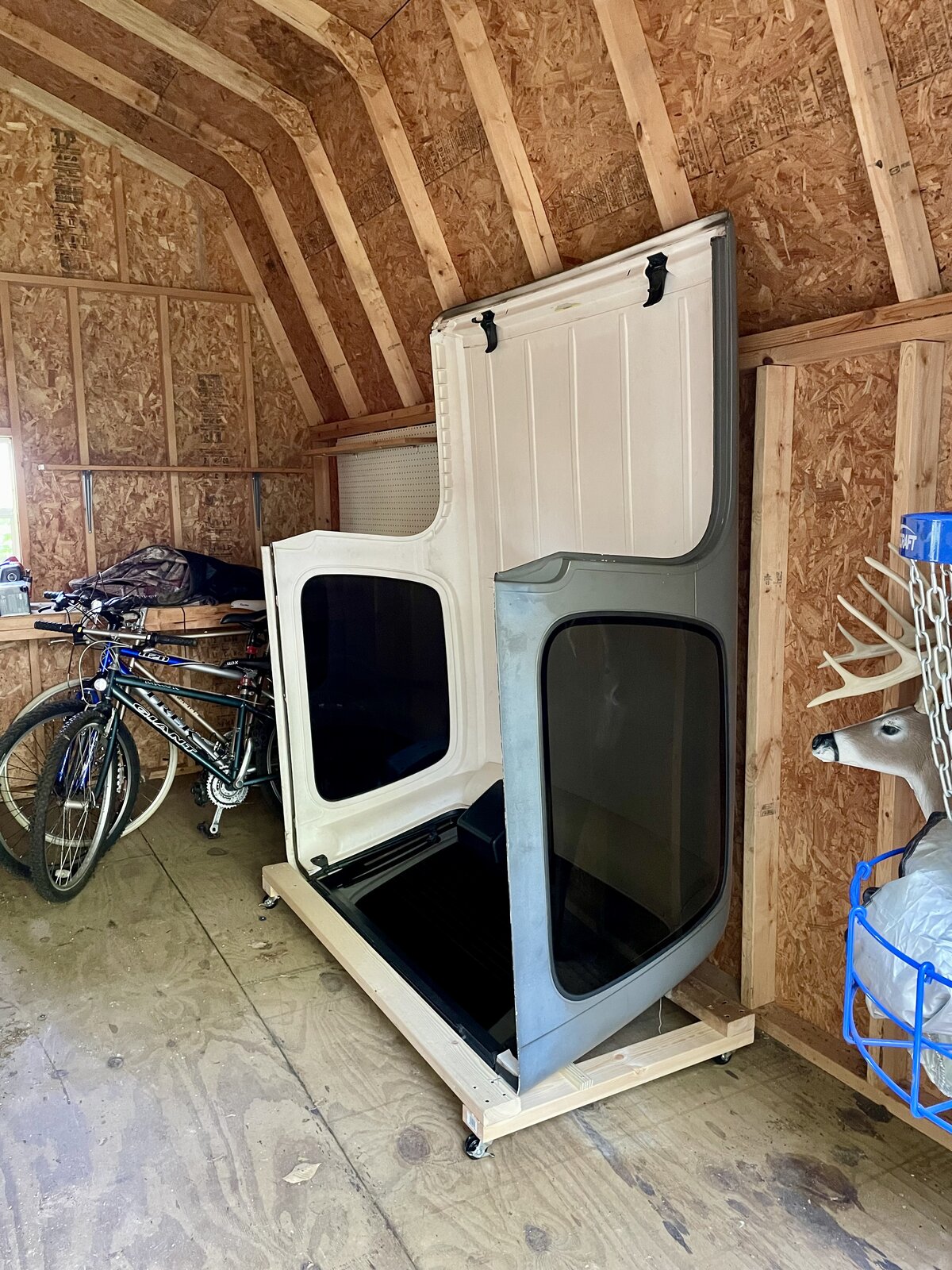

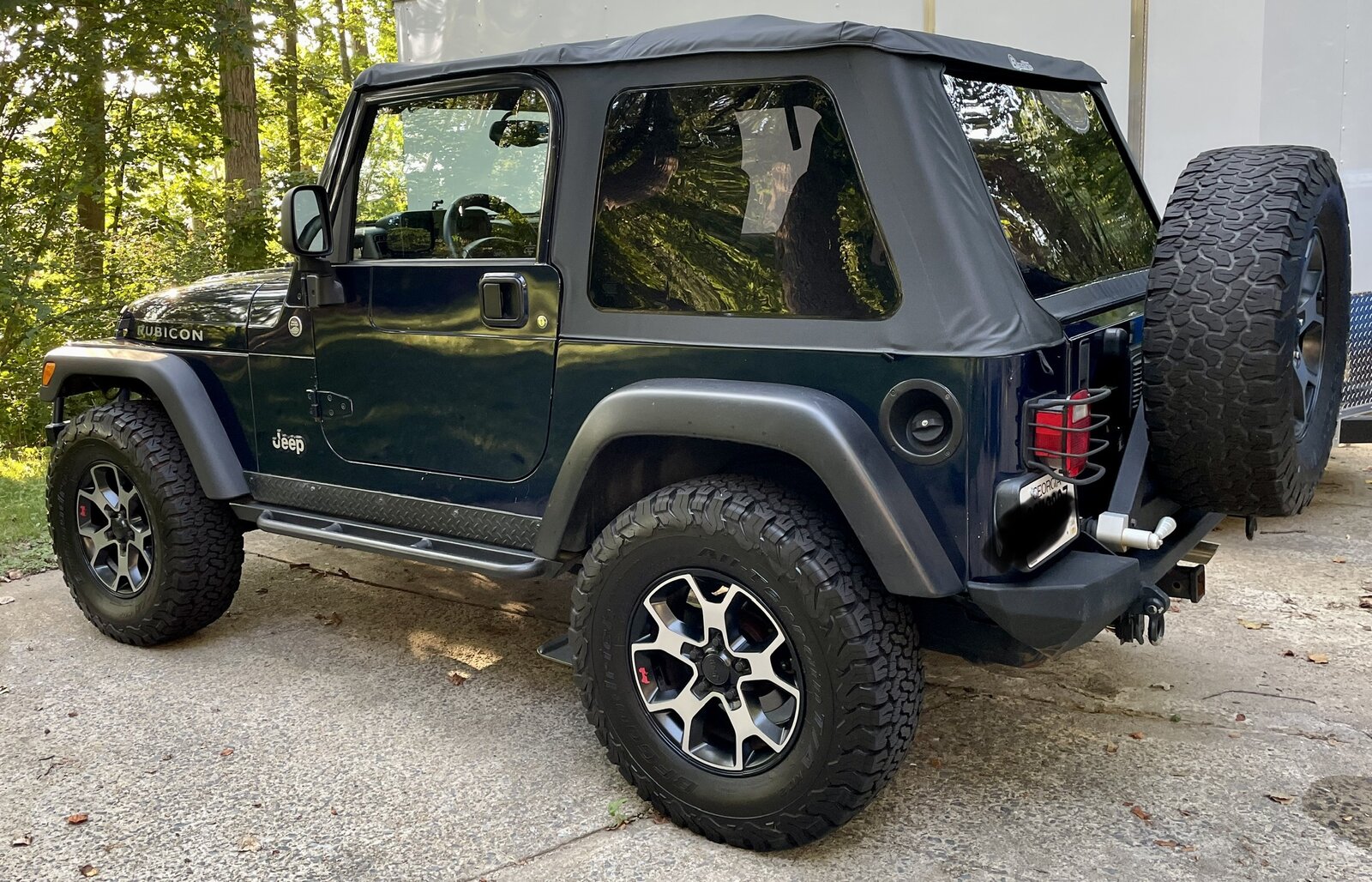

I got my recently ordered Bestop Trektop NX installed, built a hardtop dolly, and stored it in my shed.

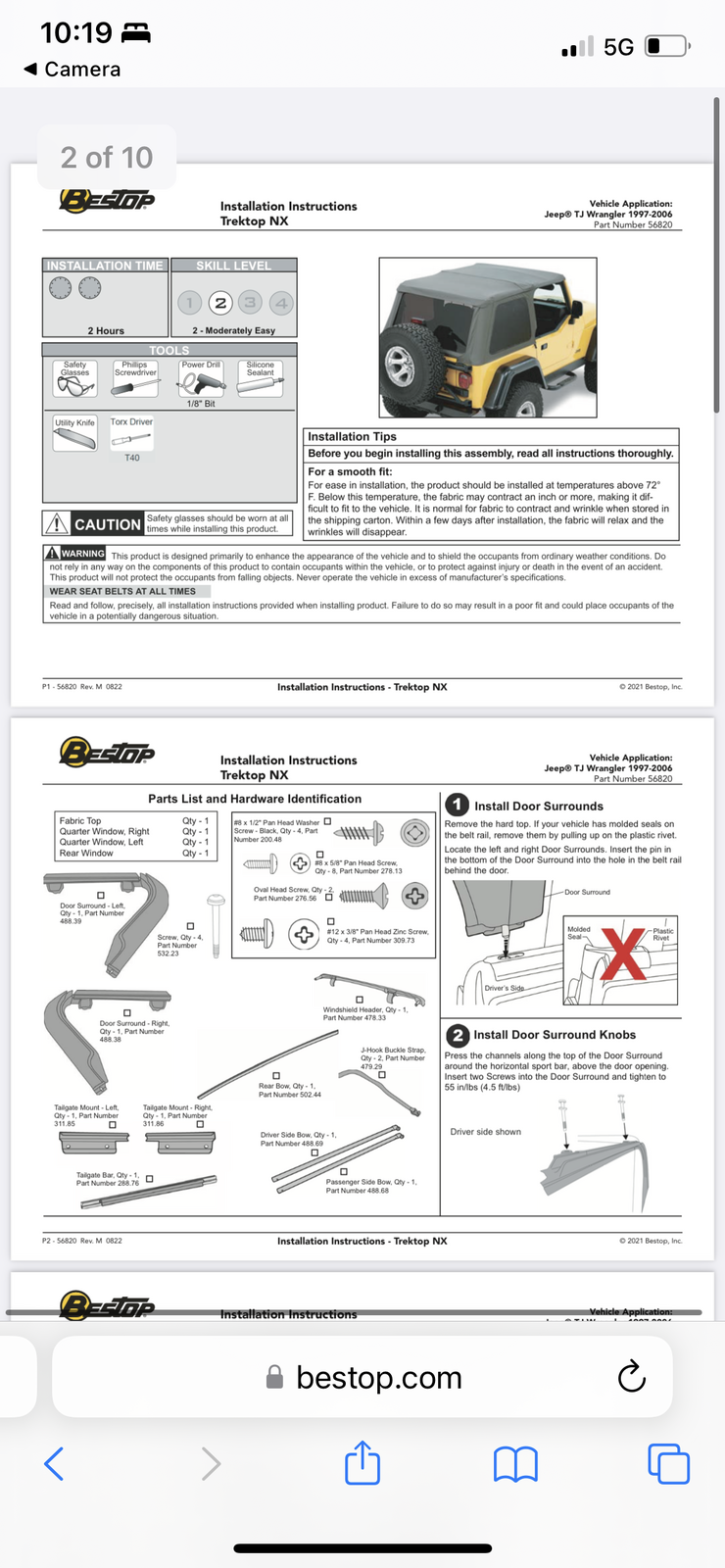

I’m a little ticked about my top though, I ordered it brand new from Amazon, black diamond material. When it came in I noticed it came with just regular screws instead of the knob screws for the door surrounds, the front arch was missing, and two of my windows had cosmetic flaws that were “baked” into the window material and won’t clean off or be fixed.

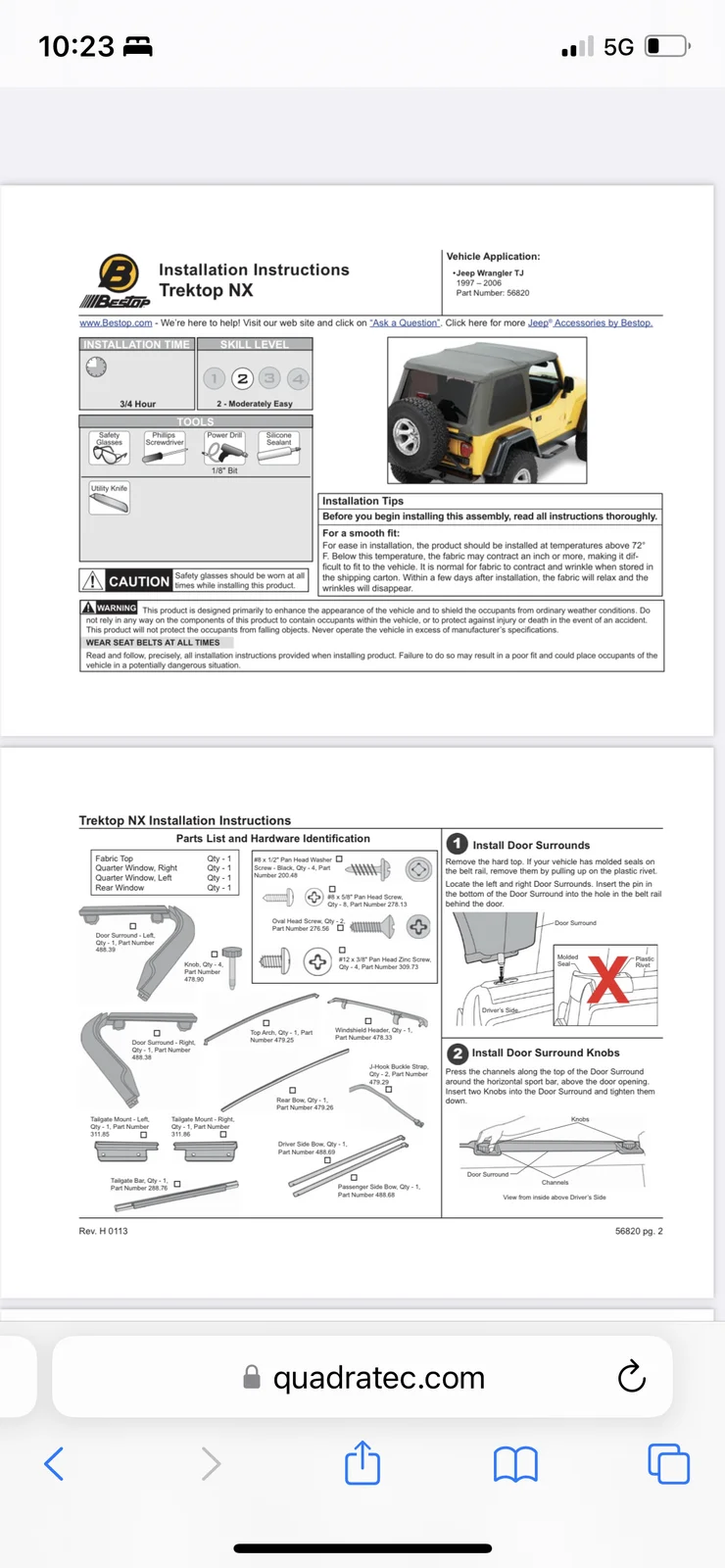

I checked my order, and the part number was exactly the same as what’s on Quadratec, Extreme Terrain etc. But those vendors instructions, including Amazon show the arch included. Bestop does not. See below.
I’ll be giving customer service a call Monday and demanding the arch be sent out asap and see what they say about swapping out my flawed windows. Hoping this call goes smoothly, I’m getting sick of companies cutting corners with quality and skimping on parts to try and offset this garbage economy.
Top seems good otherwise, hopefully it doesn’t leak 🤷🏻‍♂️

Looks like the instructions with the top arch and the knob screws are Revision H and the one with regular screws and no top arch is Revision M. Probably just part of their way of cutting costs. 🤷🏻‍♂️
Check your door surrounds to see if you have the slots on the inside of them for the top arch to fit into. If you don’t have them, it may do no good to get the top arch from them. If you can’t get them to send one, and you do have the slots, you might be able to pick one up cheap on eBay or something.

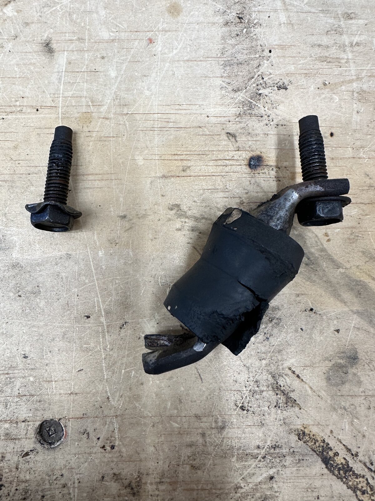

Remember when I said the other day that the rear passenger shock had ripped out of the upper mount point? I got in there and removed the bolts and the bracket this morning.
That bracket was even more vertical than this pic. I had to take the top part of a hammer and straighten it out a bit. That bracket was nearly vertical so much that I couldn't get a socket on the bolt head.
The bracket is out, and the new shocks will be here on Monday. I won't be able to put them on until Labor Day Weekend when I take the opportunity to replace the drum brakes and the rear shocks at the same time since the wheels will be off.
Sure would like to hear the story behind that damage. But we'll never know.
I basically bought it like this. The PO had it sitting in a garage for 3 years so I have no idea what actually happened. All that I know is that last week, I noticed that this shock was no longer attached at the top. I got the shock off and absolutely could not extend the shaft from the body. Nothing I tried could get it to pull out. Considering how it drove since I got it back in July, it has probably been like this for awhile.
