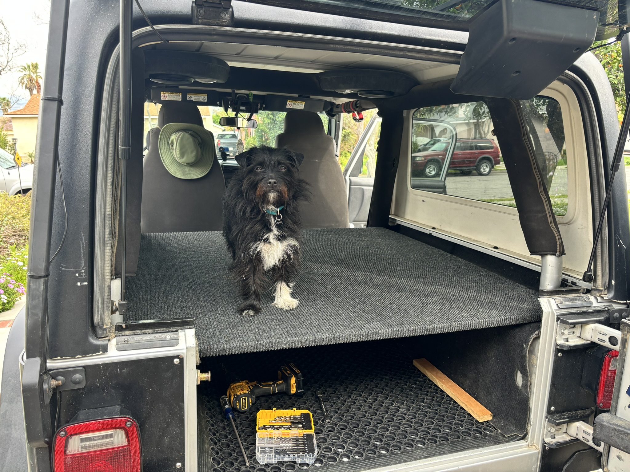

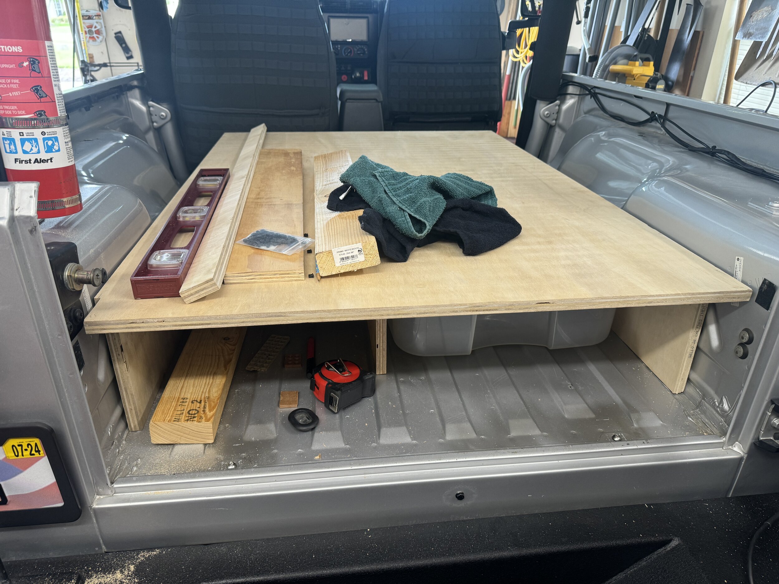

Finally decided on my design for rear storage in the LJ. I have some more shaping to do around the tailgate area to make it fit closer to the tailgate.
Pretty cool. I've been thinking about something similar, except maybe having the ply wood extend across the top of the wheel wells.
I thought of that also. I barely got this out of a sheet that I had cut some shelves for another project. I used similar design in the TJ and it was solid. It does hold dirt between sides and wheel well housings.
I constantly throw around in my head building something like this but I think my biggest question is how do you mount it to the tub. I would think I would like some sort of a quick release system so I could still remove it or build it in a manner that the dogs could ride on top. I know there is many threads on this.
Mine will bolt to the same place the rear seat brackets bolted with aluminum L bracket.
