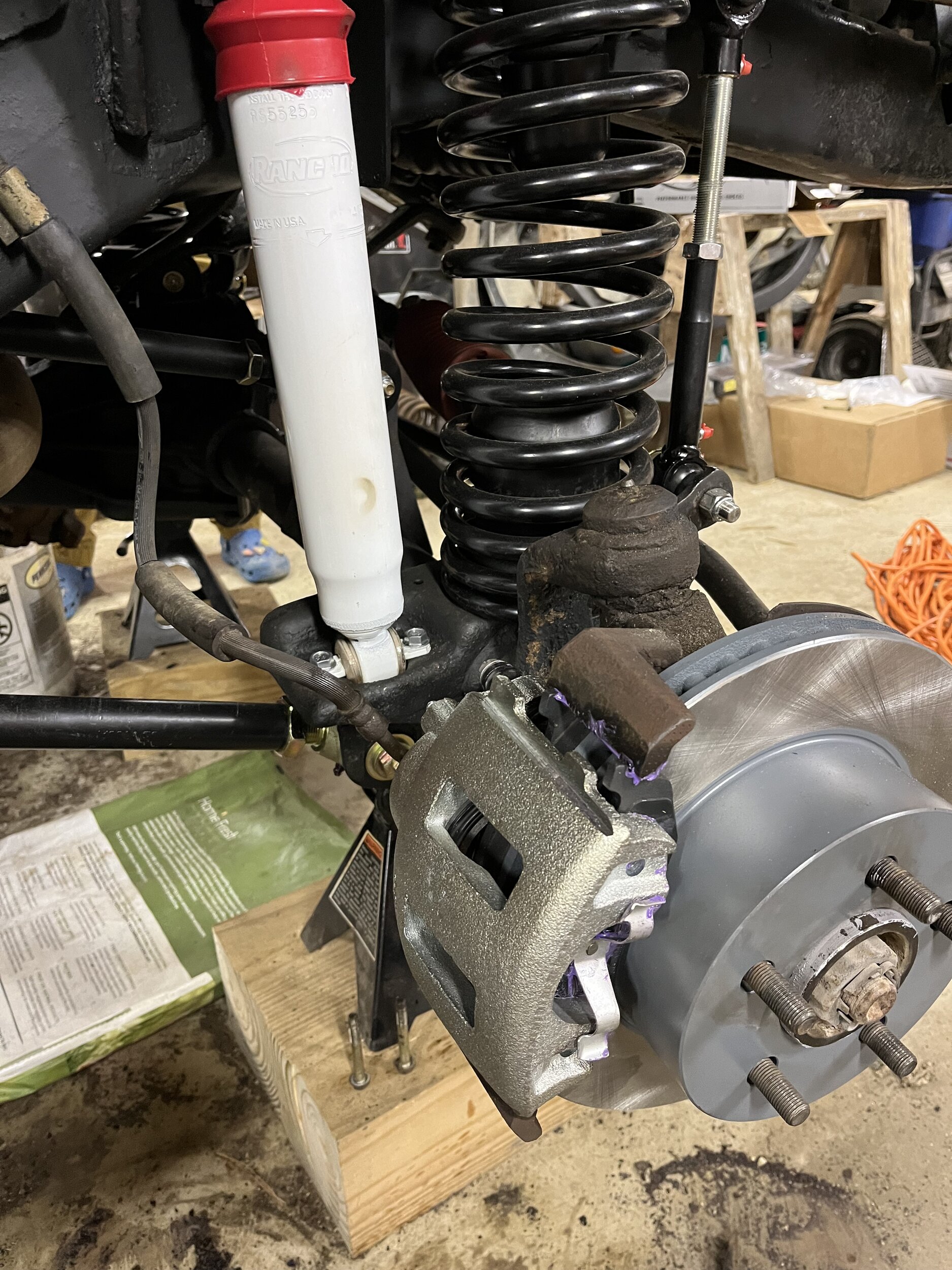

I got the new BMB calipers on, bled some old fluid out of each corner and then attached the lines to the caliper.
They look awesome and I can’t wait to break them in! I’ll do a final / proper bleed tomorrow.
On the front passenger side the little flat notch on the end of the line doesn’t quite match or reach the flat spot on the caliper. So it doesn’t keep it from spinning as I tighten the banjo bolt. I was able to set the line clocked correctly and still get it tight. But @mrblaine is this to be expected? It mates up well on the drivers side.
It is fine, just hold it where it needs to point and tighten it that way.
