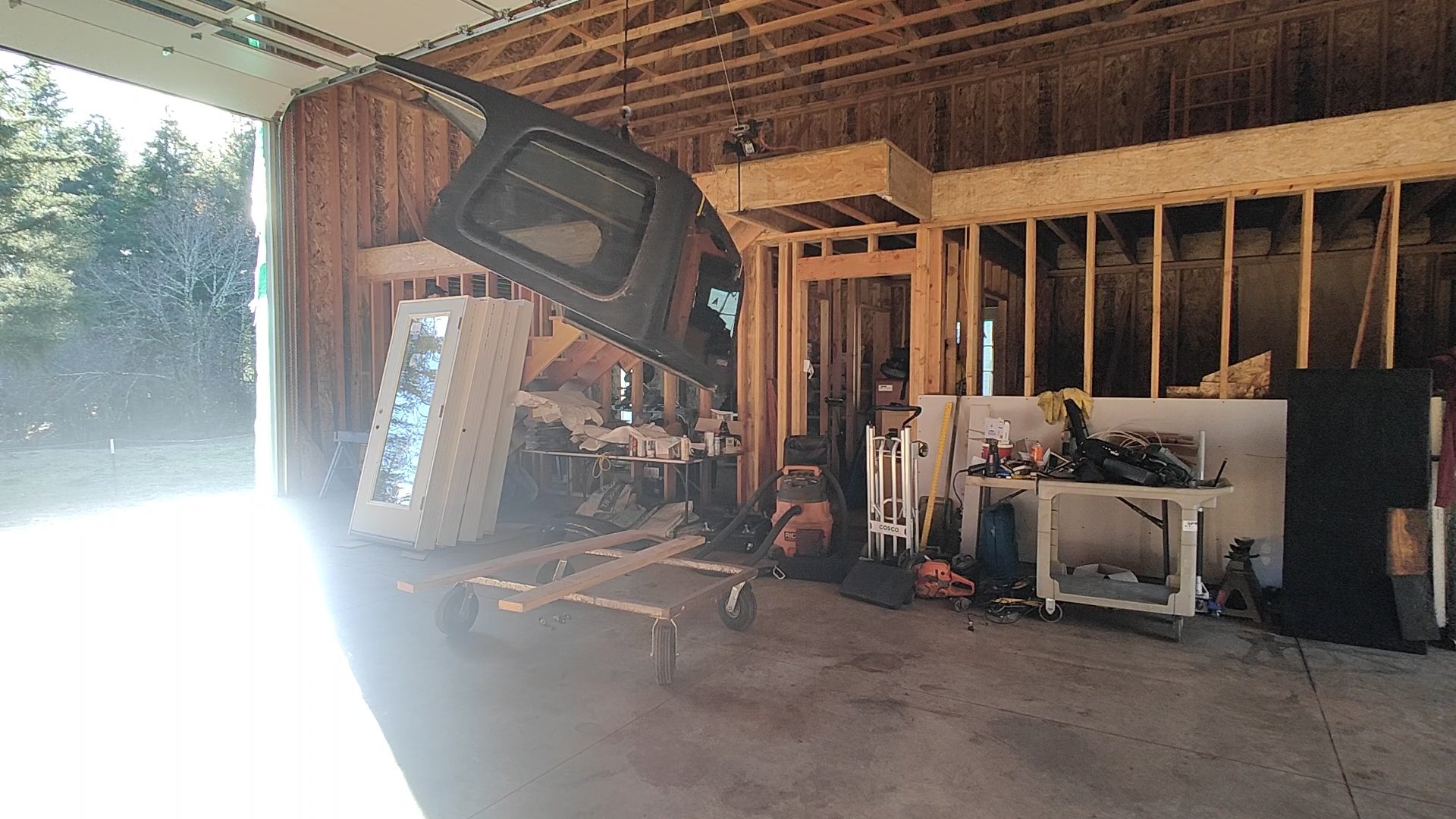

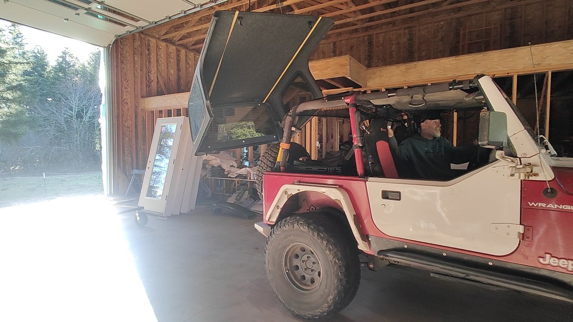

Having the ability to lift it high enough to drive under, along with that strapping technique makes it a breeze compared to what I was/am dealing with.
I have always secured the straps perpendicular to this, making it far less stable than how you do it.
At least I was able to convince the wife to swap the TJ hardtop for a "good" soft top.
We almost always ran the cheap soft top and had to store the hard top on a standing rack; simply put, it was in the way all the time.
After seeing your approach, I may reinvestigate my ceiling to see if I can find some strategic eyehook locations.
