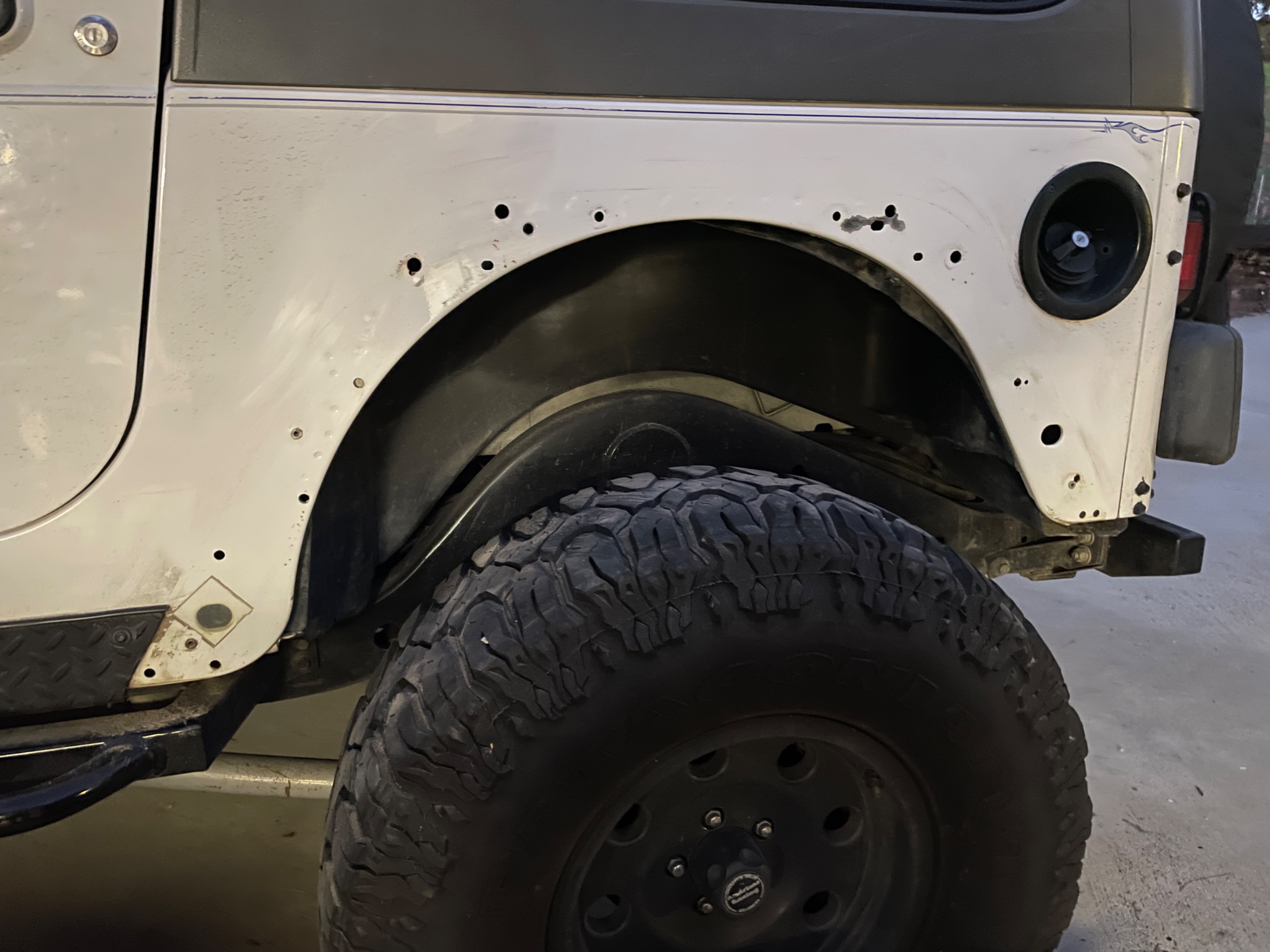

Managed to pull the tub off the frame with my dad. Not too bad. Shoutout to @DB04RedJeep for the suggestion to get the rear corner body mount off.
Accomplished pulling one rear MetalCloak flare.

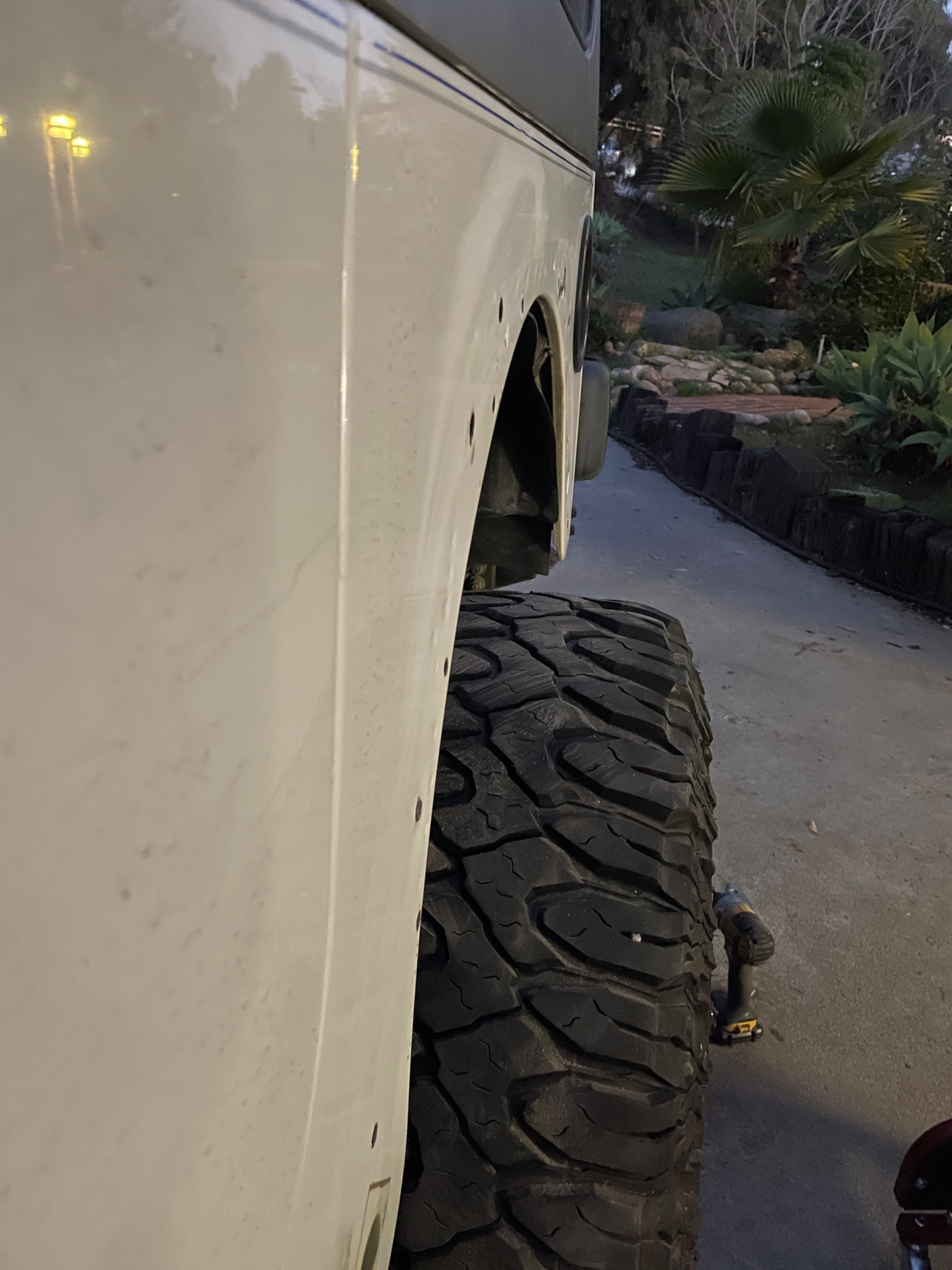

  • Found one area of mild corrosion/bubbled paint hiding behind the support panel (i was surprised since this is rust-free desert/SoCal rig) . Scuffed it and hit it with some paint match Duplicolor.

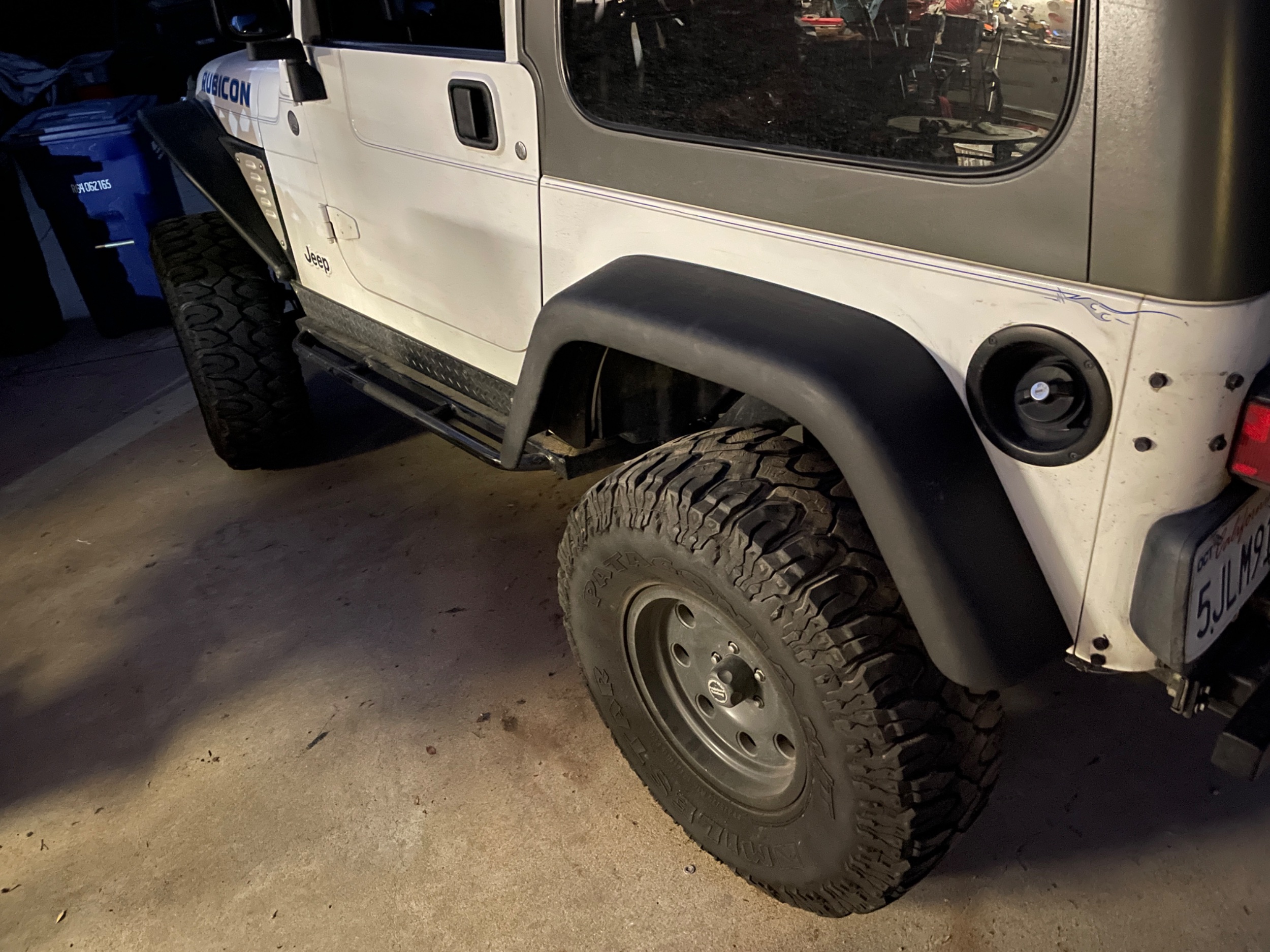

  • Gave the 6” widebody rear flare a test fit. I KNOW some folks hate the look. I don’t mind it? I think i’m used to how wide the MC fenders are (about 5-5.5” overall).
View attachment 595664View attachment 595665View attachment 595666
Did yours have a black protective layer between the tub paint and the fender? I have no idea how to get mine off
Shoot alright. I gotta figure out what is on mine, I think it’s a think adhesive of some type.
Interesting. Our set was installed by the one of the previous owners. I wonder if the “liner” was part of the original fender MC kit, that maybe was left off ours?
I have a set of the MC rear fenders waiting for the time to install, there is no rubber liner as part of the kit, it is literally just a flat piece of steel with the cups welded on to position the flares.
funny enough, i currently have the 6" widebody flares on mine, my grandfather didn't like getting mud on his pant legs when he got out so he told the shop he wanted the widest flares he could get. they do look right with 2" wheel spacers, JLR wheels and 285s though
The MC rear flares do mount up nice. I didn't see a need to put anything between the MC mount and the tub. I did paint the area with Rust Reformer and regular paint after drilling the holes before putting the mounts on though.

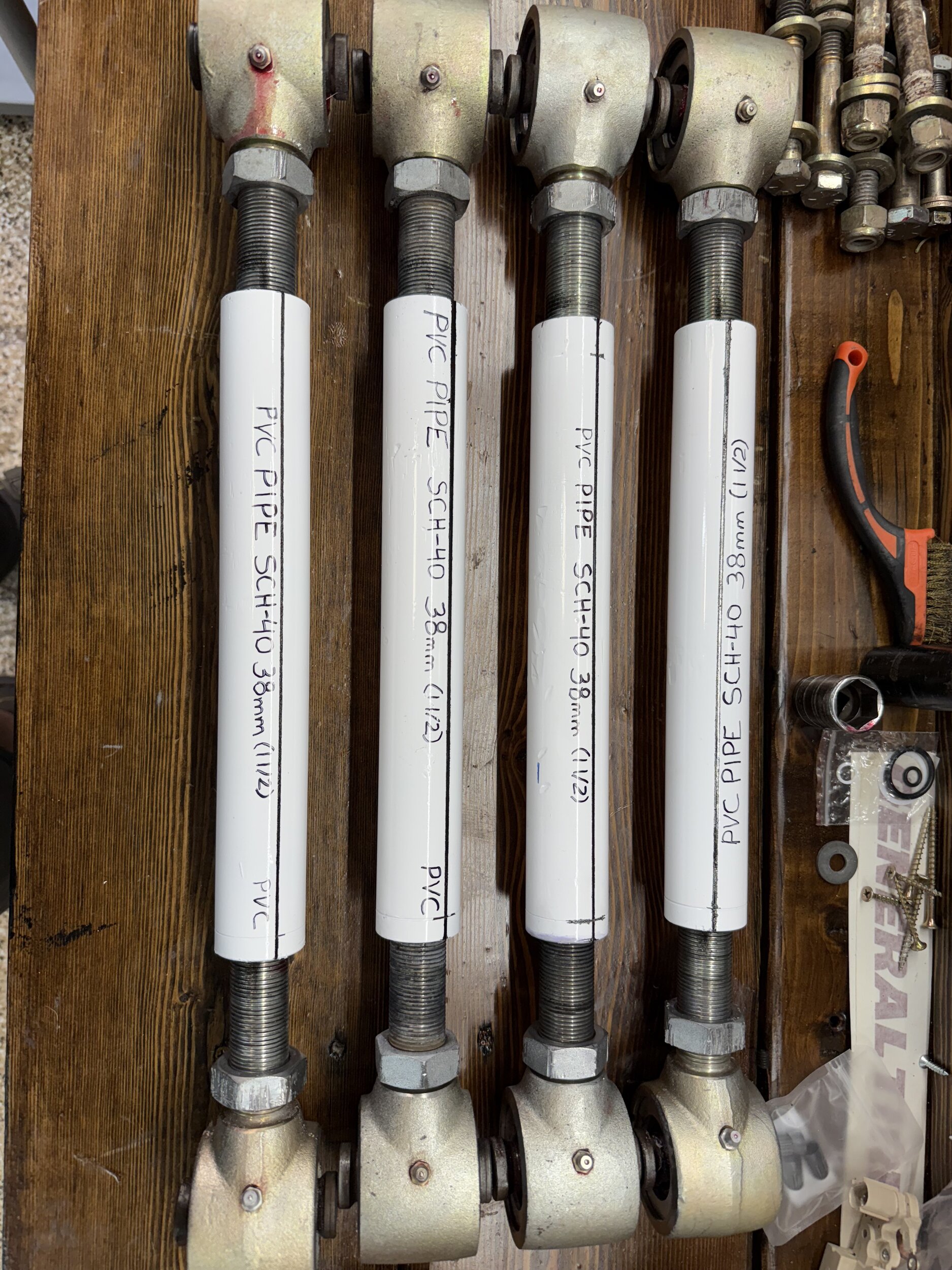

Figured it was time beef up the suspension with something light weight and ready to handle the rocks. No more light weight aluminum if I am gonna be running 40s. This is easy to replace when it’s chewed up and cheap on the pocket book 😬
If it isn't seamless it isn't strong 😆. I'd recommend schedule 80 seamless. (Joking)
We use schedule 80 seamless at work for HPCO2 and Vortex systems that have 2400-2800 PSI of discharge pressure.
You could carry loads of spares for you and your buddy’s with no weight issues too!
Better wrap it all with electrical tape
