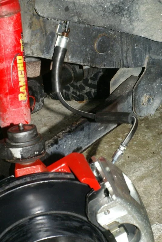

Got the front brakes finished up - new softlines connected, brakes bled.

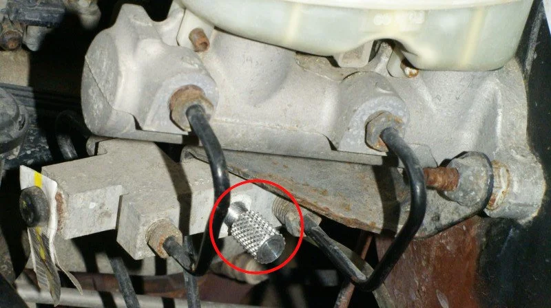

I'm not sure if I need to use this BMB lockout tool for vacuum bleeding, so I did anyway! Besides, I also had to "pump up" the brakes to get the new caliper cylinders positioned.

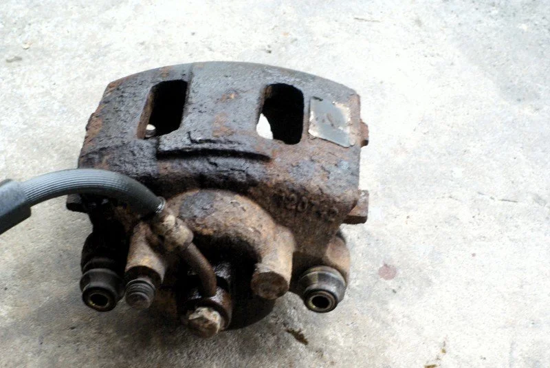

One of the old ones - which actually looks a lot better than it did as much of the loose rust has fallen off of it from handling.

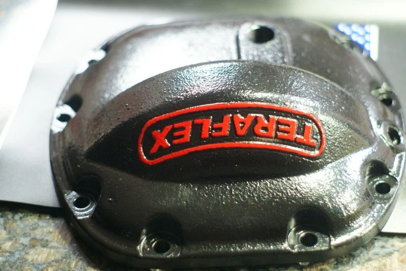

So - left to do: Re-install the freshly repainted diff cover, fill with oil, and then the new steering assembly (ZJ upgrade). Then - ASS-U-ME-ing I didn't fuck anything up on this job, I'll be able to take her out and test things. If that passes, then it goes to the alignment shop - I have lifetime free alignments from my local Firestone outfit.
