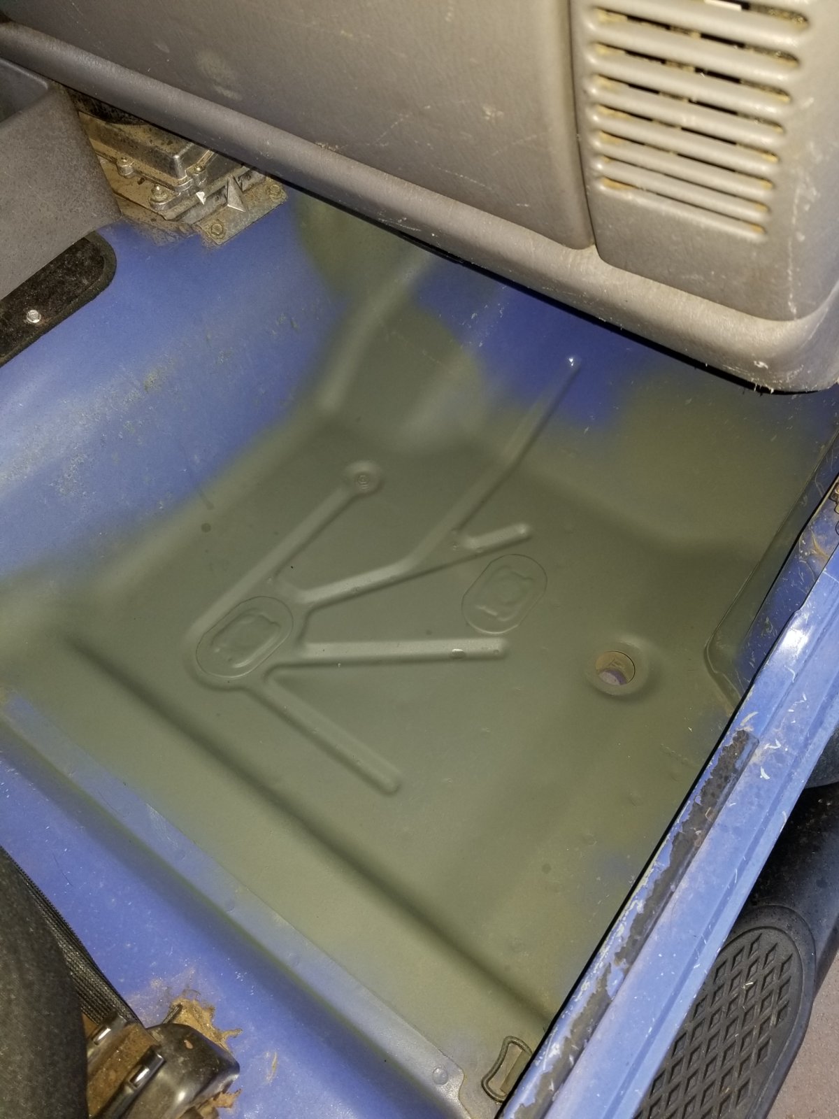

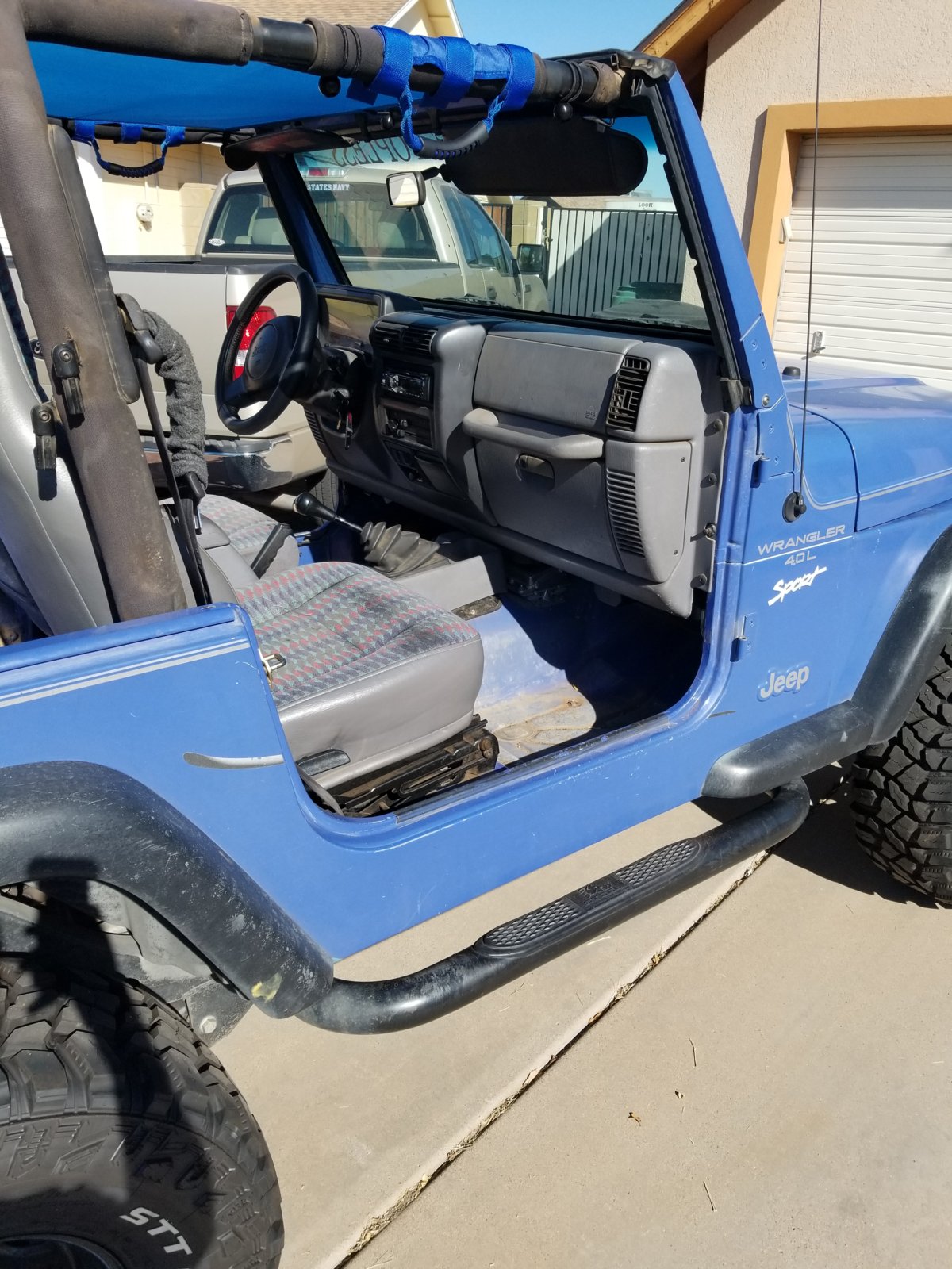

Stripped the jeeps carpet abd cleaned up the floors for new bed tred. Found a tiny bit of surface rust on the passenger floorboard. Looked like from a leaking heater core. PO must have replaced it. It doesn't leak now. Sanded and primed the floorboard. Now waiting until the morning to install the carpet.

Awesome discipline to fix that before proceeding with the install!
Remove the seats for the install. Instructions say you don’t need to, but the time it takes to remove them will save you a lot of time and frustration trying to bend and fit the material with the seats still in.
I will do that. Thank you for the heads up.
Reactions: jchadscud
One other tip, if you put some clips on the bottom of the rear sections that go over the wheel wells, that piece will sit flat against the bottom of the tub and make the piece that goes over the cargo area easier to lay in.
The end is scored, but takes some work to get it to bend at 90 degrees so it lays flat.

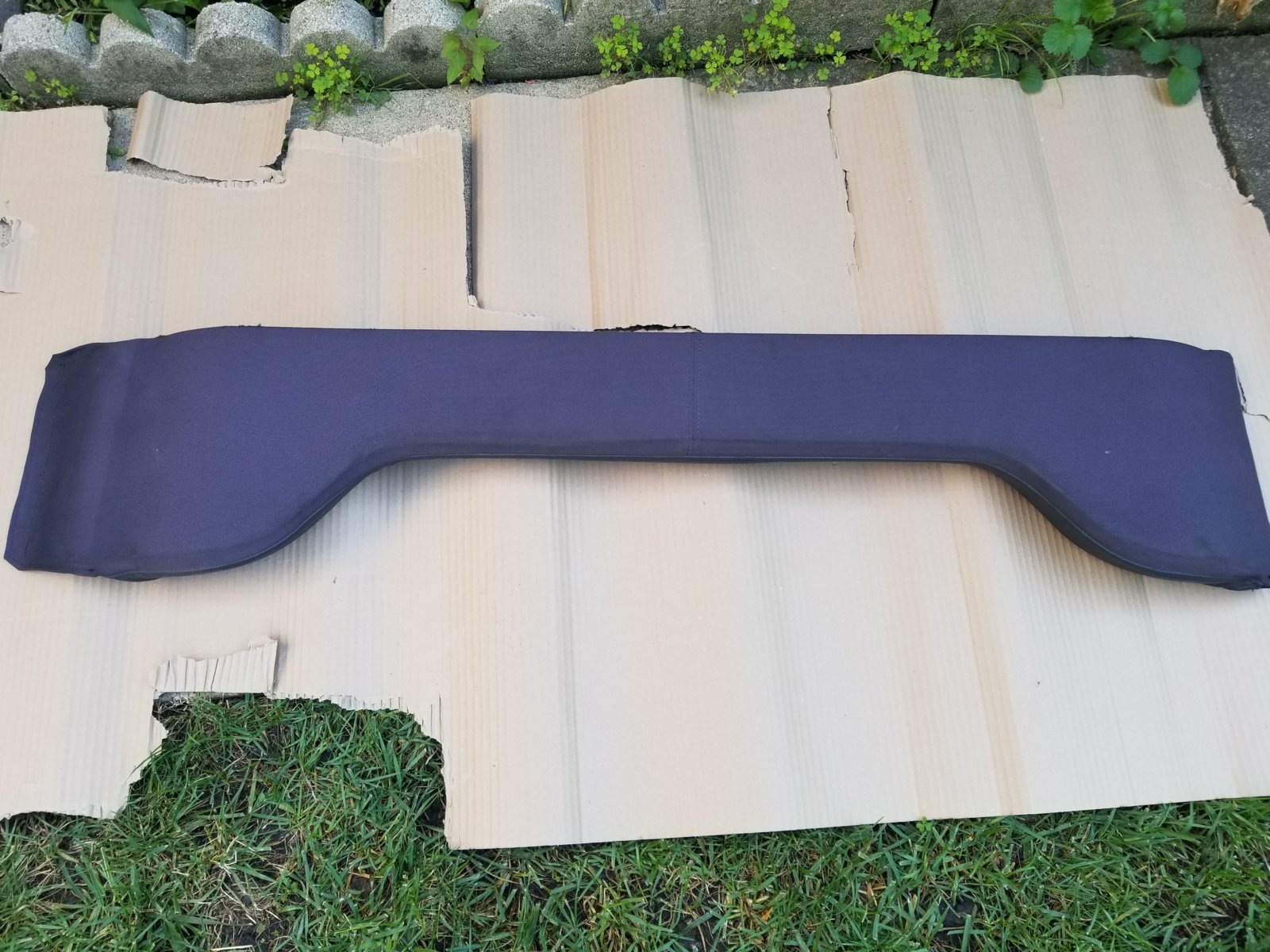

Picked up vinyl paint from the local hardware store which can also be used on fabrics and decided to paint the roll bar padding fabric. Mine were all faded and now it looks much better. 1 can got the job done.
View attachment 55187 View attachment 55180 View attachment 55181 View attachment 55179 View attachment 55178 View attachment 55186
That turned out good! I was thinking of washing mine. Curious if you tried that? I might wash and then paint if it doesn’t freshen up the black
