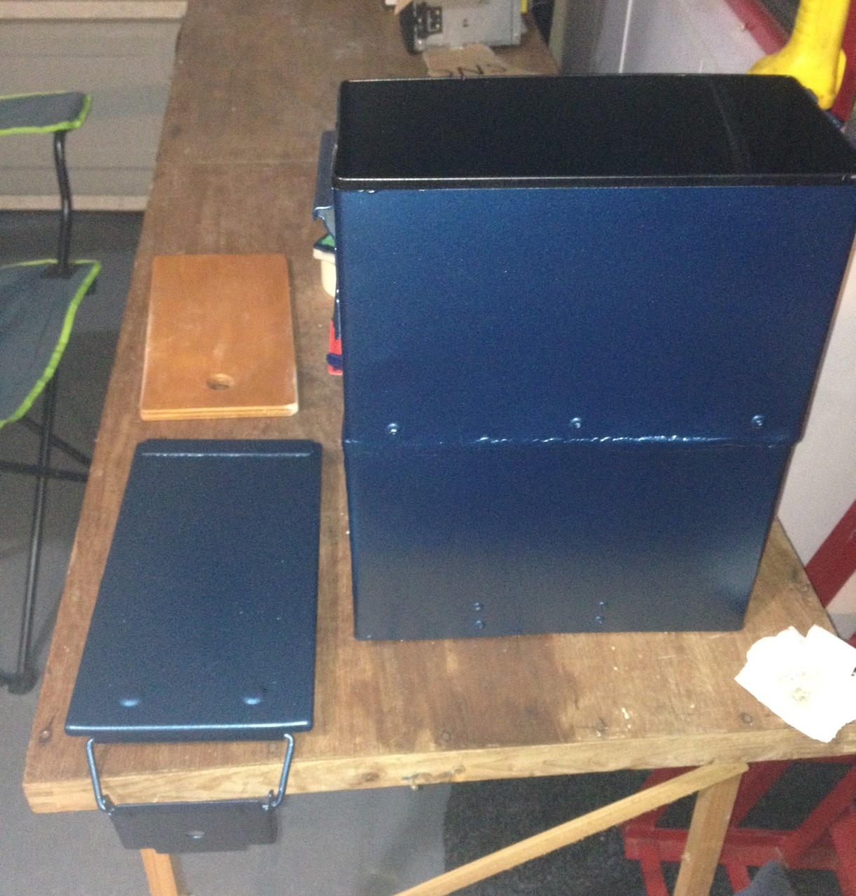

Ammo box update...I was going to install it tonight but the paint hasn't hardened enough just yet...Here it is painted anyway...The wooden piece is for the floor inside the box

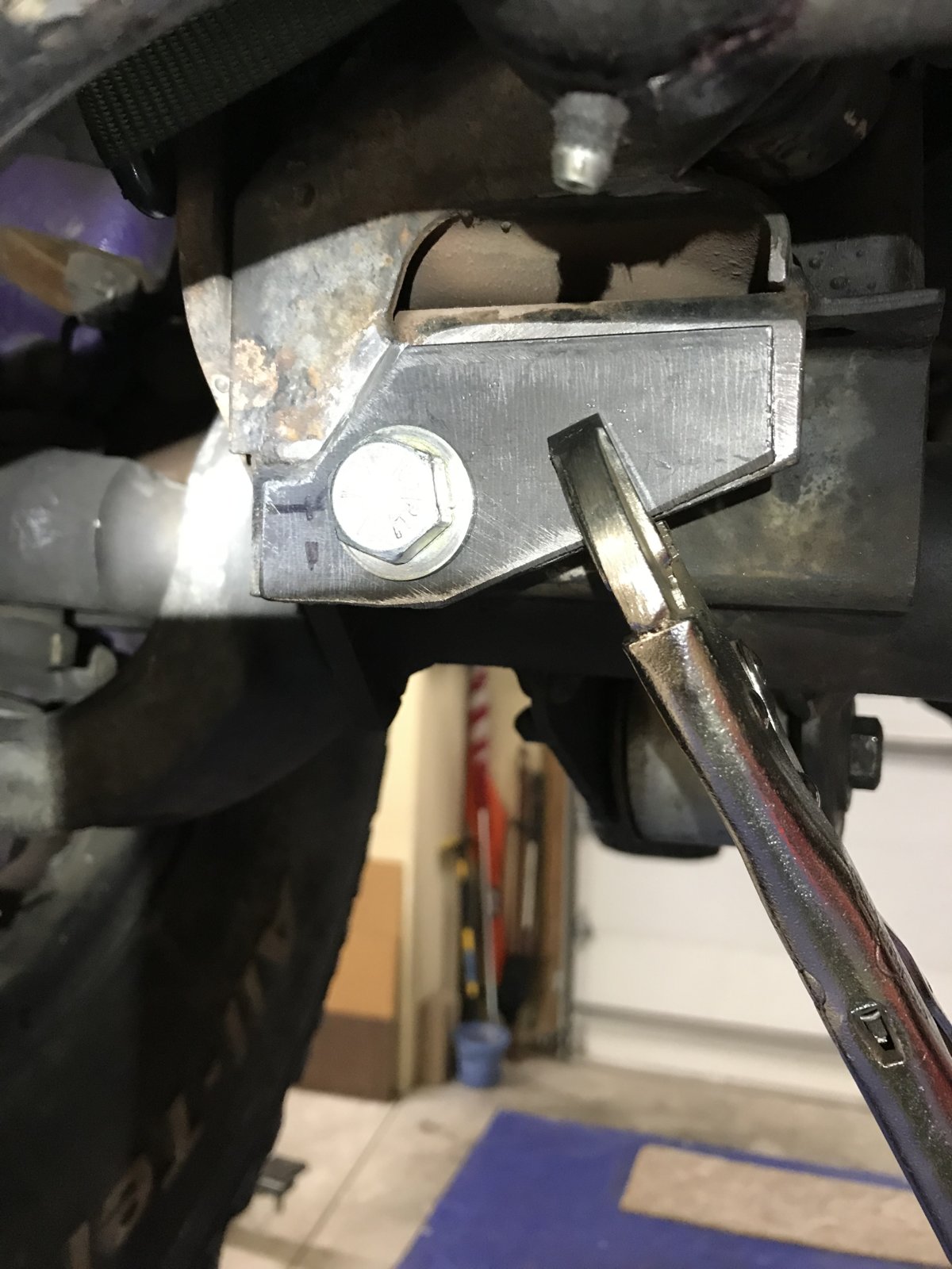

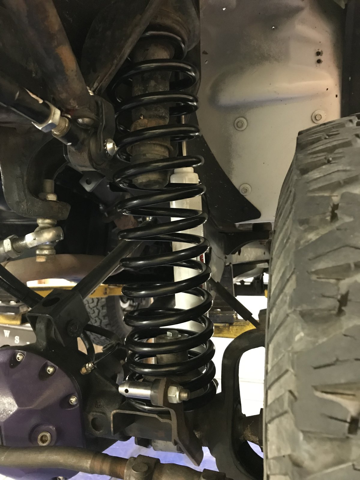

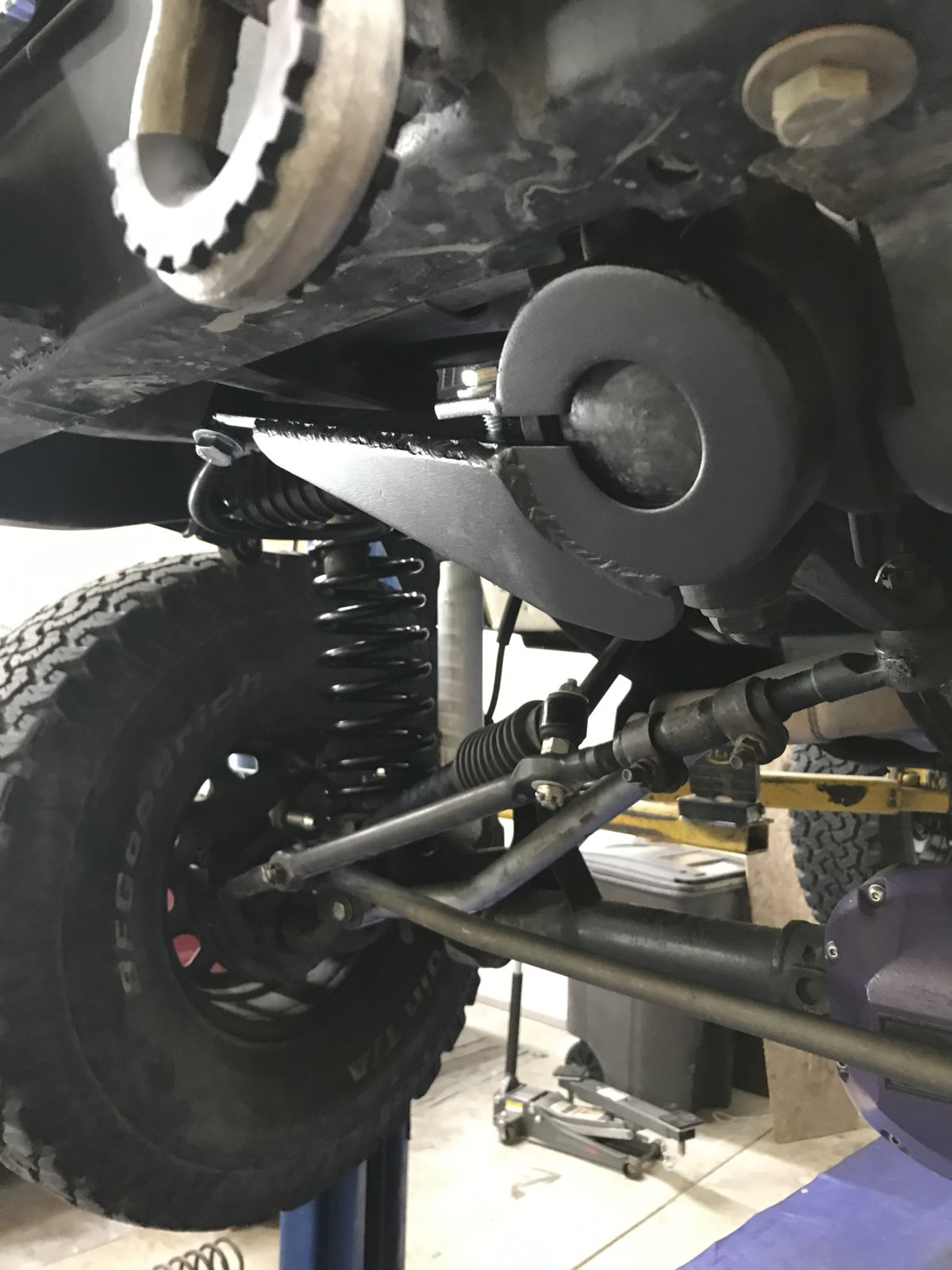

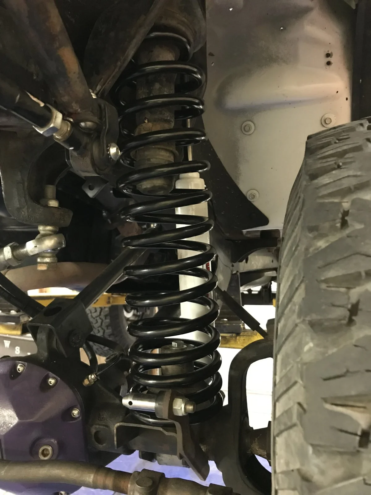

What a weekend! It started out with new spark plugs and wires and ended with new Currie 4" lift springs and Rancho 5000X shocks. After installing the lift I had to make a reinforcement bracket for the trackbar that the hole egged out! No more Death Wobble! I would show you the welding picture, but it was quite ugly. Something a flapper disk with a 36 grit wheel took care of. :ROFLMAO: I also put a Tomken power steering box stabilizer on.
View attachment 84333View attachment 84337View attachment 84335

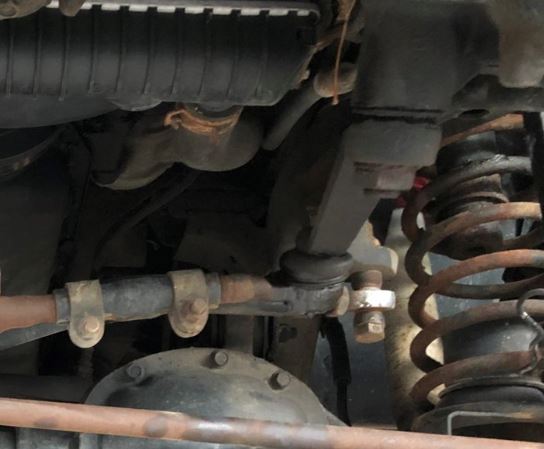

What Rancho's (Part Numbers) did you use for the 4" lift? Is that a dropped Pitman Arm? If so, replace it with the stock arm, or you will be heading down bump-steer lane.
Awesome, thank you. The picture makes that arm look a mile long and low, LOL!
I think what you are seeing is the Tomken steering box stabilizer that goes on the front to of the steering box and ties to the frame support under the radiator. I see what you mean. I looked at the picture again and the pitman does look long. As far as I know it is a stock one, but the PO did some interesting things. I haven't had any bump steer issues.
Reactions: Mikester86

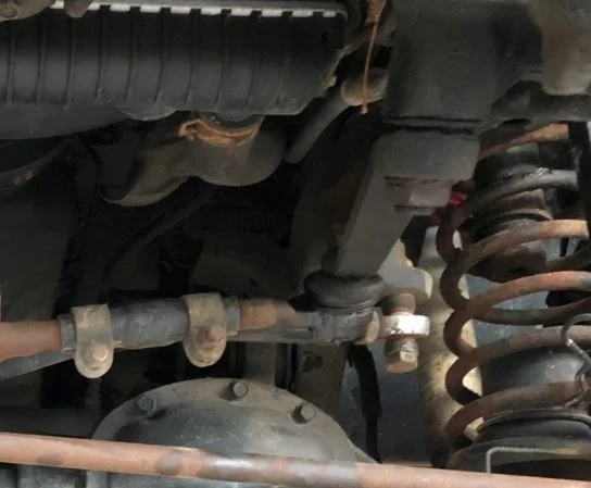

In your picture, It kind of resembles the dropped one I had replaced on my TJ. But pics can be deceiving.
