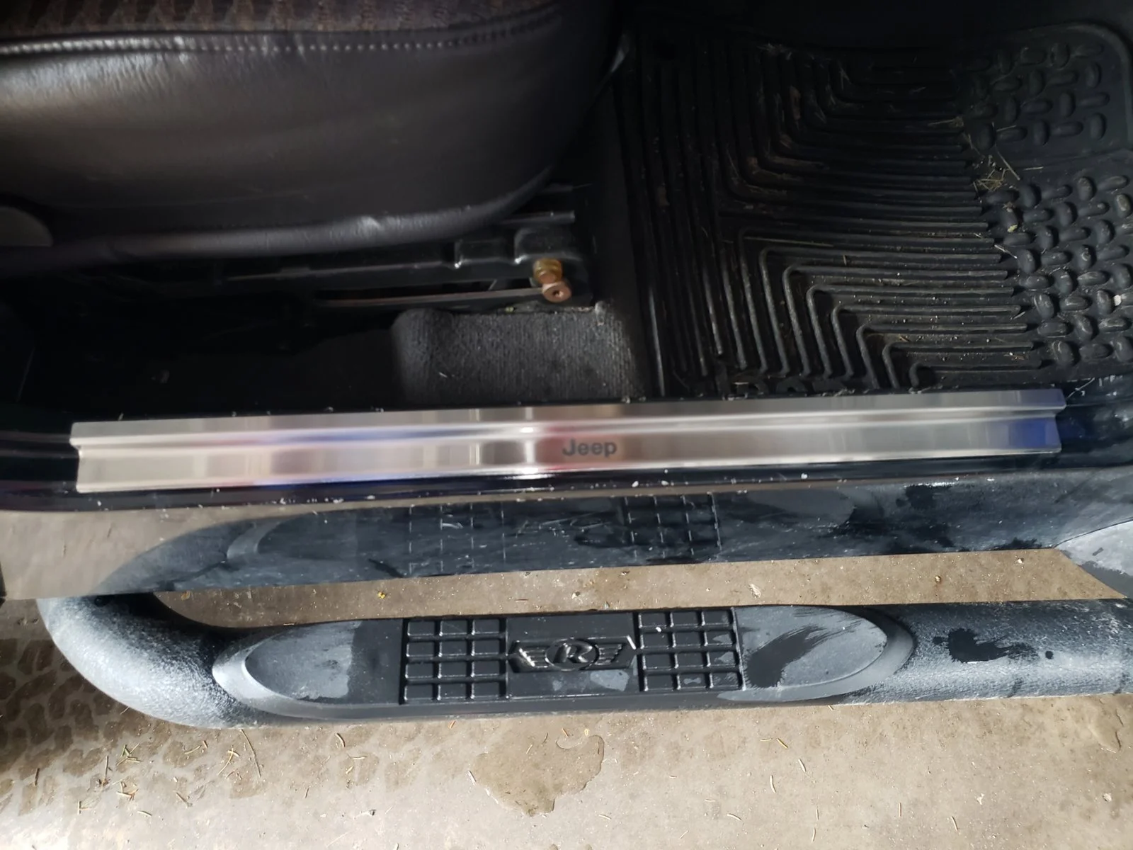

I put chrome headlight bezels in to replace the black one's, courtesy of @MangoTango & put a pair of door sill guards on, also to replace the black one's.

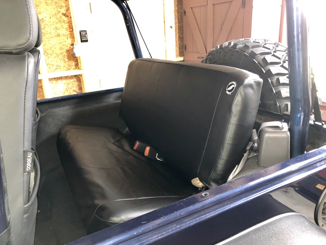

Changed the rear seat from tan to black with a seat cover from Corbeau (to match the front black sport seats) and reinstalled all the hardware and seat belts.
I had taken everything out when I did the Bed Tred install and liked it without a rear seat as a daily driver. Now that it’s not a daily, wanted the seat back for additional passengers.

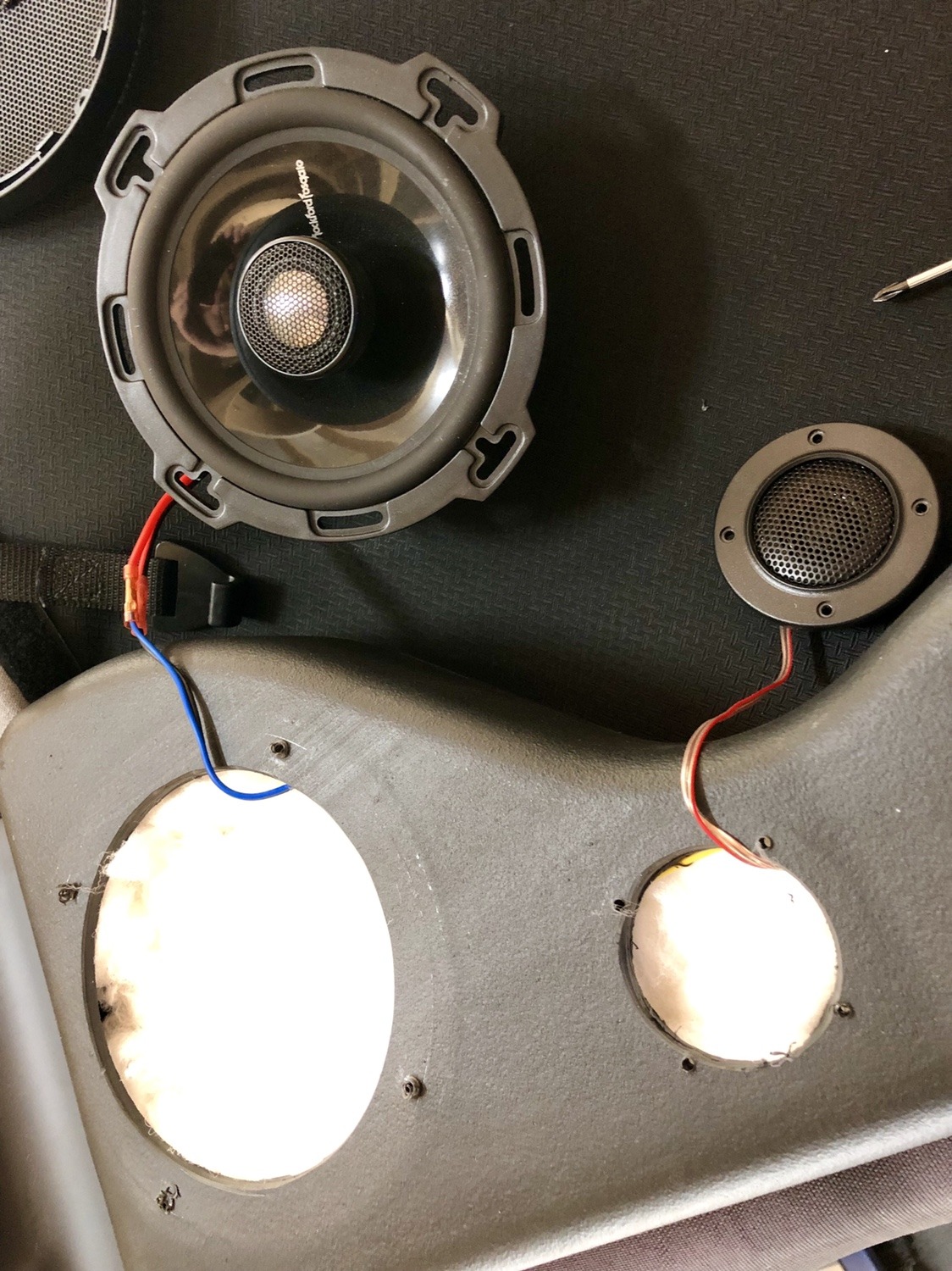

Also added Poly Fil to the sound bar. I bought a VDP sound bar awhile back without doing any research to learn that they are junk. I’ve replaced all of the speakers and determined that it’s a 194 LED bulb that’s needed to replace the barely illuminated bulbs it came with. The Poly Fil made a big difference in sound. Also added Boom Mat to both front 4x6’s (no picture).
Boom mat:
Design Engineering 050350 Boom Mat Speaker Baffles, 4" x 6" Oval (Pack of 2) https://www.amazon.com/dp/B0039Z3SUM/?tag=wranglerorg-20
Poly Fil (1lb bag is enough for 1 Sound Bar):
Acousta-Stuf Polyfill Speaker Cabinet Sound Damping Material 1 lb. Bag https://www.amazon.com/dp/B0002ZPLDY/?tag=wranglerorg-20
The separates you have installed? Did you modify that sound bar to make the tweet fit? How’s it sound and are you running an amp and sub as well?

The VDP (Vertically Driven Products I think) soundbar came with the mid’s and high’s installed. They were junk and I swapped them out with some Rockford Fosgate one’s.
No amp and sub, just a Sony headunit, but I have an Alpine head unit and power pack on the way.
It’s a clean sound with some bass, but not much. It could use a small sub to balance it out for sure.

Good to know. I have a kenwood unit and poineer 5.25 that were donated from other members here a couple years back. They are well over stock. I’m sure some poly fil and aftermarket up front would make a world of difference for me

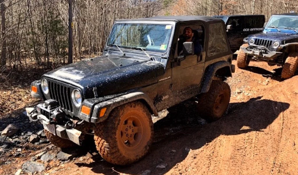

Re-spooled my winch line and did a general check over of the Jeep after a Rausch Creek run yesterday. My 4 banger handles the black trails very well. Totally amazed at how capable this thing really is. Here is a vanity pic:

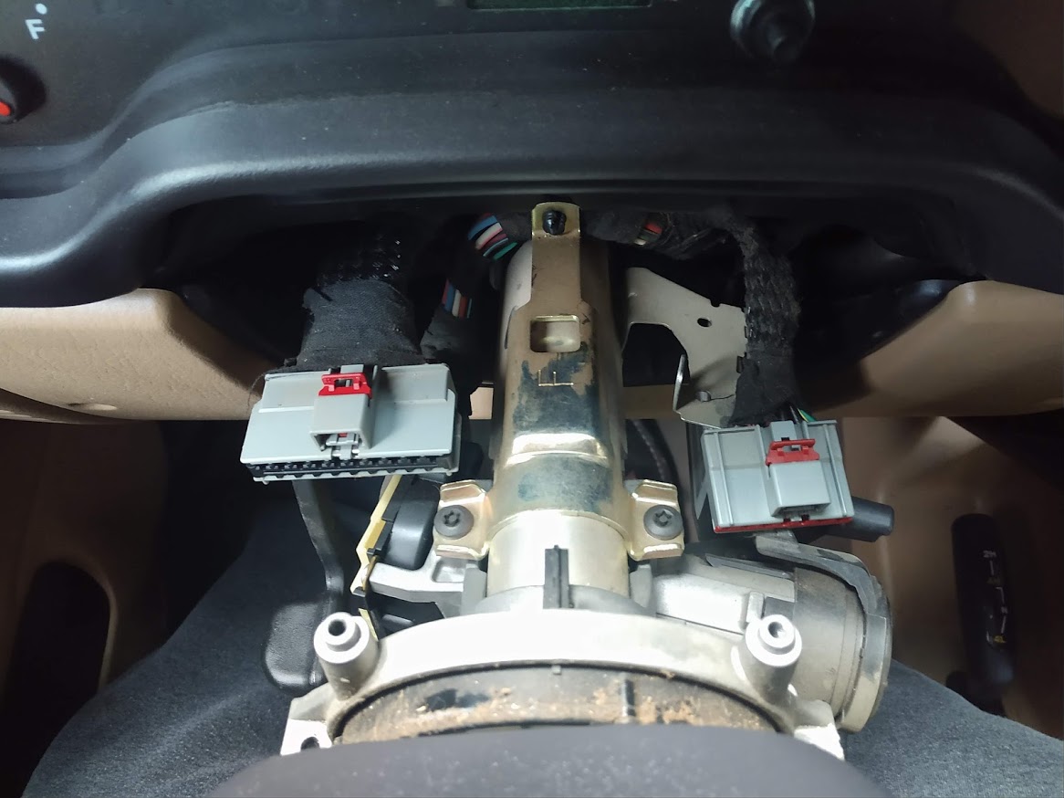

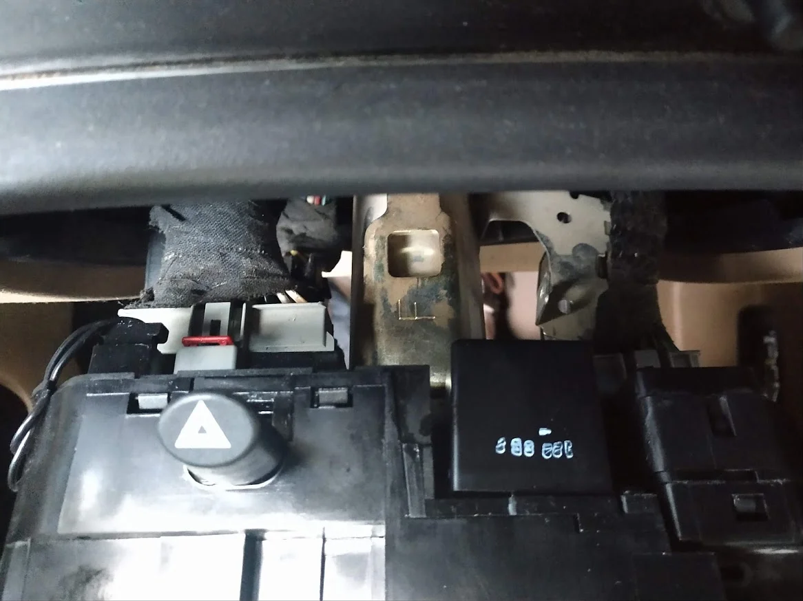

noticed I was having issues with occasionally slow starts. Came out last week and found my fog lights on. I did some investigating and found my Multi-function Turn Signal Switch, if breathed on, would turn the fog lights.
So, got it ordered and it arrived today, and I got it swapped out. and since I had it open I swapped out the blinker module with an LED one
working on my '02 was a LOT easier then my son's '99
