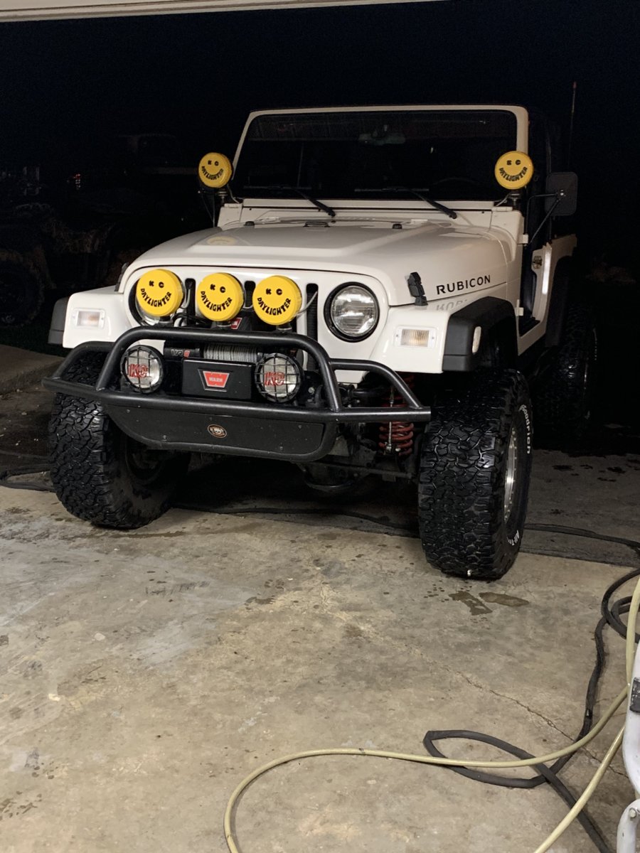

After a lot of back and forth, I made the plunge and upgraded the stock front bumper. Going to black out the EAG.
Edit: the EAG logo actually can be screwed off which is nice lol

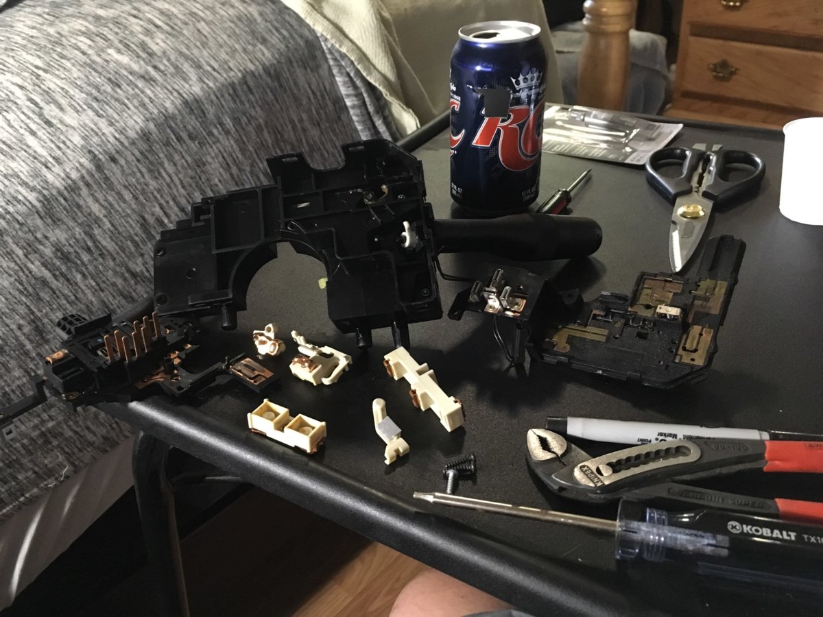

Fixed my foglights which had become demonically possessed with a life of their own by pulling the multifunction switch, taking it apart and building up the worn area on the foglight switch "finger". There's a couple of good write ups here in the How To section on this.
Nothing like using a piece of aluminum out of the side of a soda can to save a couple of hundred bucks or playing the chinese parts roulette. That and I got a free education on how the MFS works while sorting out the pieces.
It was hotter than hell out in the shop, so I set up at my computer desk in the bed room where it's air conditioned. That way I could refer to the How To pics write up pics as needed.View attachment 102219
I'm dealing with the same issue with my switch. Likes to turn it self on every so often. Good to hear there fixable. I'll have to start looking into that repair.

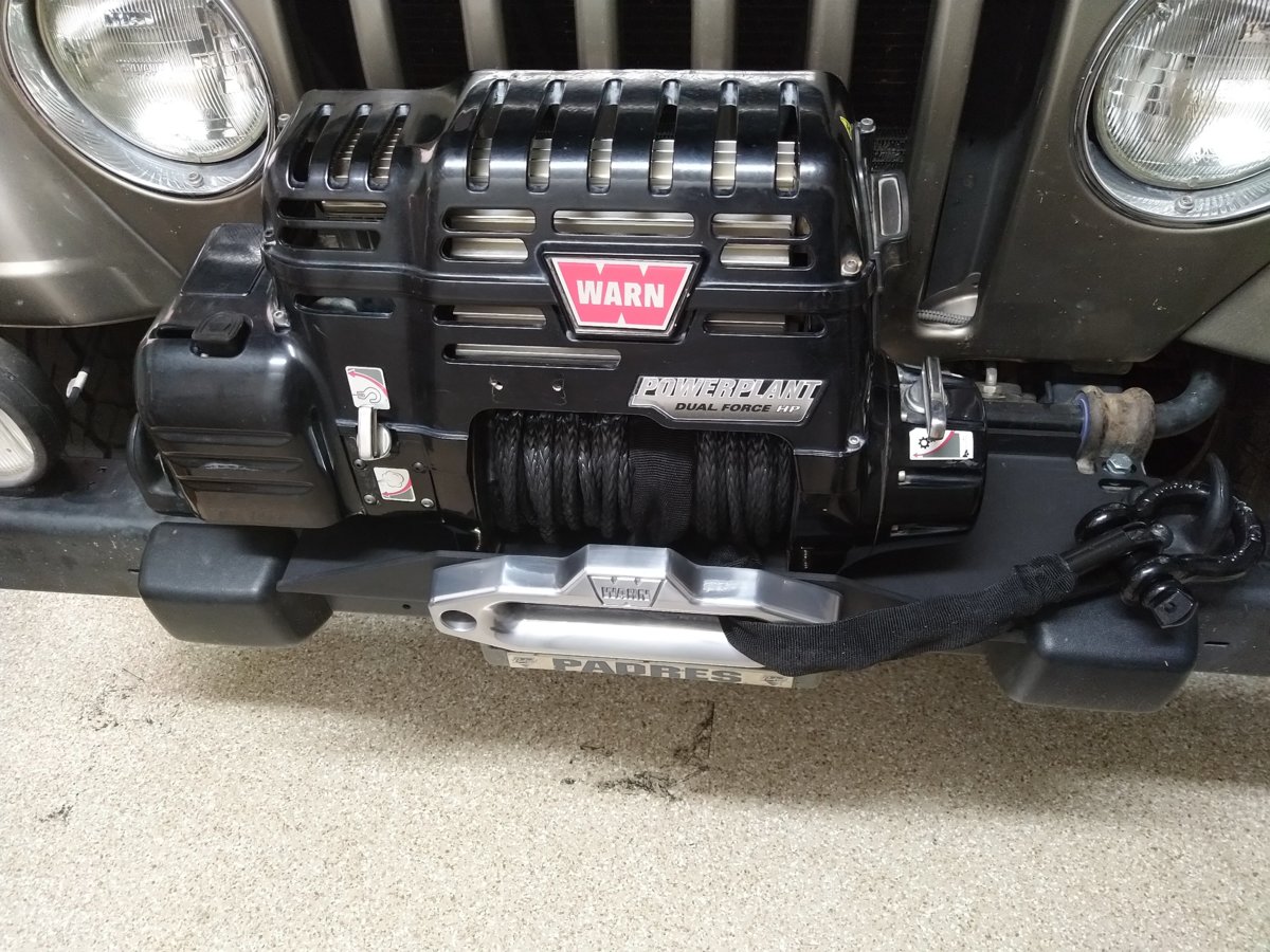

Also finished installing a used winch with on-board air. I have a feeling the air compressor is going to get a lot more use than the winch.
102664
