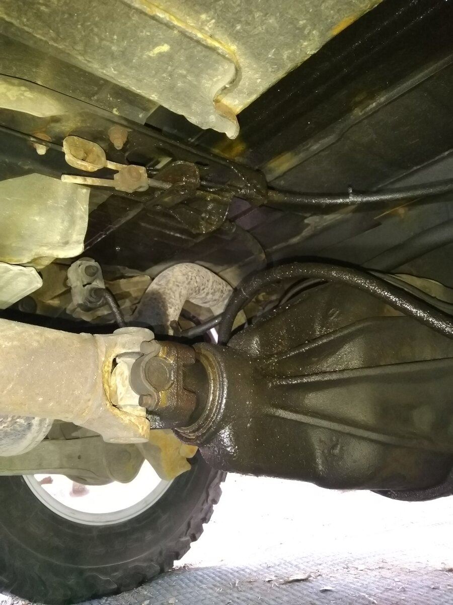

I think my pinion seal might be leaking:unsure:😬

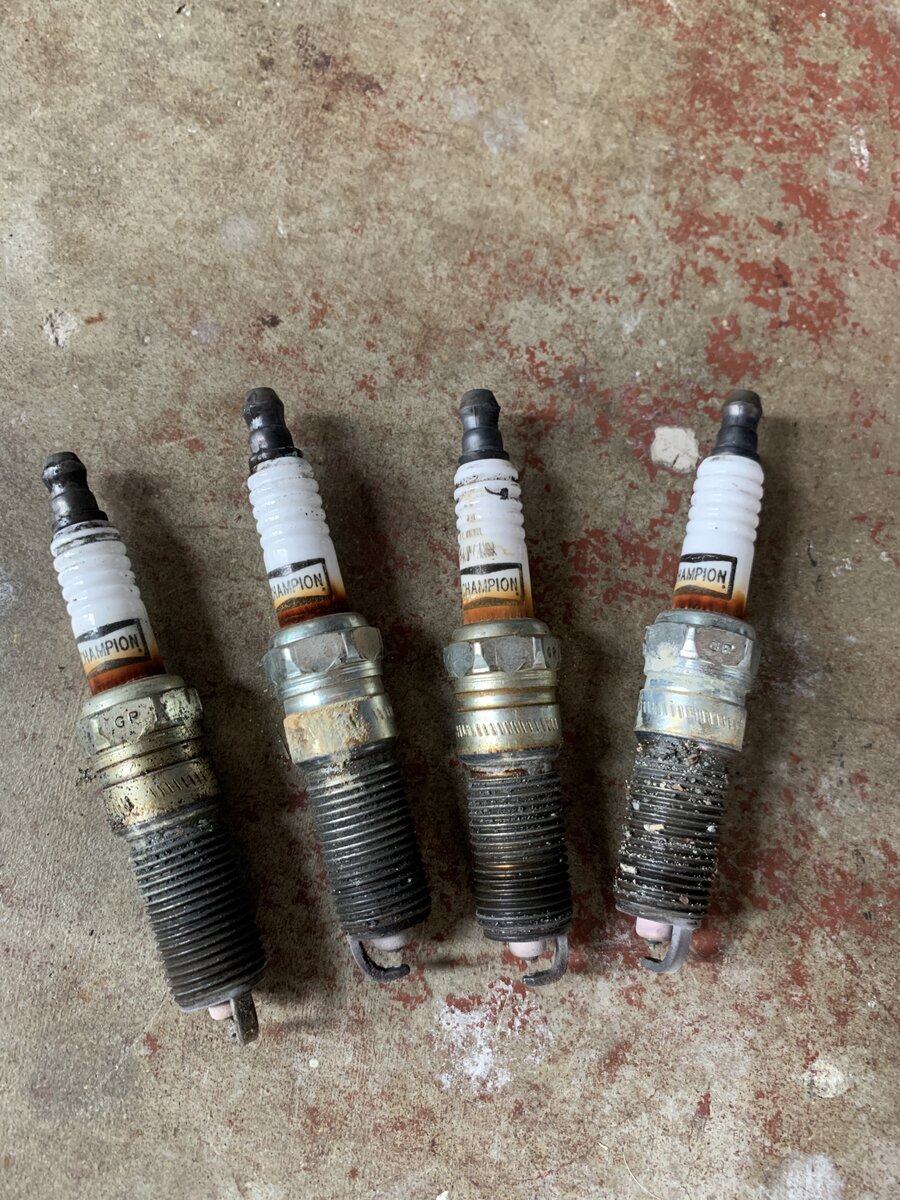

I had a very similar experience with champion plugs that came in a "tune up kit". Was chasing the problem with TBS, O2 sensors, ICV, CPS, you name it I replaced it until finally swapped the plugs to NGK and problem gone! Great feeling, glad you fixed it as well.
That is the EXACT plug that I pulled today and replaced with NGK, though I hadn’t been throwing codes, just tuning up. This is what the old plugs looked like....
I hate to think of all the issues they have caused. I try and post this as much I can in hopes it helps someone.
If you have surging idle, bouncing throttle, cutting out and misfiring. This may help you.
The fix turned out to be be poor quality/incorrect spark plugs. I used champion plugs RC12ECC sold in the Quadratec 00 - 06 tune up pack. I would like to now issue a public service announcement do NOT use the plugs in the service pack.

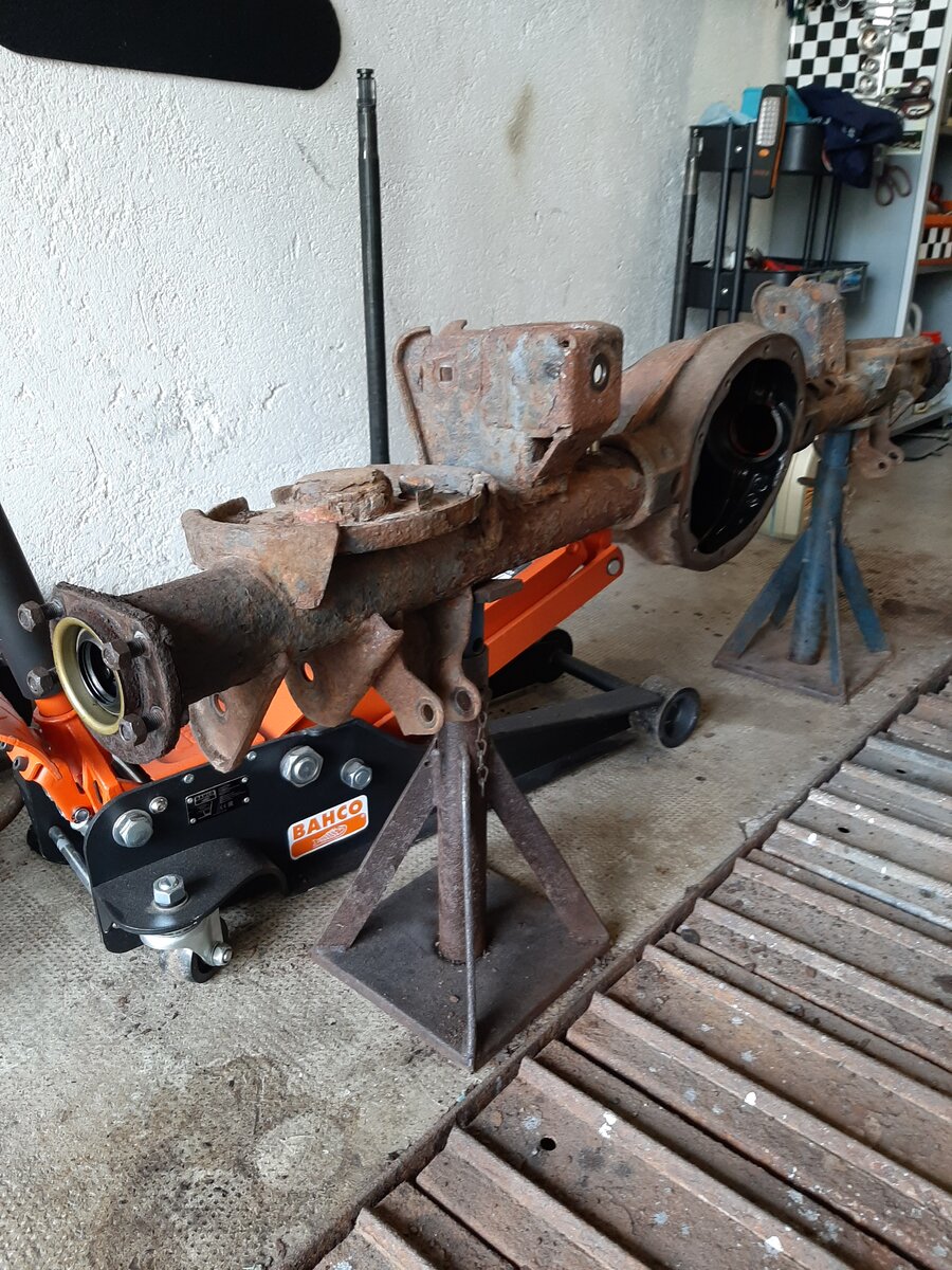

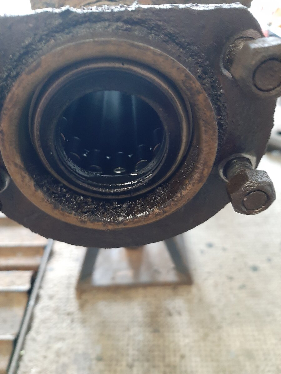

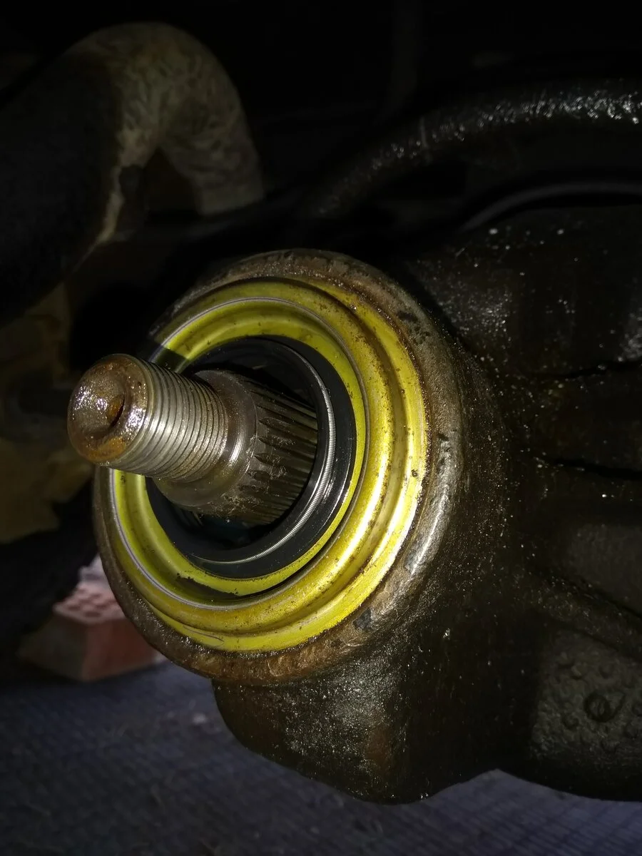

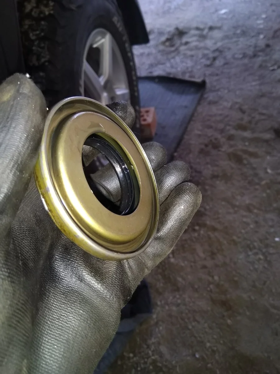

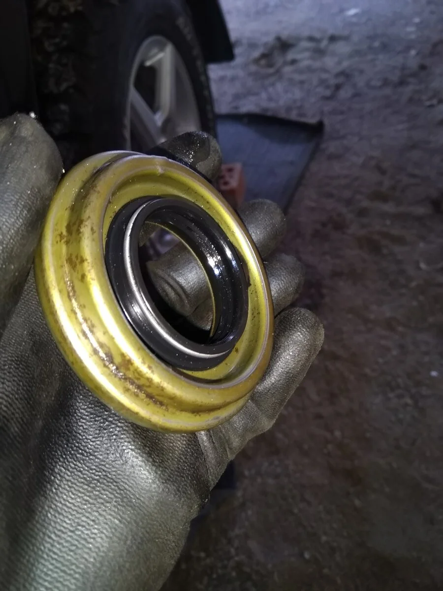

was actually yesterday, have pretty much dismantled all of the rear axle.
and found that the outer oil seal is leaking, although I installed it two years ago. can it be that the thru axles are to blame?
What the hell did that thing come from, a dump truck!?
That's not going under your Jeep, is it? Are you planning to run 60" tires? :ROFLMAO:
Reactions: Tob and Hunter Rich
Hello Chris,
this is the original rear axle from my TJ. 60 '' tire? my 2.5 would not have enough power
For some reason it just looks bigger on my screen, haha!
You're right about your 2.5 not having enough power for a 60" tire though!
Reactions: Jpodell and matkal
