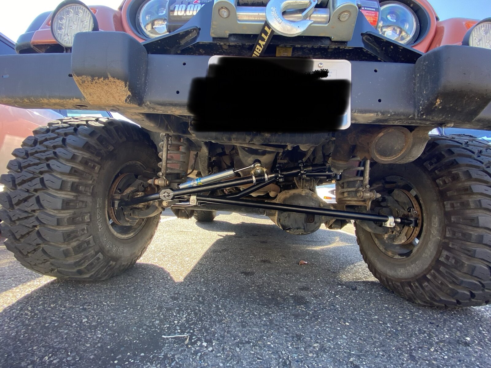

Had the Currie adjustable track bar installed. The axle side mount was wallowed out so I figured there would be welding required for repair. Turns out when they drilled out the mount for the larger bolt it didn’t need repair. It hadn’t ovaled out past 1/2”. While they were down there I had them install the currectlync drag link and track bar with a new bilstein steering stabilizer and align it. No more death wobble and it handles like a new car, sort of... also installed the steering box skid after this pic was taken
Good steering components are essential with big tires..at least eventually, in my book.
It's not that stock components are bad, they are just designed for smaller tires and less stress.

Had the Currie adjustable track bar installed. The axle side mount was wallowed out so I figured there would be welding required for repair (I’m no good at welding). Turns out when they drilled out the mount for the larger bolt it didn’t need repair. It hadn’t ovaled out past 1/2”. While they were down there I had them install the currectlync drag link and track bar with a new bilstein steering stabilizer and align it. Sucks to pay someone else to work on it, but it’s nice to not have to worry about it. No more death wobble and it handles like a new car, sort of... also installed the steering box skid after this pic was taken

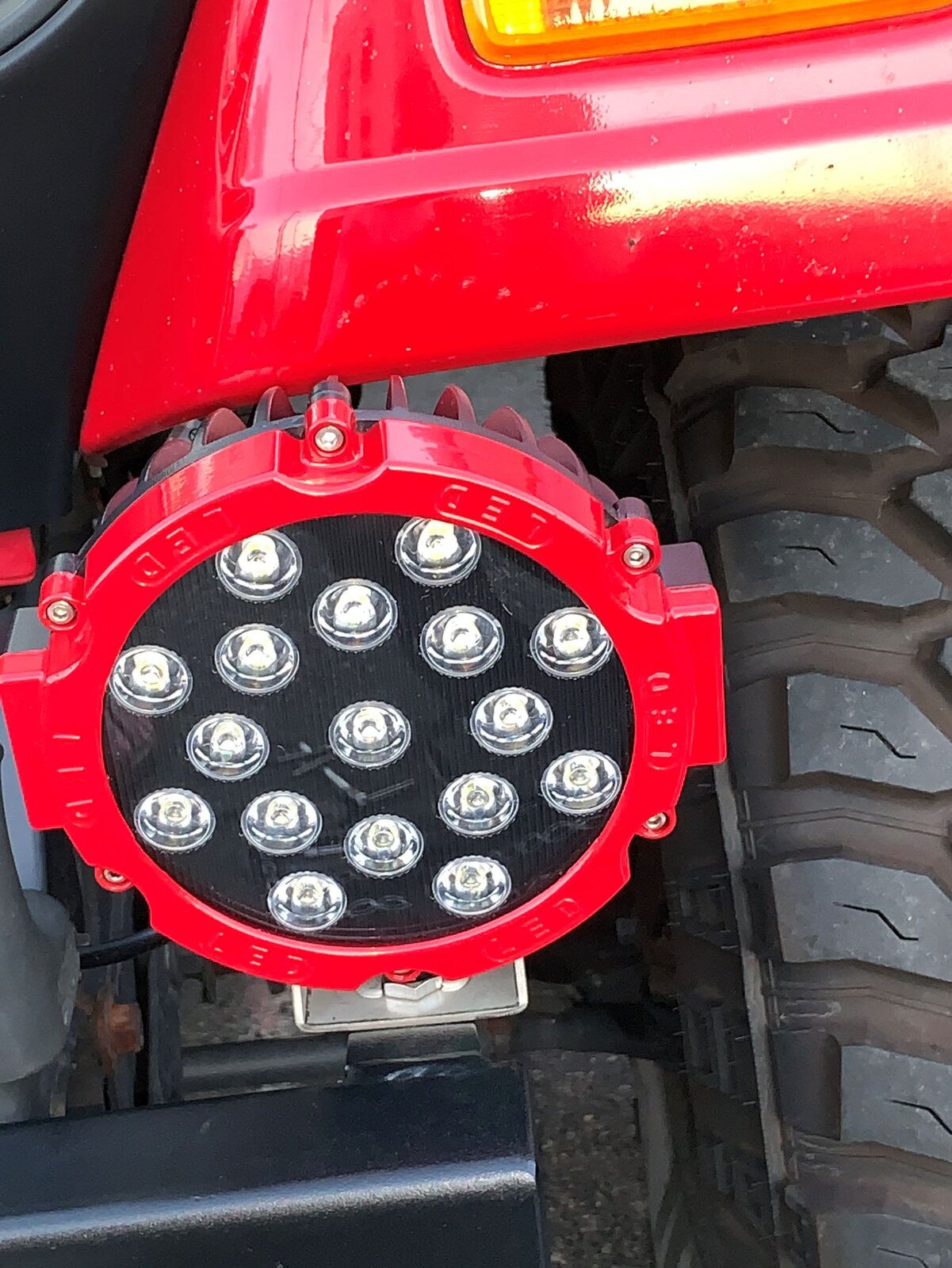

Removed the factory fogs and installed some 7" LED lights. What a difference! I can drive without headlights now. :unsure: Took it out after it got dark and the driving lights are MUCH brighter than the headlight high beams. I made sure I angled them down enough so I wouldn't blind anyone. $42 well spent IMO. My new DOT Osram LED headlights ($50) should be here Monday.
