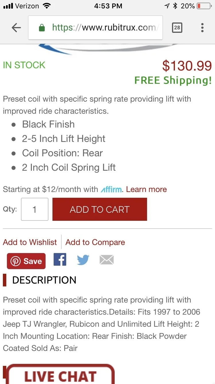

Why does it say 2-5 inches?
That is likely a general comment for this product line. For the one you are looking at, it specifies the 2" lift height in the description at the bottom.

Ok, I will probably still net a little more than 2 inches though, right?

Because no one knows how much your Jeep weighs except for you, potentially. See that line where it says preset coil with specific spring rate?
My recollection is that BDS coils are 200lbs/in at a linear rate. Meaning that it takes 200 lbs to compress that single spring one inch. And it takes 400 lbs to compress that spring 2". It also takes 200lbs to compress two springs one inch.
-Edit- BDS front coils are 158lbs/in.

Ok, I wonder what PC’s are then. Where would it state the spring rate?
