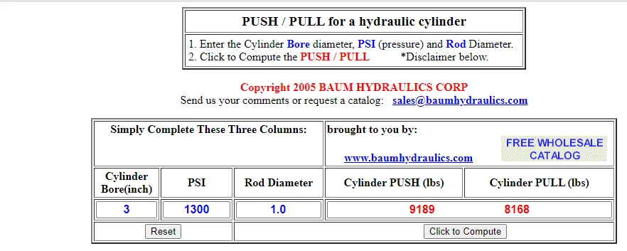

Not so tongue in cheek but a steering gear has a 3" diameter piston in it that moves the sector gear. Even in stock form the steering pump is capable of and puts out 1300 psi. That is an area of right at 7 square inches. That times the pump pressure in pounds per square in = about 9000 lbs. of force moving the pitman side to side at the shaft.
Or, if you don't believe my math, a simple hydraulic cylinder force calculator shows the same thing. Ignore the side with the shaft.
In short, no amount of steering stabilizers will affect or bother the steering gear.
Thank you. I was worried that I made my first mistake
