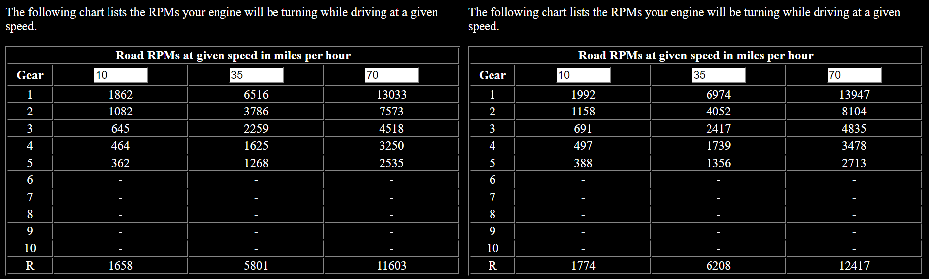

With my 97 I ran 4.56 and 33s but I had the AX5, and since it was a 4cylinder Jeep I didn't use 5th very often when I was out on the open highway or climbing hills at highway speed.
For your set up if you know without a doubt you're never going to need/want to regear again you could get away with 4.56s but I would probably go with the 4.88 just for a few hundred extra RPM to give you back that highway hill climbing ability.
AX5 gear ratios: 3.92, 2.33, 1.44, 1.00, 0.85 and 4.74
NV3550 gear ratios: 4.10, 2.33, 1.39, 1.00, .78 and R3.57
The image below if from grimmjeepers calculator. the RPMs you experience might be slightly different if your spedometer is accurate due to variances in true tire heights, but it wont be by much. As someone who has just recently seen
4.56 gears .................................................................................................. 4.88 gears
As someone who recently discovered what a couple hundred RPM can do climbing a slight incline I can tell you it does make a difference
