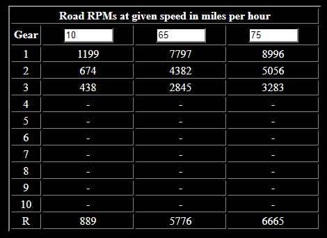

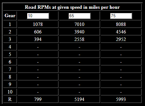

2001 Sahara, 4.0L, 32RH 3 speed auto, stock Dana 30/35, 3.07 gears, currently on 33's (yes, it's a dog).
I am going to be regearing soon as well as installing a Super 35 and lockers. I plan to go to 35's for my next set of tires so I am going to regear according to that plan. 4.56 seems to be the consensus for 35's with the 32RH but looking at grimmjeeper.com 65mph seems to sit at 2800 RPM's and 75mph around 3300 RPM's with this set up. This seems a decent bit higher than the 2500 at 65 and 3000 at 75 that people have claimed to be optimal in this thread. 4.10 gears, according to grimmjeeper, would put the RPM's almost exactly at those numbers at those speeds. This is my daily driver and I often drive full days on the highway to get to wheeling spots so I'd prefer it to be optimized for on road use but don't want to sacrifice offroad performance too much. So my question is why is 4.56 recommended over 4.10 for 35's with the 32RH. Is it better for the engine for RPM's to be slightly higher? Does it have to do with crawl ratios (which I'm not too concerned about)? Or are there other reasons? Maybe I should just shut up and listen but I like to learn and understand things and with regears costing as much as they do I want to get it right the first time.
Is there anyone who has ran this set up with these gear ratios that could share with me their experience?
4.56 w/ 35's:
4.10 w/ 35's:
Bigger tires and wheels are heavier. You want to err on the side of more gear not less.
There's only 300rpm difference at 75mph which is hardly noticeable.
We regear for street performance. The transfer case takes care of the crawl ratio.

There are some general goals of trying to aim for a specific cruise target, for example 3000 at 75 being a decent one. However, that is typically utilized more on the transmissions with closer ratios, like the 5 or 6 speed. The 3 speed has such a wide spread that it’s better to err on the side of lower gearing to help make it less of a pig. It also helps off-road but really it helps the street more.
With 4.56 you would essentially be geared like a stock auto that came with 3.73 and 28-30” tires. You will be significantly lower geared than one of the stock autos that came with 3.07, but that’s a good thing. In this case we tend to think that the stock 3.73 3-speed setup was decent and matching it with the new tires is a decent way to go. Hence 4.56 and 35’s.

Thank you! That helps me understand it a lot more. Especially the point with the 3 speed having a much wider spread. I had not thought of that before. Sorry if it was a dumb question I just like to fully understand what I'm doing and the why behind it all. I'll be going with 4.56(y) Thanks again!
