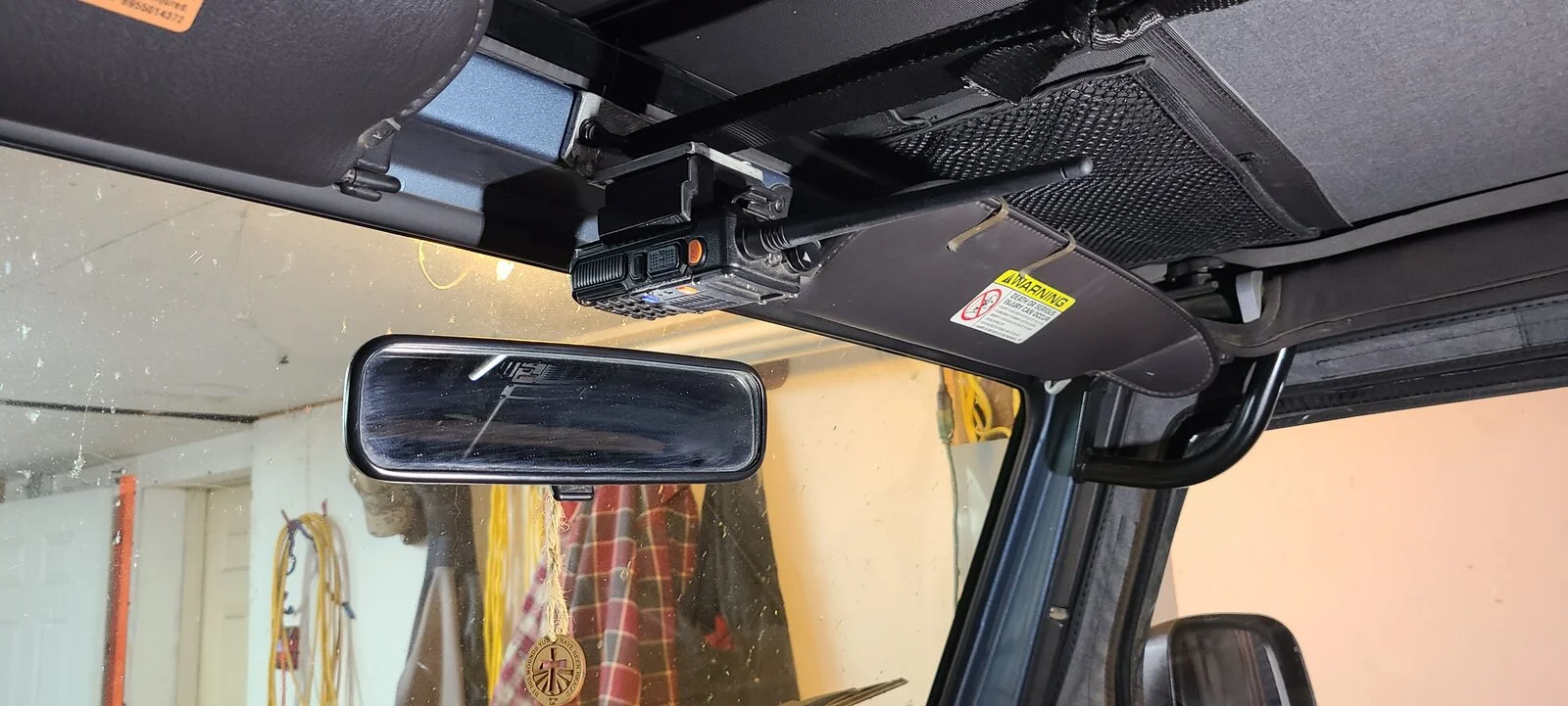

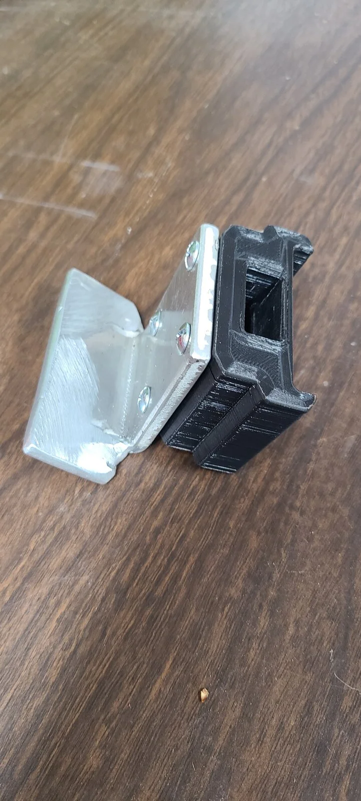

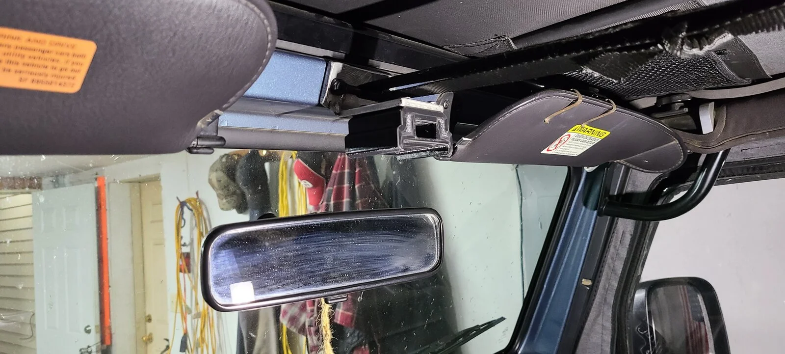

Had a mount printed for my GMRS radio then attached it to an aluminum bracket.

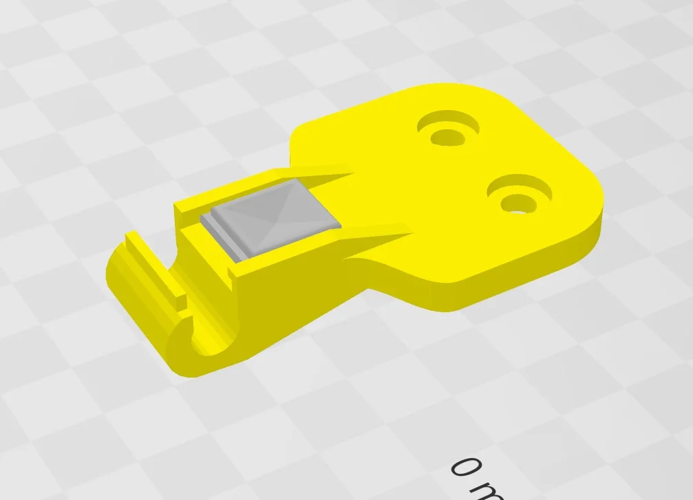

So far I've printed sun visor clips with a slide lock so they don't pop out from PETG. Printed the insert for the center console from PETG. Print new hood/fender bump stops from TPU. Print new 4x4 shifter bushings from carbon fiber PLA. Printed 4x6 front speaker conversion mounts. Printed a custom radio holder and mic clip for my UV-5R and added a metal bracket behind the grab handle for support. Printed a custom ball mount that clips in/on to the metal strap loop above the windshield for my GPS.
