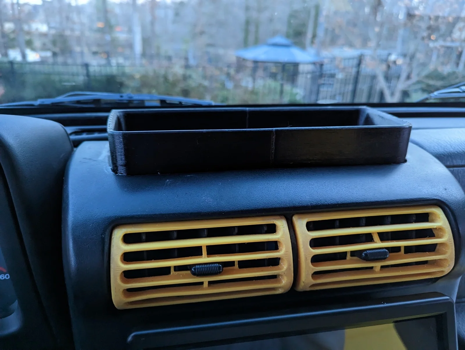

I've printed new defroster mesh, AC vents, door handles, a center console tray, a center dash bezel tray, speaker adapters, and a tool for removing the window handles.
It's been so much fun, I'm actively looking for more ideas.

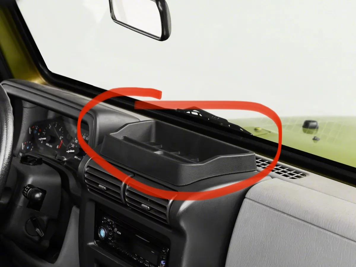

For the center dash bezel tray you printed are you talking somethin like this?

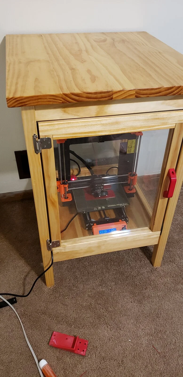

I'm using a hot-rodded Prusa MK3S+. I crank the extruder to about 345°C, the bed to about 155°C, and the enclosure to about 85-90°C for polycarbonate printing. All of the extruder parts are pure polycarbonate; the body parts are polycarbonate blend. Had a fun time trying to print everything while the original PETG parts slowly melted down...
The enclosure is double walled plexiglass with a real glass inner liner on the front door. Foam board and foil insulation on the top and bottom. The enclosure heater is a 120 watt PTC heater, which is powerful enough to heat the enclosure to 70°C in less than 10 minutes.
(This photo was taken prior to installation of the polycarbonate parts and enclosure heater.)
Ultimate goal is to build a 350mm^3 Voron V2.4R1 Doomcube. The Prusa enclosure is actually sized to perfectly fit that printer on top.
