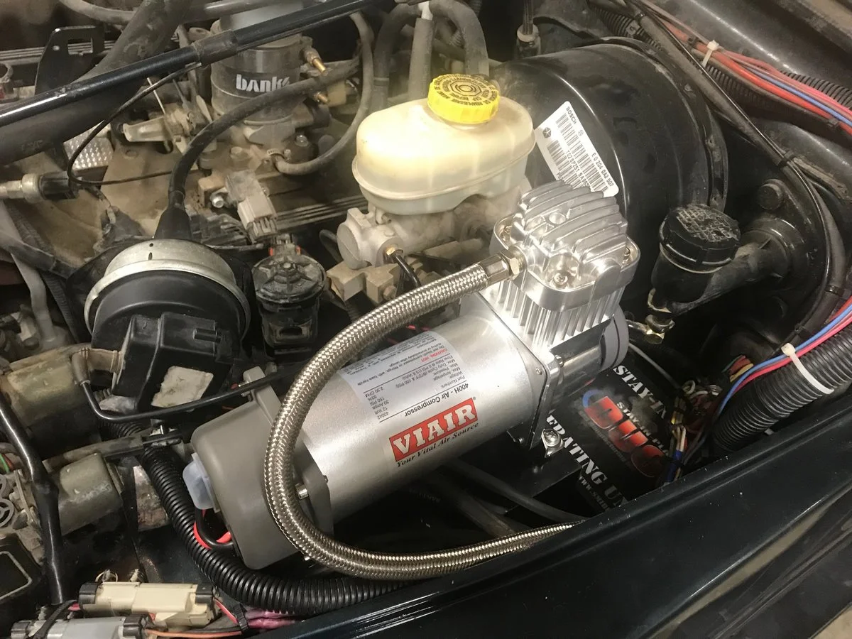

Not having the canister there gives me space for 1) the two compressors for the Rubicon lockers, 2) the Viair onboard air compressor and 3) the compressor box for the Stay-In-Play auxiliary braking system.

Replace the canister with a hose. Nothing else to it. I'm not saying anyone should do this. My only point is that in my experience there has never been a CEL from the lack of a canister, nor were there any unusual smells afterwards.
So the canister has 3 hoses on it. What did you do with them? Just block them off?
I'm trying to squeeze the Stay-in-Play Duo tow brake system in my TJ. Probably on that side of the engine compartment. So I'm doing this mod with the evap canister. I moved the canister under the 2nd battery tray, which is a little tight. Now I'm going to put the Stay-In-Play box on top of it like Turbo TJ did. And the on-board air compressor where the canister originally was to begin with.
I replaced the canister with a hose. Nothing more, nothing less.
