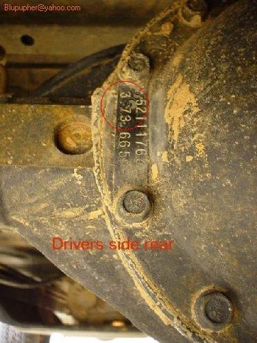

Do you know what axle ratio is installed? 3.07 or 3.73? If you don't know you can look at the steel tag with your ratio embossed into it at the 9 o'clock position on your differential cover. This one is indicating 3.73 gears are inside the axle. A 3.07 ratio would cause excessively low rpms on the highway which can wreck the mpg, 3.73 isn't far behind with that problem though... all due to how low the 42RLE's .69 Overdrive ratio drops the rpms on the highway.

So, from what I’m seeing, it’s 3.73.

so, first things first. I went off what the previous owner told me, that the tires are 31”s. They are not. They are 285 75 16 - 33”s.
AND, it’s the 3.73 gearing, according to the cover. I know the PO said he did not get it re geared.

33's with the 42RLE transmission and 3.73 axle gearing is an absolutely abysmal/terrible combination. For the engine to run well and be in its power band to not lug (which gives poor mpg) and generate the power the engine was designed to produce it'd require no less than 4.88 but 5.13 in the axles would be an even better choice. Driving two TJs configured alike with 33's and 42RLE but one with 3.73 and one with 4.88 or 5.13 you'd then be convinced to beg, borrow, or steal the $$$ to install the one of those two preferable ratios lol.
