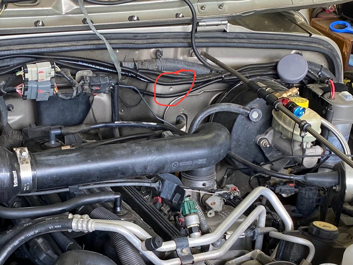

As far as getting power from the battery to the sub, I drilled a hole in this general area, used a grommet that fit the hole and was snug on the power wire. See the dimple? There are a couple there. You can see that area easily from under the dash and determine where you need to drill without hitting anything.

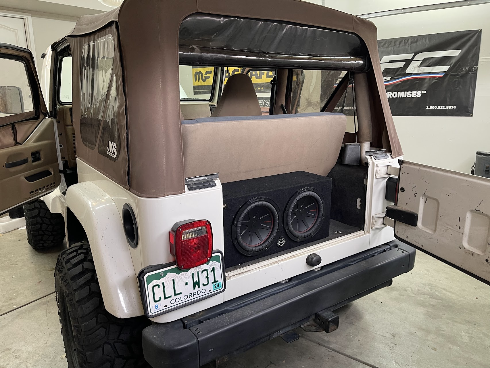

My original intentions were to install a powered subwoofer, but I chose not to and instead install something that could be heard with or without the top, in various situations.
Powered Subwoofers are great if your intended purpose is to have a little bit of bass, but the output gets rather slim with the top off at 60mph.
There's just not enough airspace/power in the powered woofers to create any substantial bass output for those situations.
The flip side of that coin is the fact that any other subwoofer setup is going to waste what little amount of cargo space available in the TJ.
So it's a double edge sword, and you'll have to decide which is most important to you.

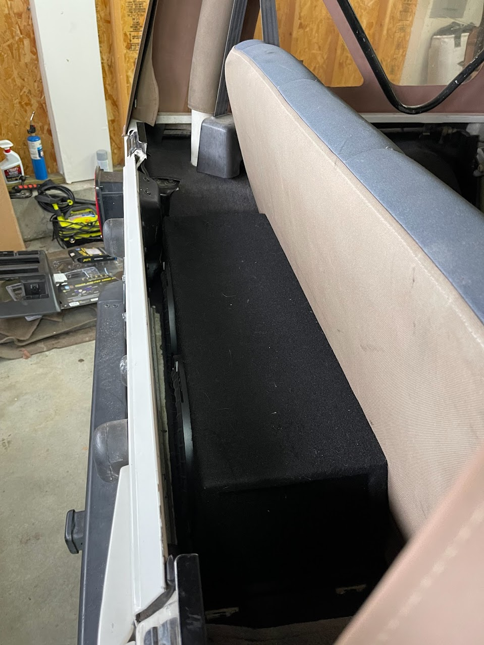

I chose to install two 10" Kicker Subwoofers instead, in a BassWorx SW210B Box.
This was the only box I found that would house dual 10" subwoofers, and fit behind the rear seat.

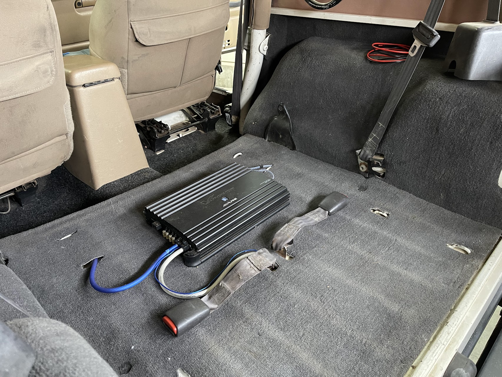

They're powered by an Alpine MRP-M1000 Class D Monoblock amplifier that I've got mounted underneath the rear seat.
All wiring is routed along the edge of the tub, underneath the carpet, and then I pulled them through the rear-seatbelt holes.
As far as speakers are concerned, I've got 2 Kicker 5.25" Speakers in the Roll Bar, as well as 2 Kicker 5.25" Speakers in the Dash.
With this setup, I've got consistent sounding bass and crystal clear audio at any speed, top on or off.
(here are some photos of my TJ after install)

While I'm sure this setup sounds better than my little 8" powered sub (along w/ improved sound bar, footwell, & dash speakers), I can't justify losing that much of our already limited space for speakers that others hear as well or better than I would.

Sure, It definitely takes up majority of the space available.
When I still had the TJ, I would regularly remove the subwoofers if I needed the space.
That in itself was somewhat irritating.
In my current LJ, it's not as much of an issue.
