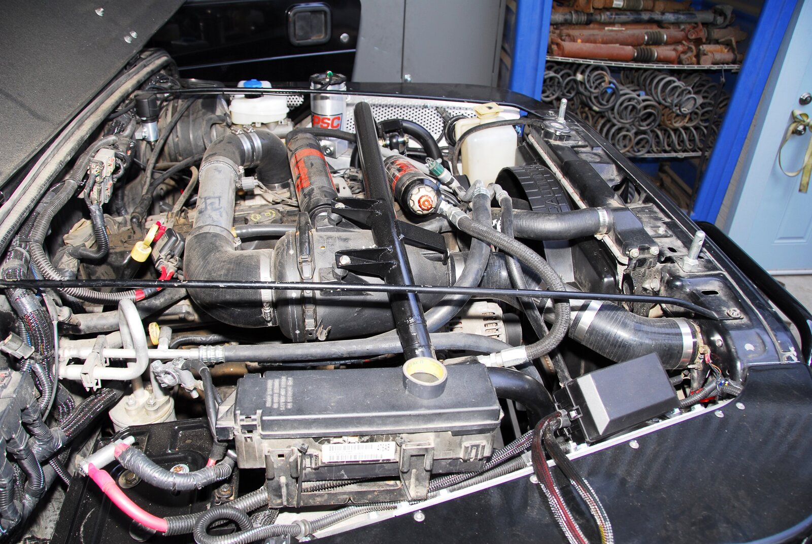

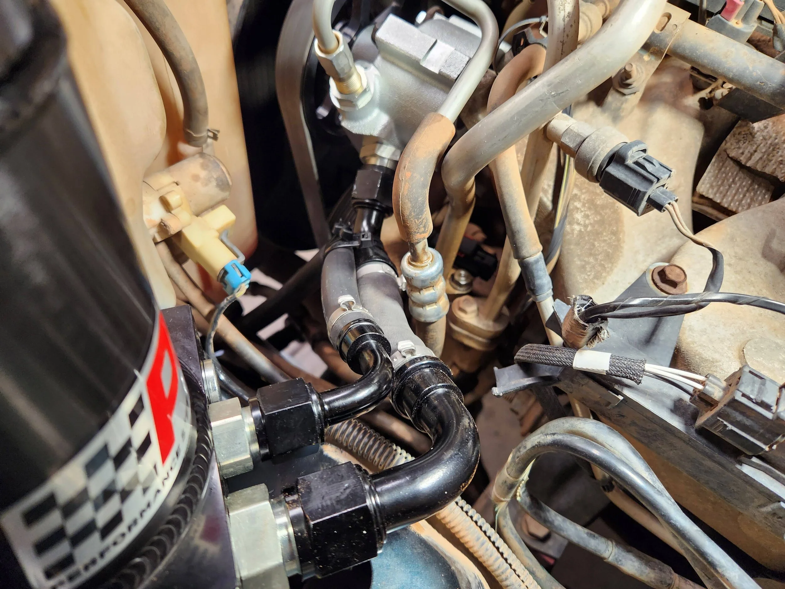

Where did you mount your PSC hydro-assist reservoir?
Blue cap is a smaller washer fluid tank and pump.

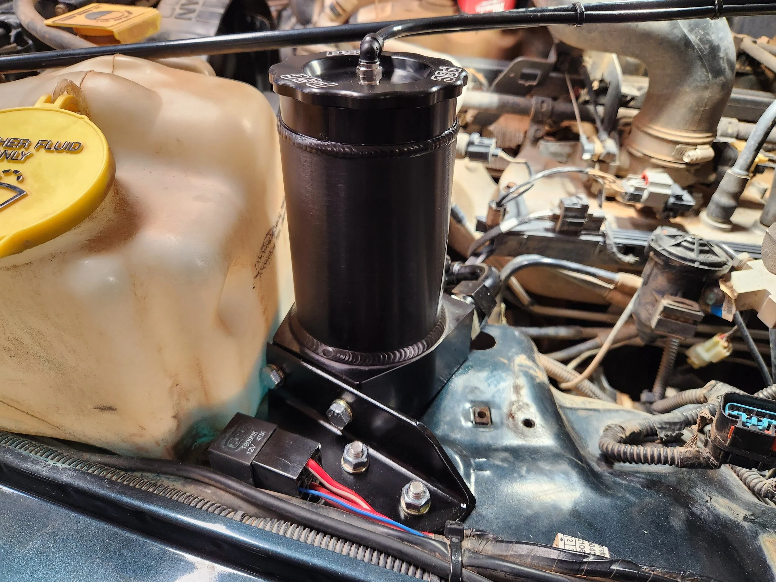

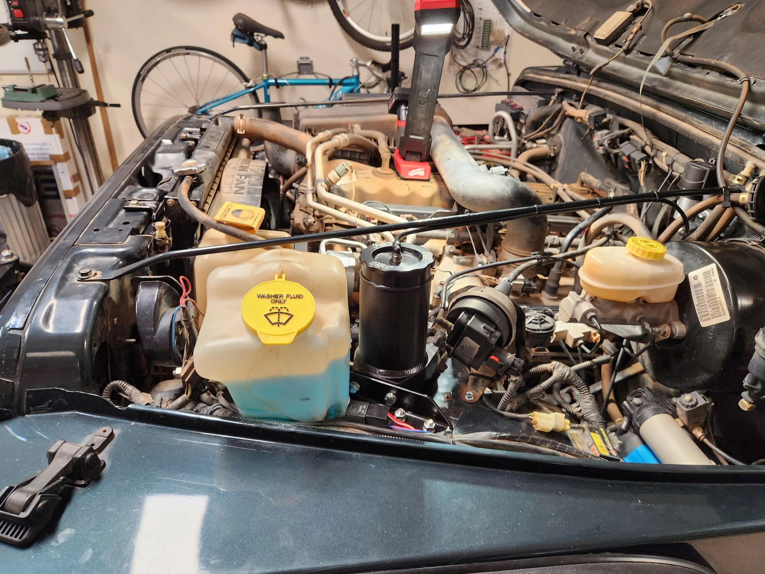

Here's my setup. Stock fender. Stock washer reservoir. Had to rotate the cruise control gizmo slightly reusing the original top hole, a different existing hole toward the brake booster, and 1 new hole, but worked out pretty well I think.

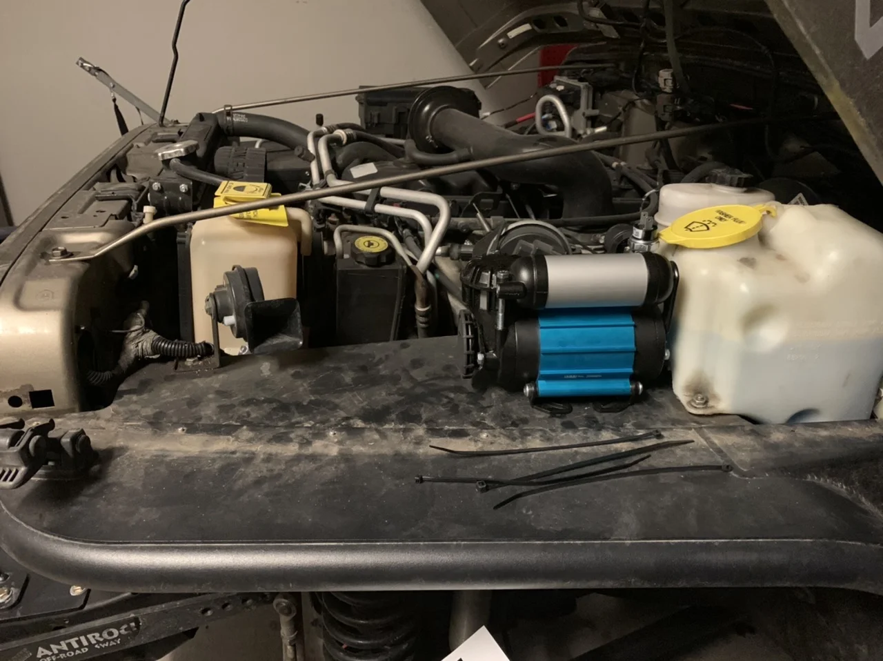

I am installing my ARB single compressor and want to make sure I have enough room for the PSC reservoir.
This is where I had planned to mount it. Do you foresee any issues mounting it here?
