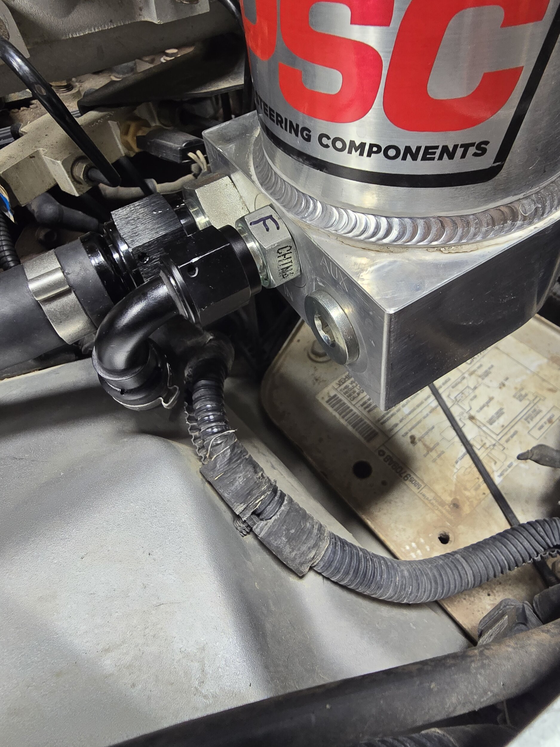

And the hose. You're welcome!
And the hose! I must've missed ordering the feed line kit when I placed my order, no barbs or hose......and the clamps do provide a nice finished look!
This should be expounded upon and clarified further. I am extremely capable of getting hoses made with crimped ends to any length I want with the fittings clocked however I need them to be. If one size worked for most, I'd have those made and sell them. They won't work well for most and at best would be a terrible compromise.
I don't doubt what you say in the least.
I built my hoses with the jeep in the Jeep air. I left just enough hose that I was able to install them with the front end drooped out. When I put the jeep on the ground, the short hose has no curvature, let alone question mark shape. In fact, I have enough hose left over to make that hose again.
I understand that each build will vary a bit. I just thought that there might be a "neighborhood" or "ballpark" of similarity, if not on lengths of hoses themselves,then perhaps on the difference of the long hose and short hose.
