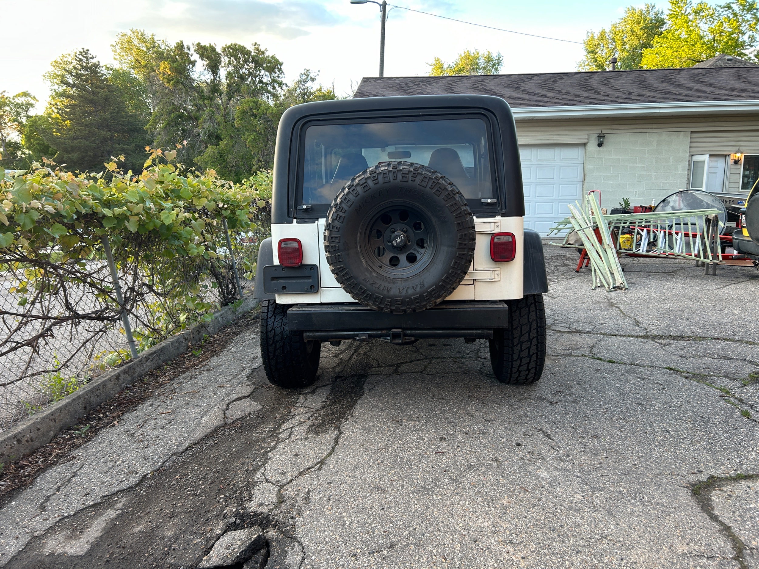

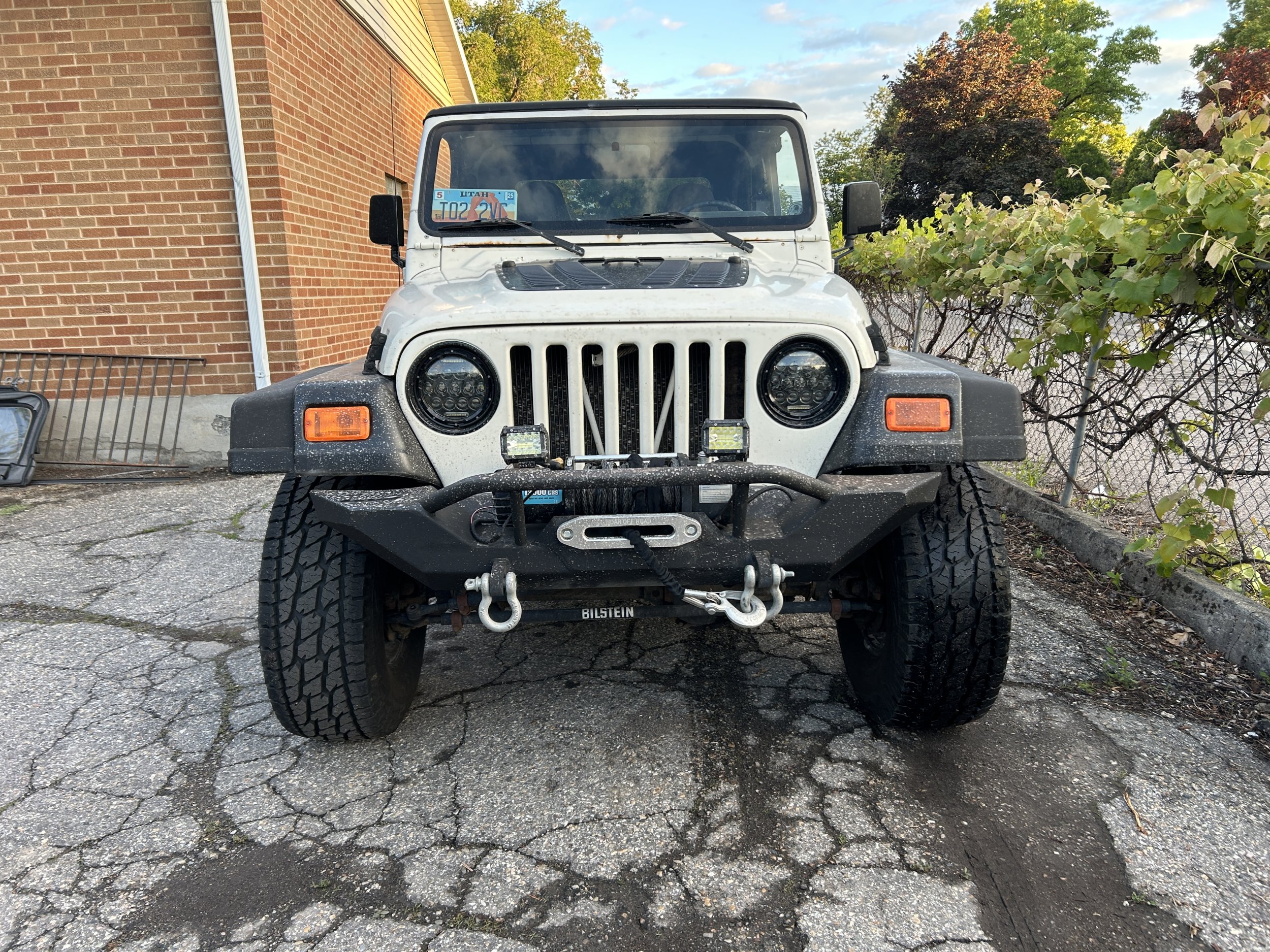

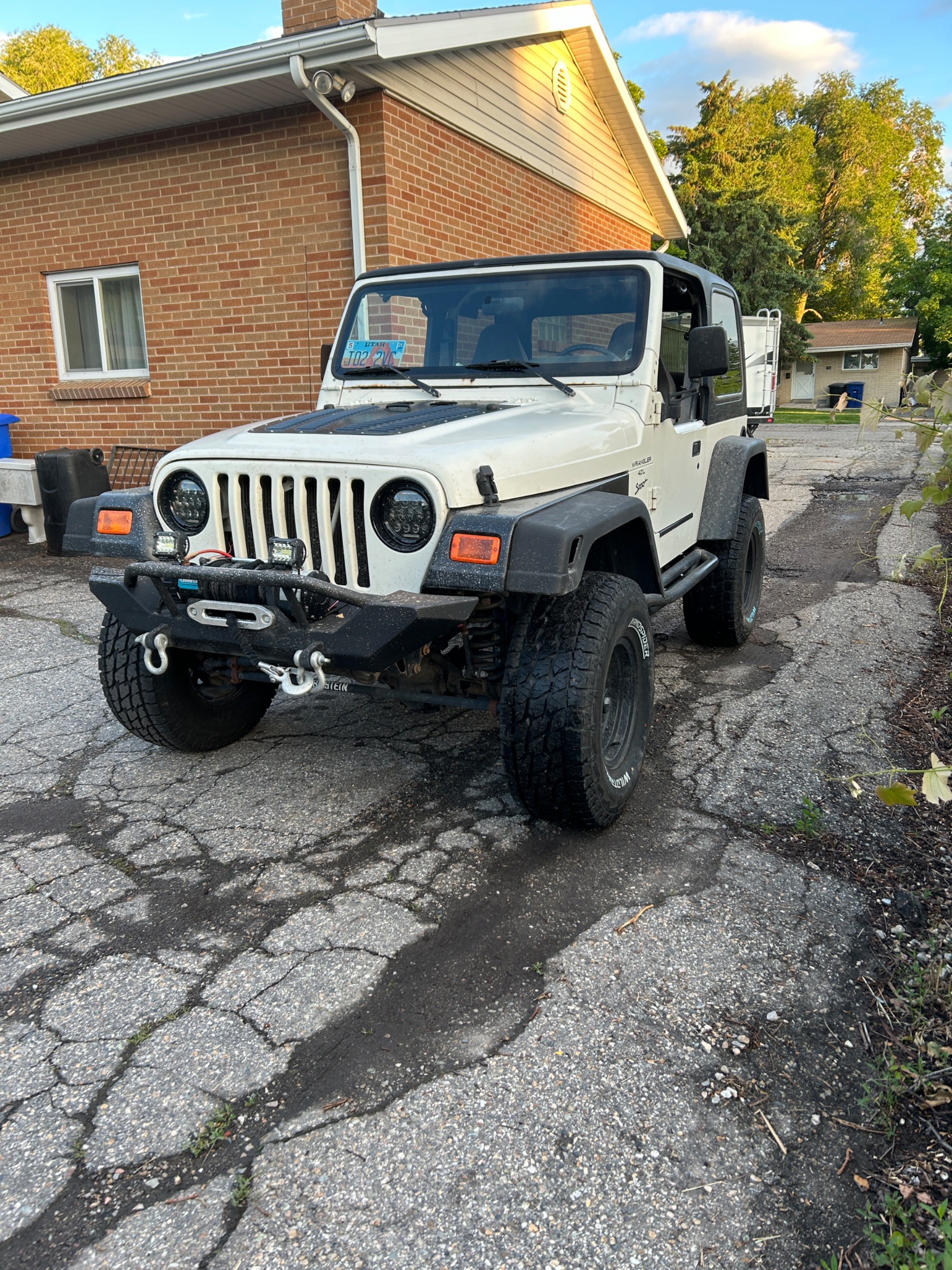

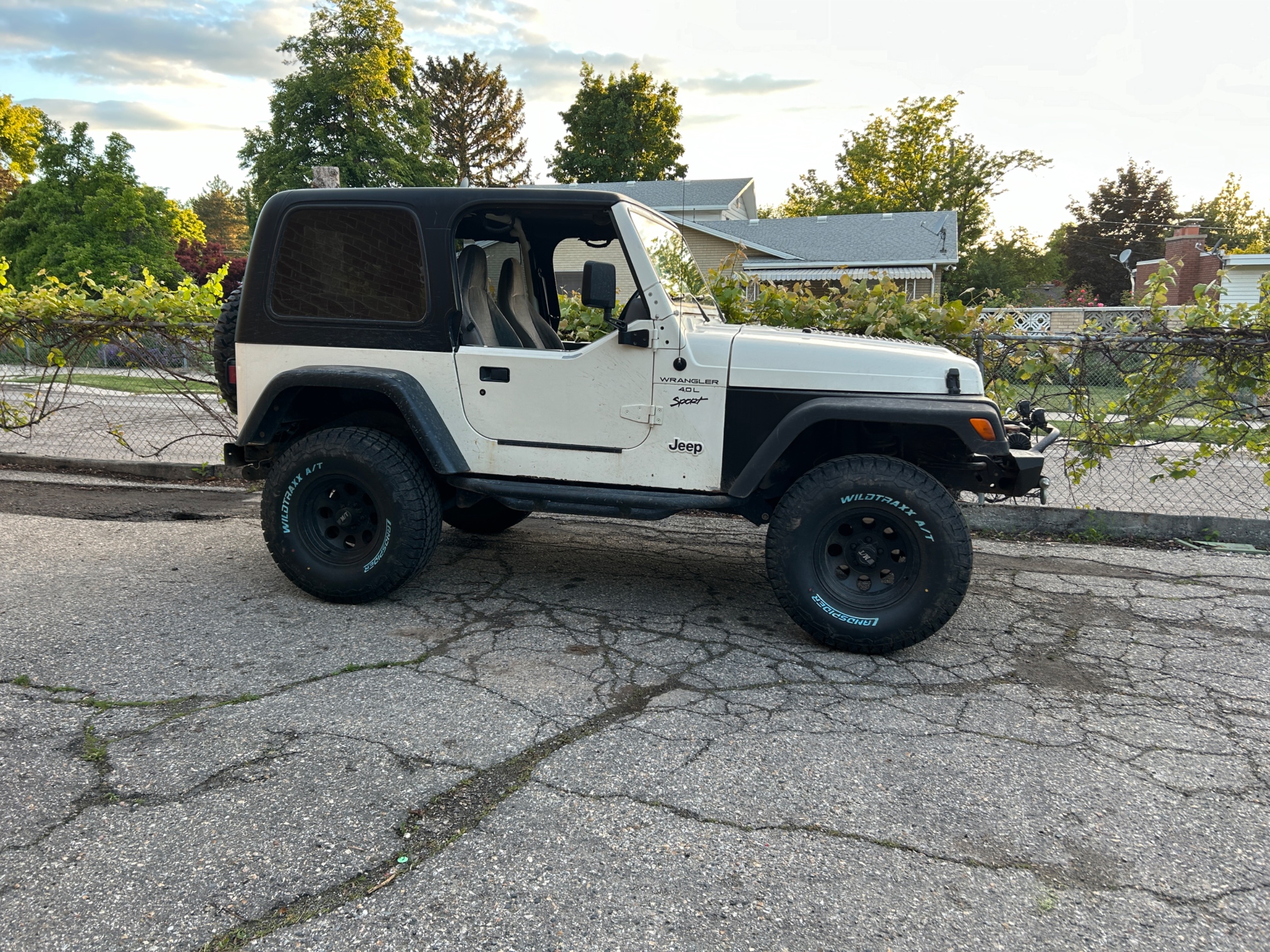

I bought my TJ about a year ago, and haven’t had a ton of time to work on it since. I’d like a little advice on where to start. The guy I bought it from was sort of shady and hadn’t really done all that much to it. It’s got a steel bumper, led headlights, a winch, 33s, and what I think is a 4 inch lift, but I’m not really sure. Other than that it’s a bone stock 97 sport. It runs just fine and I have no issues other than a couple leaky gear boxes. I’m tracking it’s gonna need a SYE and the diffs probably need re geared. I’m looking for any advice on where to get started on this thing and maybe some wisdom for someone new to this sort of thing.

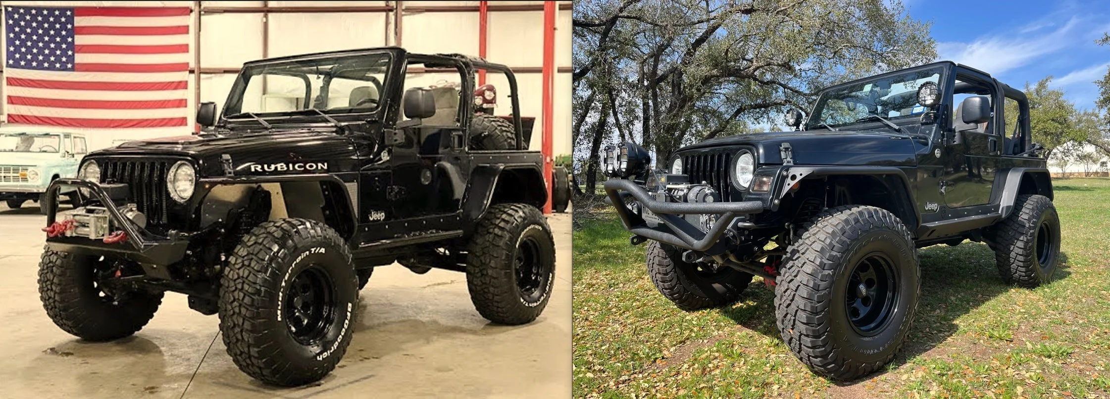

But I'm almost always a Red Jeep, so black, I started looking. Below is frankly the example, what I found and liked, and built with a lot of things from here, and wanting to be able to stick to short arms, 35's, and lockers and a higher skid for clearance.
Mine is on the right, and I'm pretty close. I went full black out as much as possible, just going with it, and mine isn't a Rubicon, but I swapped 2005 Rubicon axles and lockers with upgraded gearing. My CJ5, want a lot more stainless or chrome, ha. Wheels and eventually bumpers etc. right now, you ask this, you'll get everyone else's thoughts...which come from what "they want" in their vision.

I’m not trying to sound abrasive, but if it was mine, I would pull the front bumper, get a stock one for 40 bucks and cut it down maybe…. And get those flares off.

Those front fenders on pic 2 are kinda cool,I wonder what they are?
The ones on my TJ, in my profile? They are Warrior Products metal fender flares, I think the 3" ones, they have 6" I think. Came on the TJ and yeah, I like them without cutting the fenders for Hilines.
