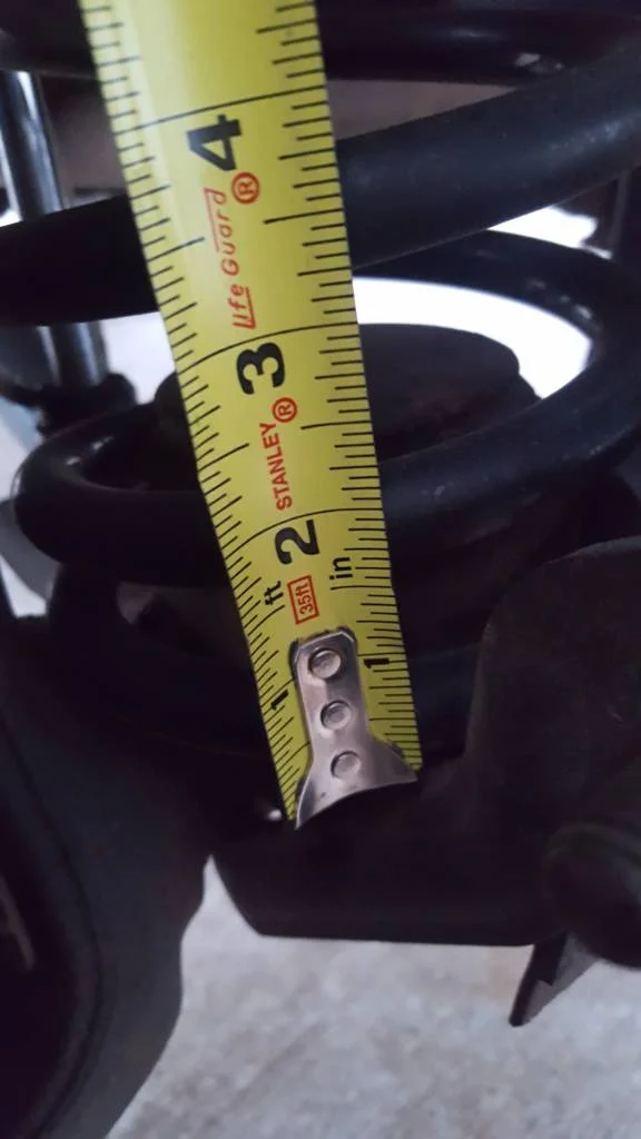

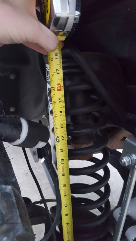

Actually, after measuring it may be around 6" front and 5" rear? I read to measure the springs and subtract 12" from the front and 8" from the rear. That still an acceptable method?
Sent from my SAMSUNG-SM-G890A using Tapatalk
Measure the spring only, not the isolator. But yes, that is the way to see how much lift you have. There was a couple of recent track bar threads going. To sum up, Currie, JKS, Metal Cloak were the top recommendations, listed from most expensive to least.

So looks to be about 5.5"... maybe once I get a winch put back up front, it'll bring it back down. The previous owner definitely had a winch on it before.

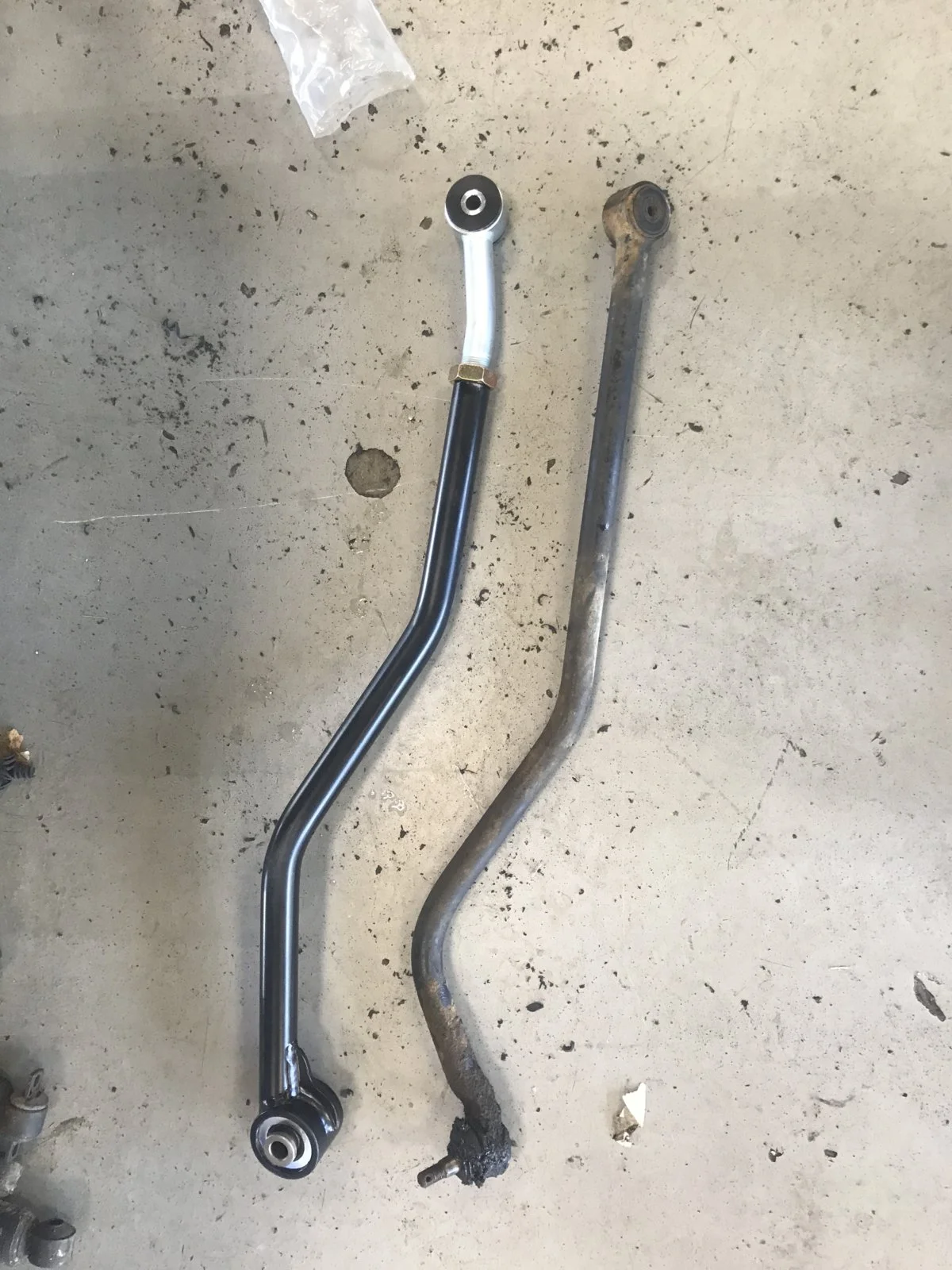

Thanks for your input. Looking into the JKS a little harder now.
