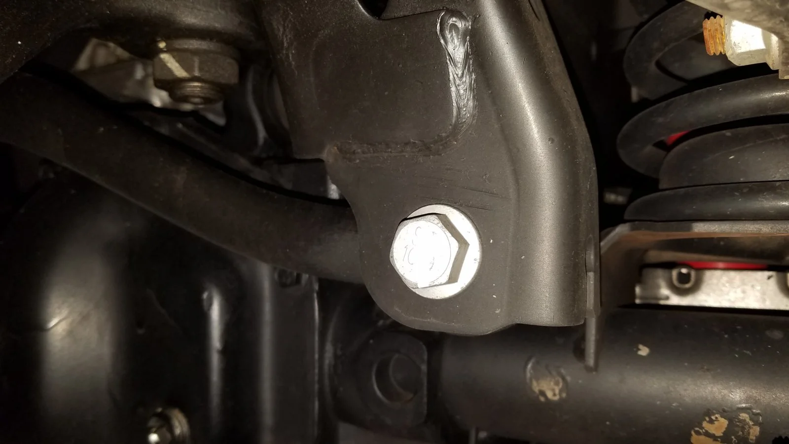

In my case it's fine as the frame side bracket is aftermarket and the bolt runs front to back. However I was more thinking on the axle side where I have a heim.

Is bump steer an issue with the raised axle side?

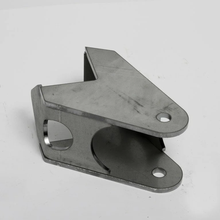

Here's your adapter ;) tmr used to make a non offset one as well but I don't see it on the site. A phone call would probably land you one though.

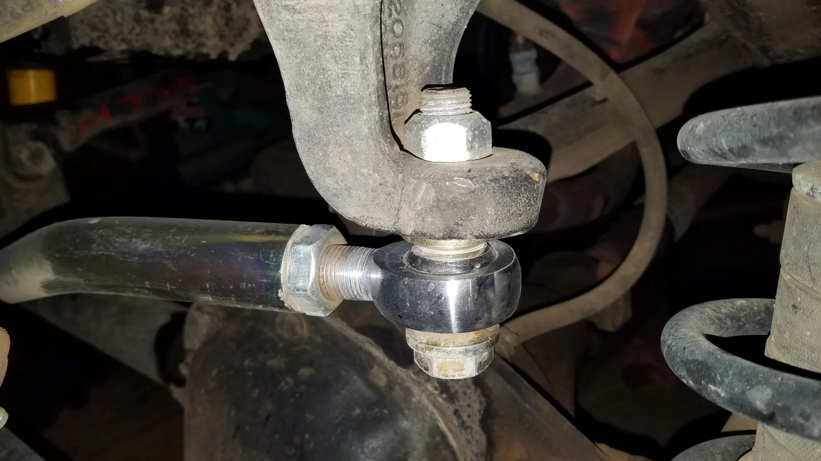

I have a MC front on mine. It is doing the job. The only thing that bothers me is that the heim joint developed play within 10k miles. I don't think I notice it while driving and I haven't checked on in quite a while. I still don't like it.
You know, I asked @Matsonian from Metalcloak about the heim joint thing a number of times, but he never got back to me (though he said he would) about it. Last I heard he was suffering from bronchitis, so I hope he's still alive, but that was months ago.
Anyways, the heim joint seems like a design failure, but I know nothing about this sort of engineering, so I could be wrong. But given how many people I've heard who had the same issue as you did with the heim joint, it makes me thing they could have put something better in place of it (i.e. a Duroflex joint).

It can be, you have to get everything setup just right. Just so happens with my knuckles the and the stock pitman arm the geometry works with a raised axle side. Basically though without some crossover steering setup probably it will. For instance if you did wj knuckles perhaps a raises tb mount would work.

Does the Currie have a weld on bracket as well? While I have no problem adding things via welding, a lot of ppl would not like that, and the more "bolt on"a kit is, the easier it is for the vendors to sell I would expect.
The thing to remember is heim joints (cheaper ones at least) are about the least expensive flex joint on the market. So when you are trying to build to a price things like this happen.
A good alternative would be a high angle tie rod end. I use one on my drag link and the threaded shank for the tube is on an angle to the face if the joint. Could work provided you have the lift for an and designed the bar for it. Then you would have a greasable joint.

A bushing (cleavite, DF, ...) won't last long on the stock frame side mount because it can't withstand the constant misalignment the way that a heim or Johnny Joint can. The bushing can tear, deform and delaminate if it doesn't return to a neutral position, where the Johnny Joint doesn't care what position it is in. That was a reason I ultimately went with JJ control arms. JJ's are more robust by their nature.
A Johnny Joint is able to work better laying on its side than a heim can because the tight urethane races provide a good seal and has a wiping action keeping the ball clean; not allowing crud to get inside the assembly. A heim that is continually placed in and out of alignment will fail because it doesn't seal as well as a JJ.
That's how it was explained to me. Which makes good sense, I think. Clean balls.

A heim joints primary function and design is to move up and down when the mounting bolt is in a horizontal position. That way the ball pivots primarily within the cup. When the bolt is vertical, like the track bar mount, the ball pivots too far out of it's cup causing more stress to the cup and introduces more contaminants.
2003 Rubicon
I think the greasable nature of JJ's also helps keep water and mud out. With a heim it just sits there working at the Teflon coating until it's all eaten away.
Up here, sway bar link heim are a few seasons, steering is every season, control arms can be even worse. I'm gradually replacing every heim with something that has a grease fitting.

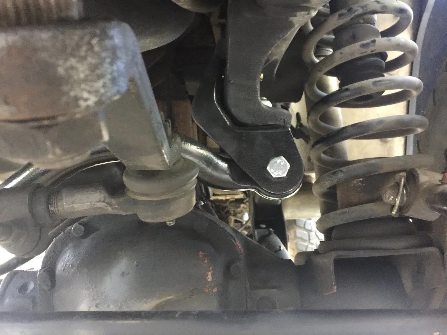

Maybe a bracket like this would allow the heim joint to work within reasonable parameters:
Reactions: ac_
It would. The 90° turn makes a big difference. Bear in mind that is a dropped bracket which will change the track bar's relationship to the drag link and will cause bump steer.
