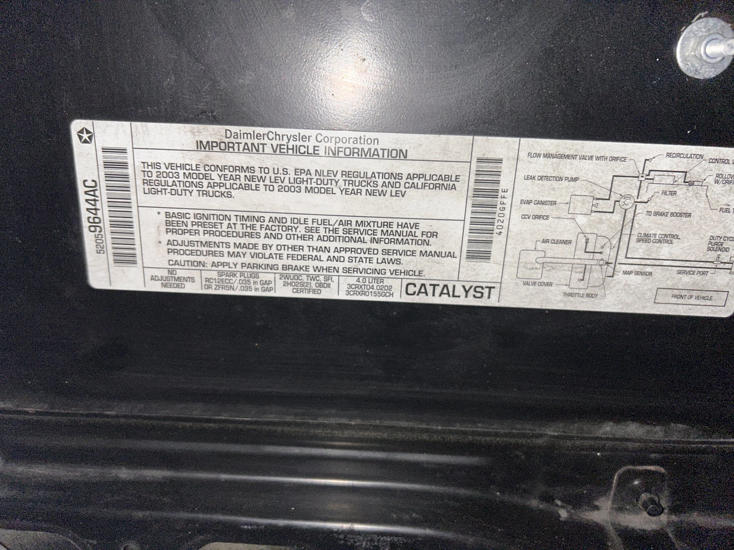

Hello everyone, I need some help figuring out which cats to buy. I have a 2003 with the 4.0L and the sticker underneath my hood says that the car conforms to epa regulations and California regulations. Does this mean I have to buy carb compliant cats? I was looking to buy cats for the 04-06 models since those come with all three cats and seem to be cheaper. I've been reading that they should bolt on fine to a 2003 model. Any insight is greatly appreciated. (I am looking to replace my cats to elimate a P0420 code)

Hello everyone, I need some help figuring out which cats to buy. I have a 2003 with the 4.0L and the sticker underneath my hood says that the car conforms to epa regulations and California regulations. Does this mean I have to buy carb compliant cats? I was looking to buy cats for the 04-06 models since those come with all three cats and seem to be cheaper. I've been reading that they should bolt on fine to a 2003 model. Any insight is greatly appreciated. (I am looking to replace my cats to elimate a P0420 code)View attachment 586867
