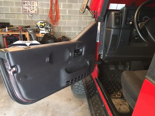

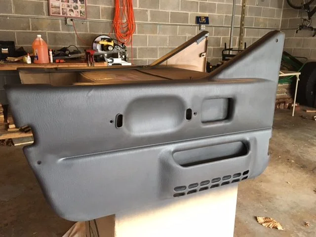

SEM was dead on exact color-wise. I can't remember for sure, I think mine was slate, but a perfect match.

SEM Slate? Looks like there are two Slate options with SEM.. Medium Slate-15373 & Dark Slate-17373
At $25 a can I don't really want to get it wrong..

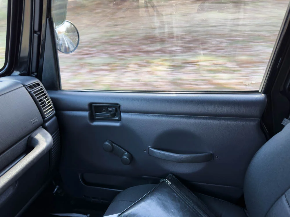

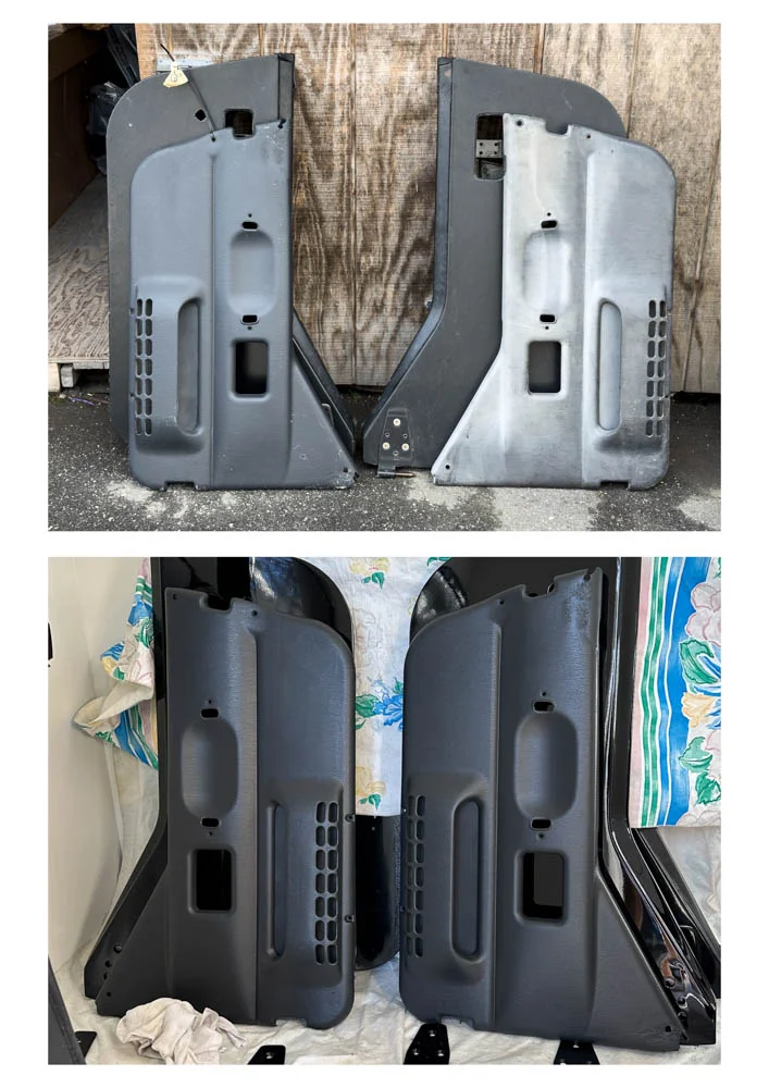

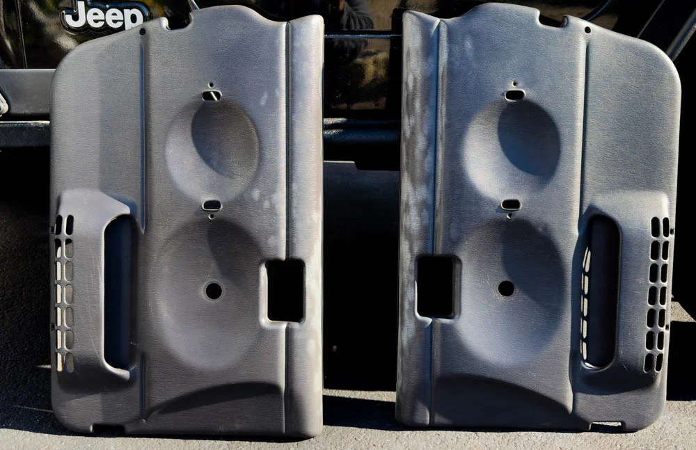

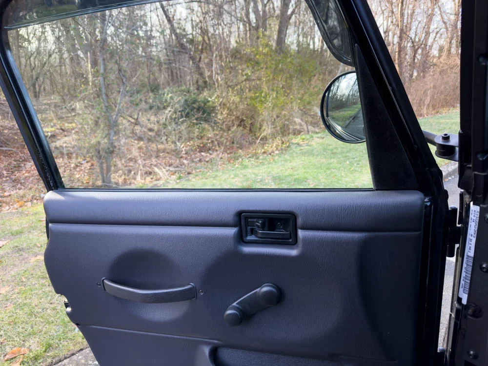

I didn't. I opted to have the door panels for both full and half doors dyed to the factory color. Along with the upper and lower steering column trim. It has held up incredibly well. I did the full door panels well over a year ago and they still look exactly as pictured below. From what my shop tells me, dying actually impregnates the door panel with the color rather than just sitting on top of the panel material as painting would.
Looks great. So, what kind of shop does this kind of work?
looks good!

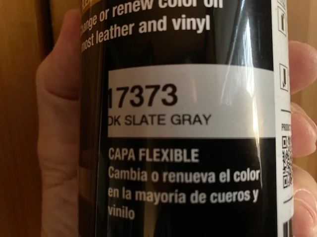

not off the top of my head but I still have the can at home, I'll check later on today & get back to you with the # and the TJ details.
Edit: so the interior is "Dark Slate Gray" according to my build sheet and the SEM paint number is "17373 DK Slate Gray"

Hard to believe how nice they came. Pics are good, but even better in person. I have my door straps pretty short because of the A-pillar mirrors I use so the doors don't open as much as stock so I hit the door panes with everything.. my watch, keys, foot and whatever I might be carrying out of the Jeep.. and they still look great. No scuffs or scratches.
