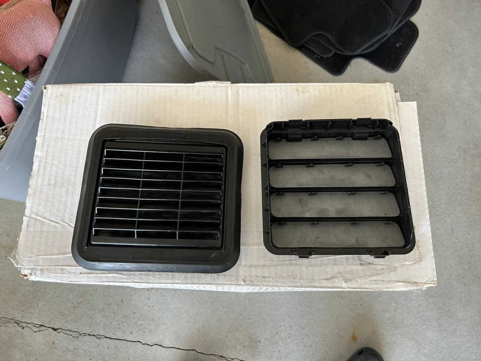

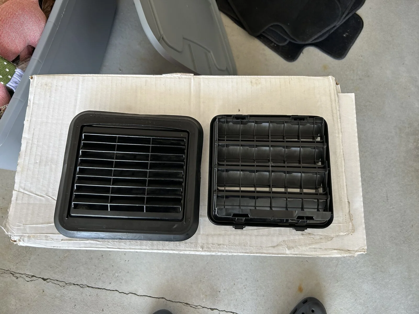

Can someone help me figure out why this has happened a THIRD TIME? The part I’m replacing is on the left. Tailgate vent. The part I was sent (despite the listing showing the part on the left) is on the right. WTF? I’m losing my patience trying to replace this stupid part. This should be the easiest task. 🤬

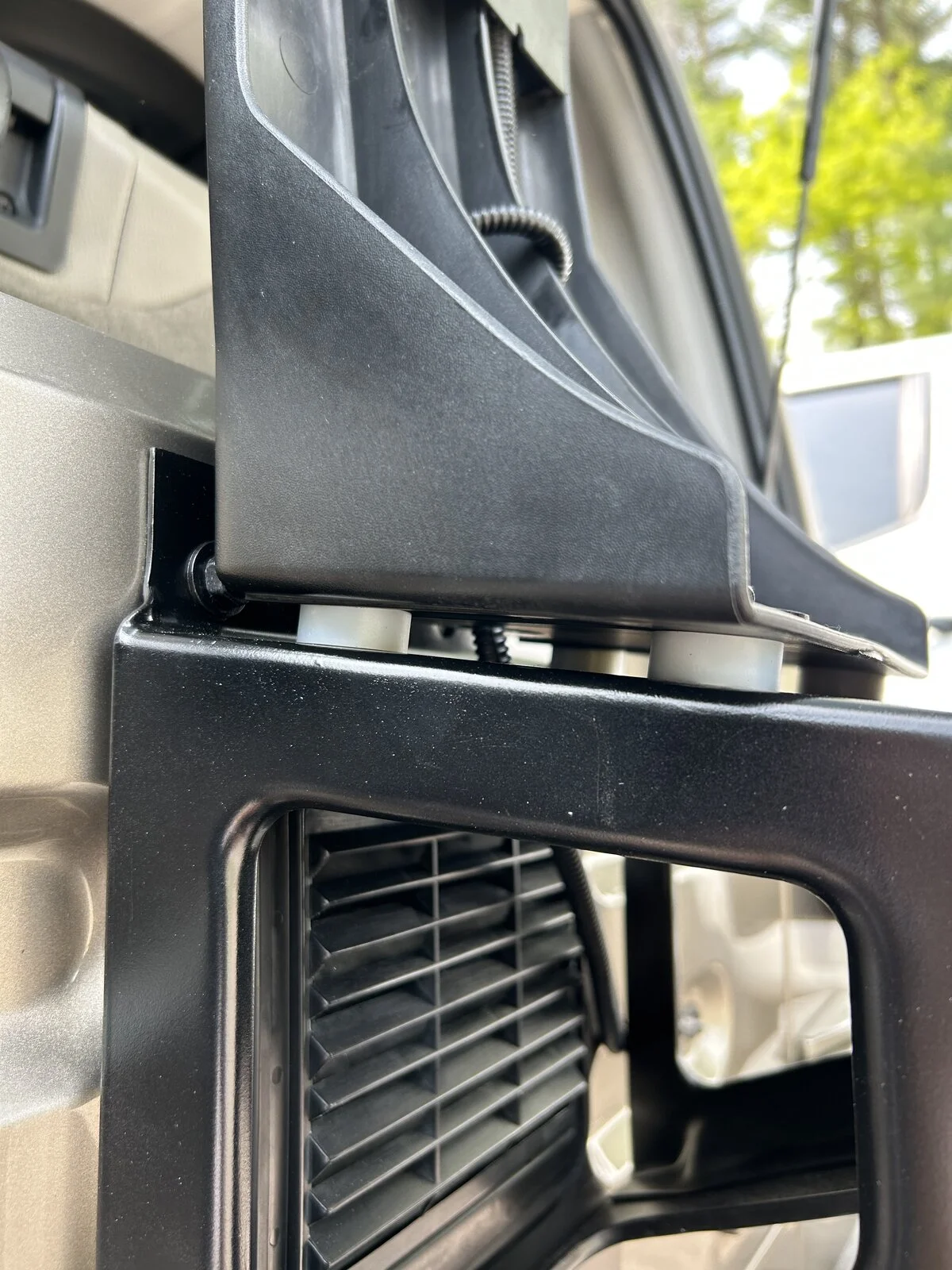

BIG mail day today. Finally just ordered a good condition secondhand tailgate vent off of eBay so I could get my brake light and spare tire mounted again. It arrived this morning and I got to work. Cleaned up real nice. Spare tire bracket and brake light went on just fine, though I did end up taking the brake light off again and adding 3/8” nylon spacers to make it sit a little higher. The 31” tire cleared, but visually it looked off. The spacers made it just right.
Hit one snag when trying to get the tire on. Couldn’t figure out why the threads weren’t reaching through the wheel; there wasn’t enough for the lug thread to catch. Then I smartened up and realized the tailgate bump stops had to come off. So, I took them off and sure enough the tire slid right into place. I put the screws back in to keep a finished look and you’d really never even think twice about them missing. Anyway, my Jeep looks like a Jeep again and I am PUMPED.

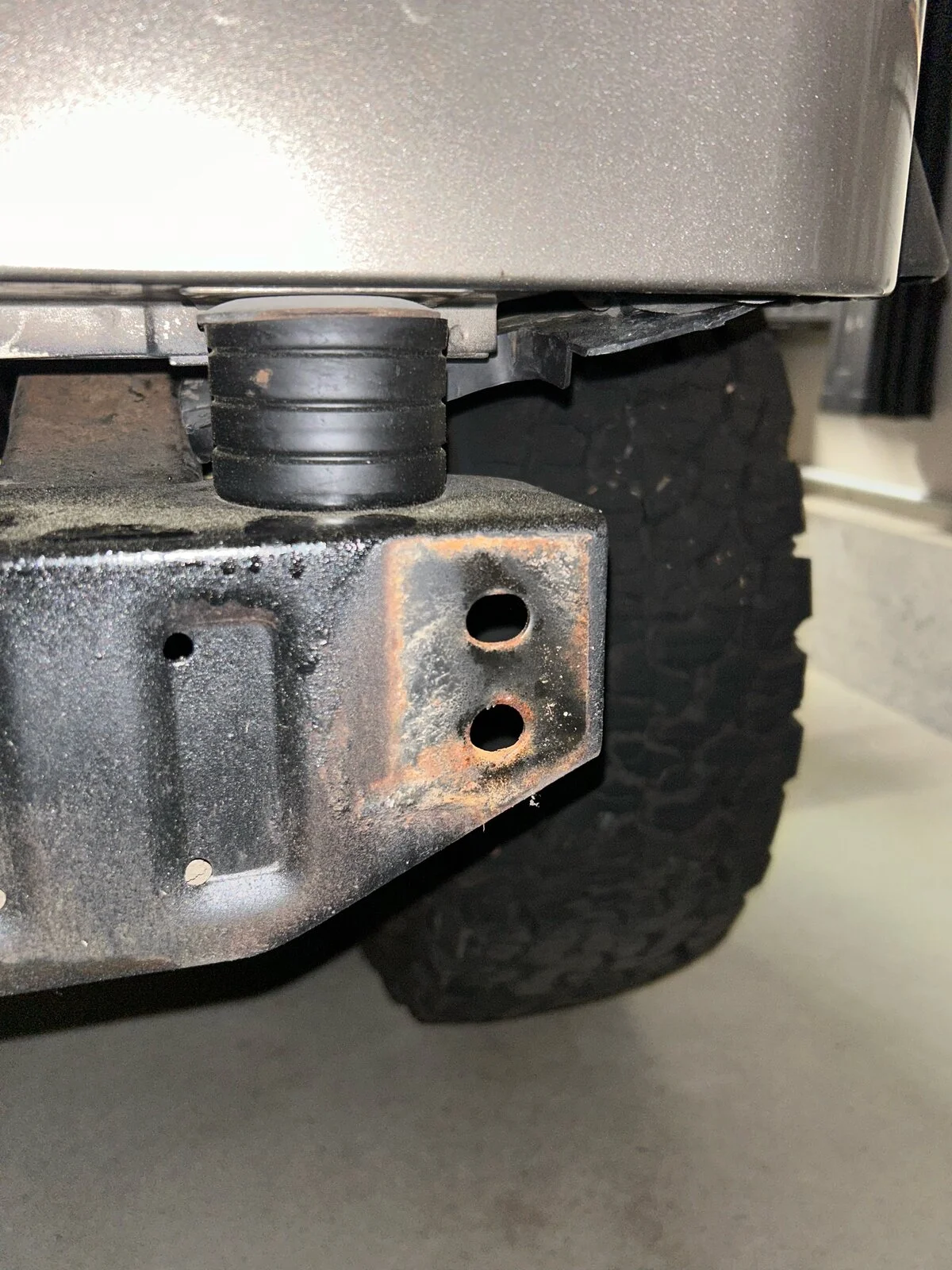

Keep in mind that the bumpers do serve a purpose. They help keep the tailgate from cracking due to the torque put on it every time you hit a bump and the tire's weight pulls on the tailgate. The bumpers use the tire to rigidly hold the tailgate and body together (that's what the one on the valance below the tailgate is for.) Although most of the cracking noted on this forum is from tires larger than 31", I suspect that it just takes more miles to see it with a smaller tire. Manufacturers being driven by the bottom line, it's unlikely Jeep would have used them if they were optional.
Reactions: wborisenok
Thank you for this. Maybe I could cut them down? Or maybe they make smaller ones for this situation. I’ll do a bit of research (y)
Most of the time, when owners go to bigger tires and change wheel backspace, they are too short, and we make spacers. I'm not sure the best way to cut them down so that they are shorter. I think there's a metal plate molded inside at the base, though I'm not 100% sure of that. Also, the mounting hole is counterbored, I think. For that reason, it would be best to remove material from the side that contacts the tire, rather than the side that contacts the TJ body. A benchtop disc sander would work great for that, if you have access to one. You want a little bit of pressure against the tire, so you'll have to cut and fit, and cut and fit, to get it right.

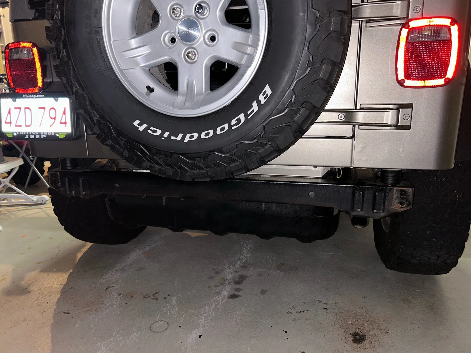

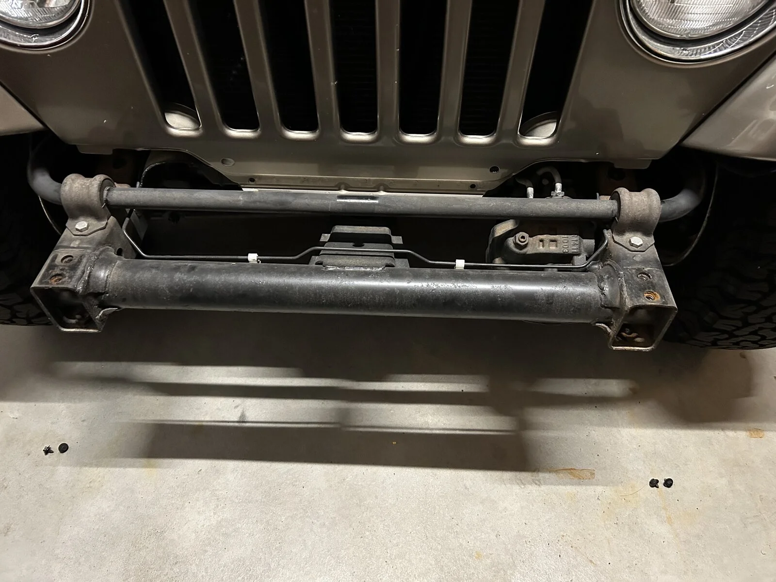

Finished up taking off the bumpers and receiver hitch tonight. Ended up with a problem bolt on the hitch so had to pick up a breaker bar today to get it off. It’s amazing what 12” of additional torque can do. (That’s what she said?).
Everything’s loaded up in the back of my truck and I’m going to drop it off at the sandblaster tomorrow. While it’s there I think I’ll hit the tops of all the bolts that show. There are also a couple of spots on the frame I’d like to take a wire brush to and then repaint:
