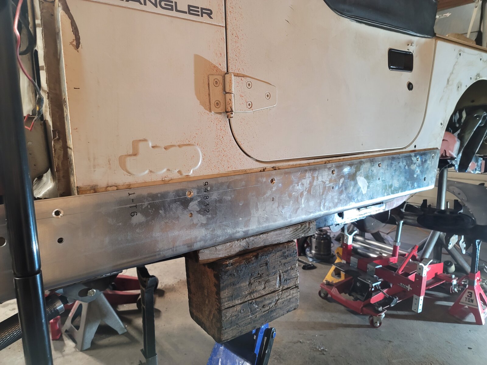

So here are the promised pictures from earlier today. Got all the holes drilled with the spot weld cutter. When it comes time to do the Metal Cloak corners that spot weld cutter will sure be handy too.
So here's two pics of the slider setup to the tub.
All the holes drilled. Once I get my welder back I'm going to weld up the old holes from my Poison Spyder armor.

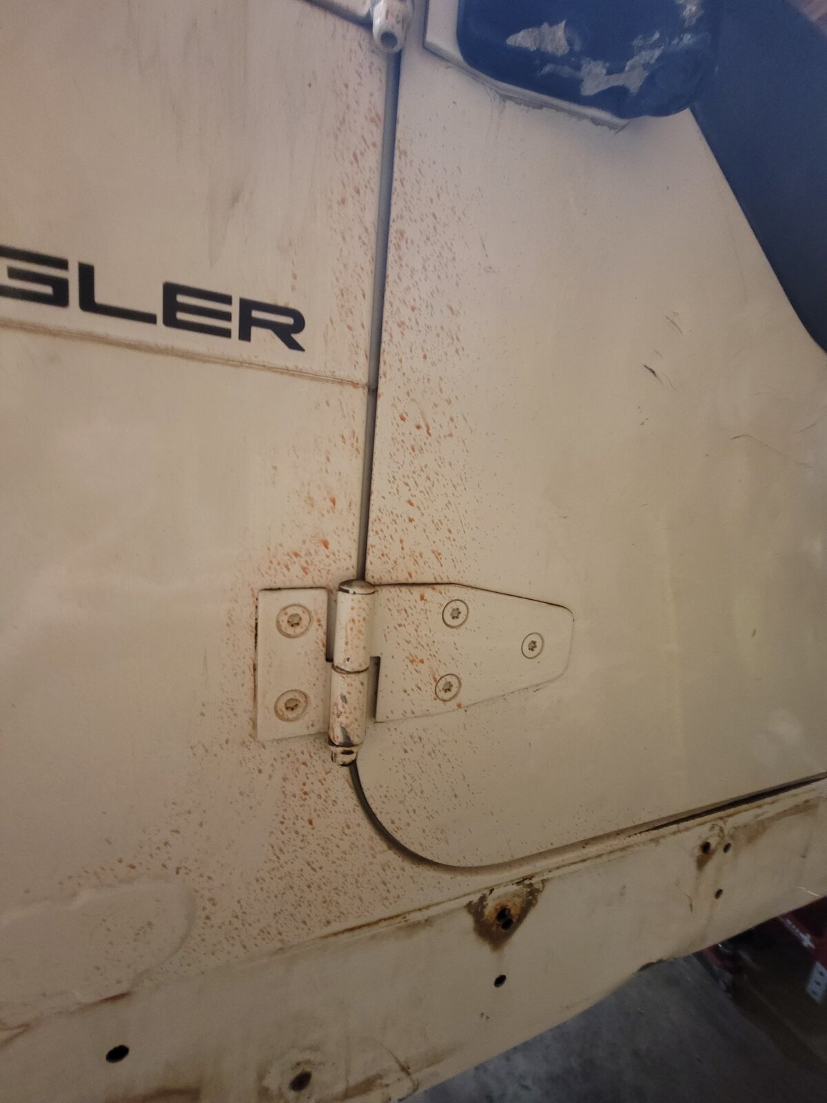

These RED spots are from the fire retardant that was dumped on my house and vehicles back in 2013 when I almost lost my home to the Taylor Bridge fire. 3 neighbors lost their homes during this fire and a lot of other home went up in flames.
No one knows how to remove this crap. Washing it doesn't remove it and the only thing I've found so far is GoopOff but it strips the paint down also. So I'll be cleaning it when I am getting ready to do all my painting.

I wonder if Iron X would remove it. It sounds like it is buried in the clear coat. May be a long shot, but the Iron X is a neutralizer. I have a little left from the Twins build. It might help if I knew what the retardant was made of.
I don't know what it's made of but they dumped two planes on my place. My old Ram which was white really looked like shit. I took it thru multiple car washes before most of it was finally off.
Between the 2 planes and 3 3K gallon water trucks they saved my place.

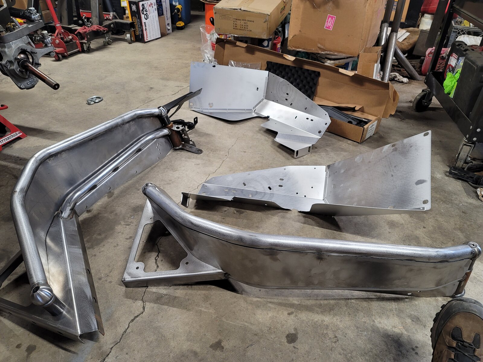

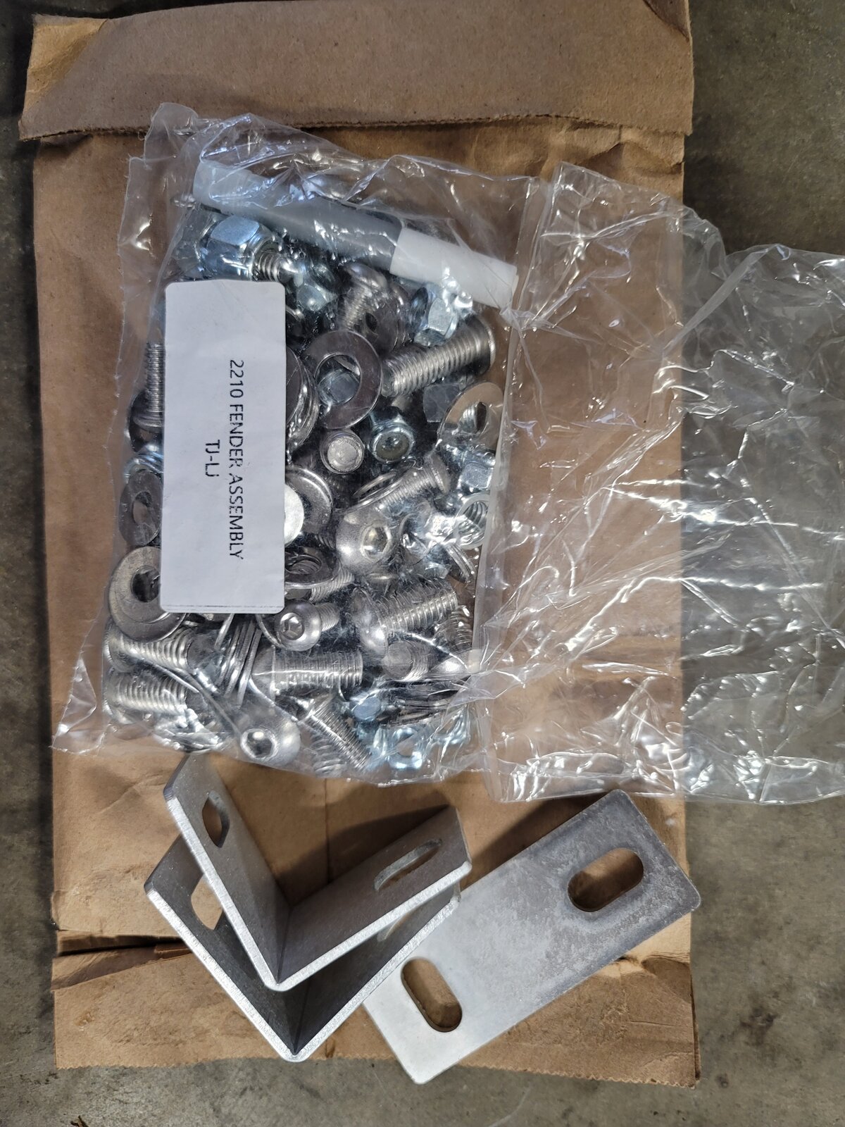

I unboxed the Metal Cloak front fenders and flares.
MC even includes a windshield banner & stickers with their orders. And this is without having to leave notes asking for them.
And get this....... They even have INSTRUCTIONS that you can view and read. Gee I don't have to search the web and find other peoples install threads to find out how to install a product? DAMN you'd think they wouldn't be hated so much.

The predrilled inner fenders and space for the stock airbox is also a bonus.
If I still had a stock air box that might be nice but I haven't seen my stock air box for years. But yes the predrilled holes are nice. I do wonder how much I'm going to move stuff around.

I can't tell you the number of times I took that inner fender out and put it back in nor how many times I said I was CLOSE but finally I really am CLOSE. I'm going to install the bolts in the morning and see where else I might need to trim the inner fender.
