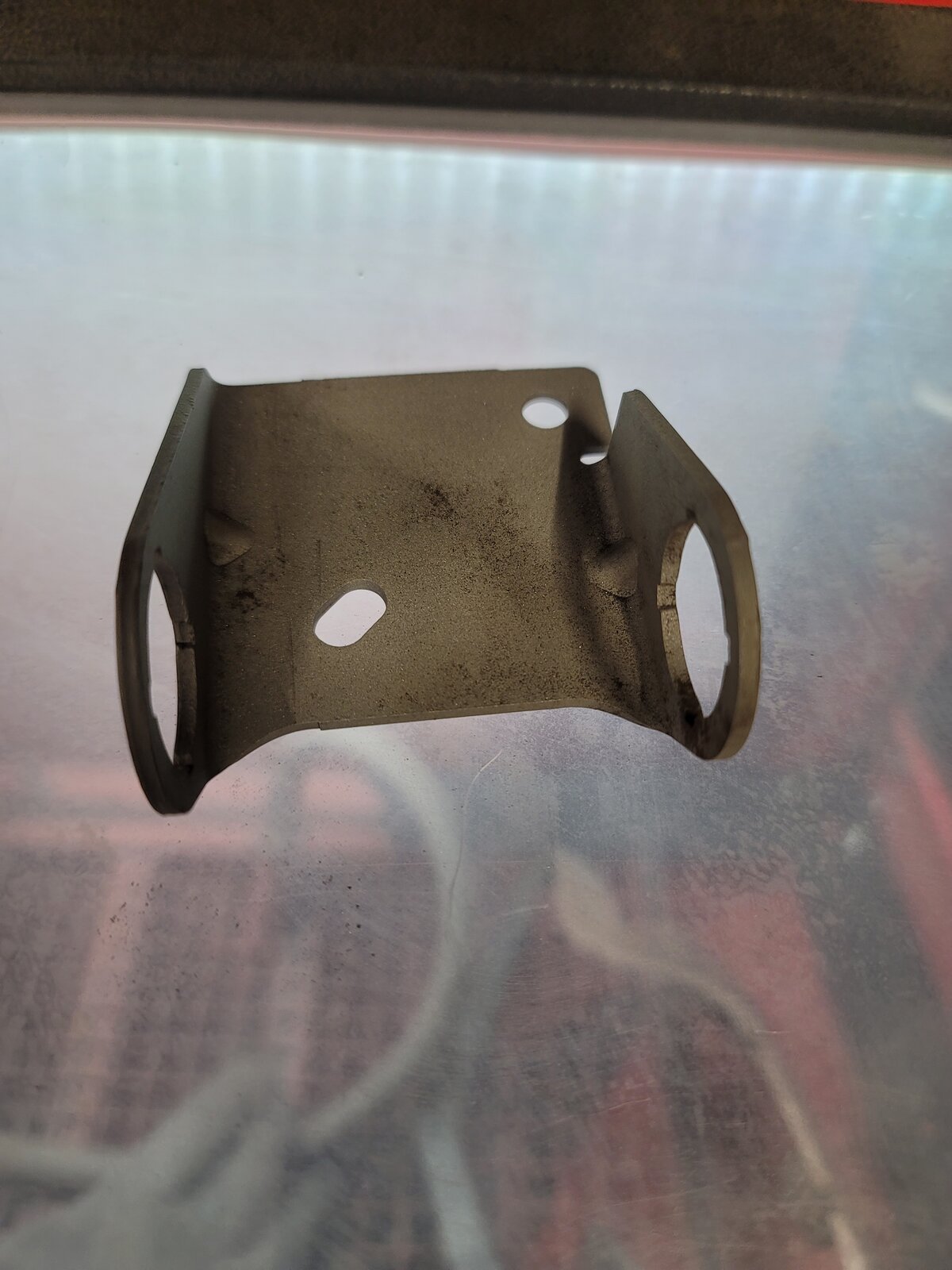

I started with the gas pedal mounting bracket. Forgot to take a picture of it before I cleaned it up. But trust me it was all rusted up for some reason.
This is the cover that goes under the steering column.
And then the gas pedal it self.
Everything all cleaned up. I'll get these wiped down and spray them with some paint. Hopefully they won't get all rusted up again. I'm still not sure why they are so rusted but they are cleaned up now.

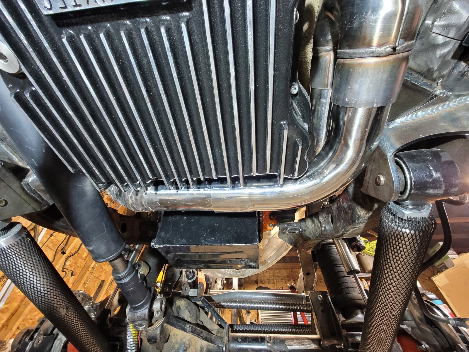

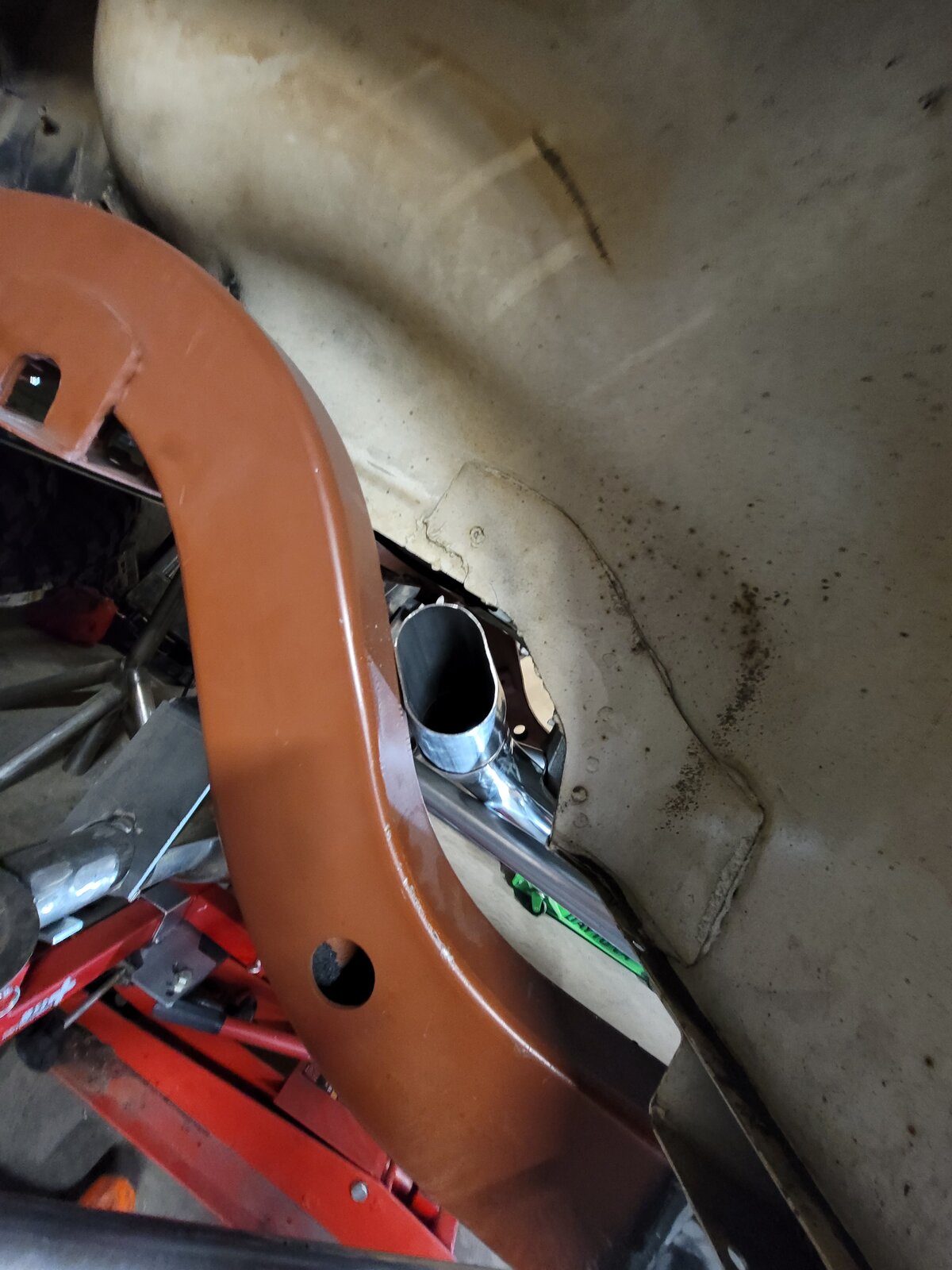

I had forgotten to take pictures of the drivers side exhaust pipe before I'd installed it yesterday so figured I'd take them today. Once I get the final version done I'll take a few more.
