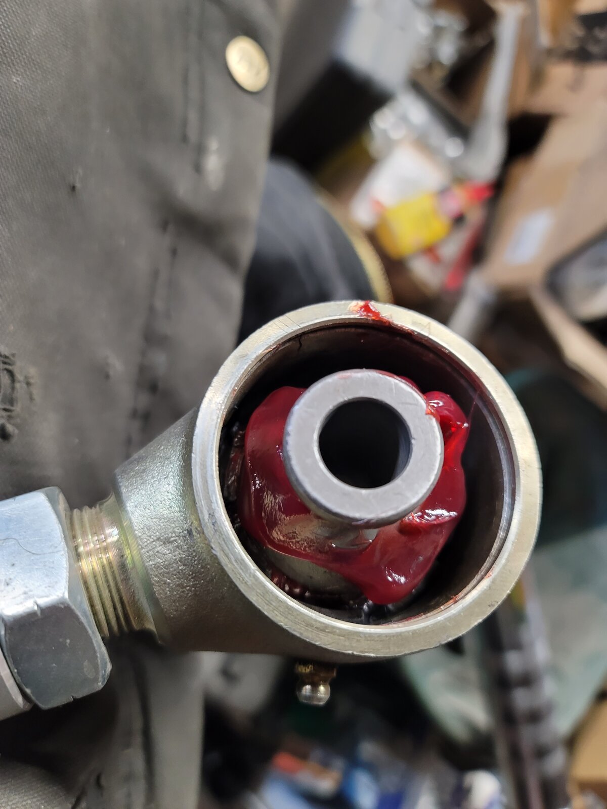

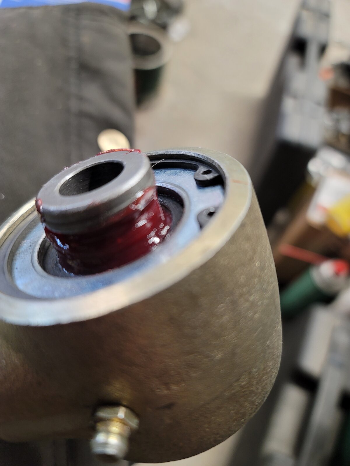

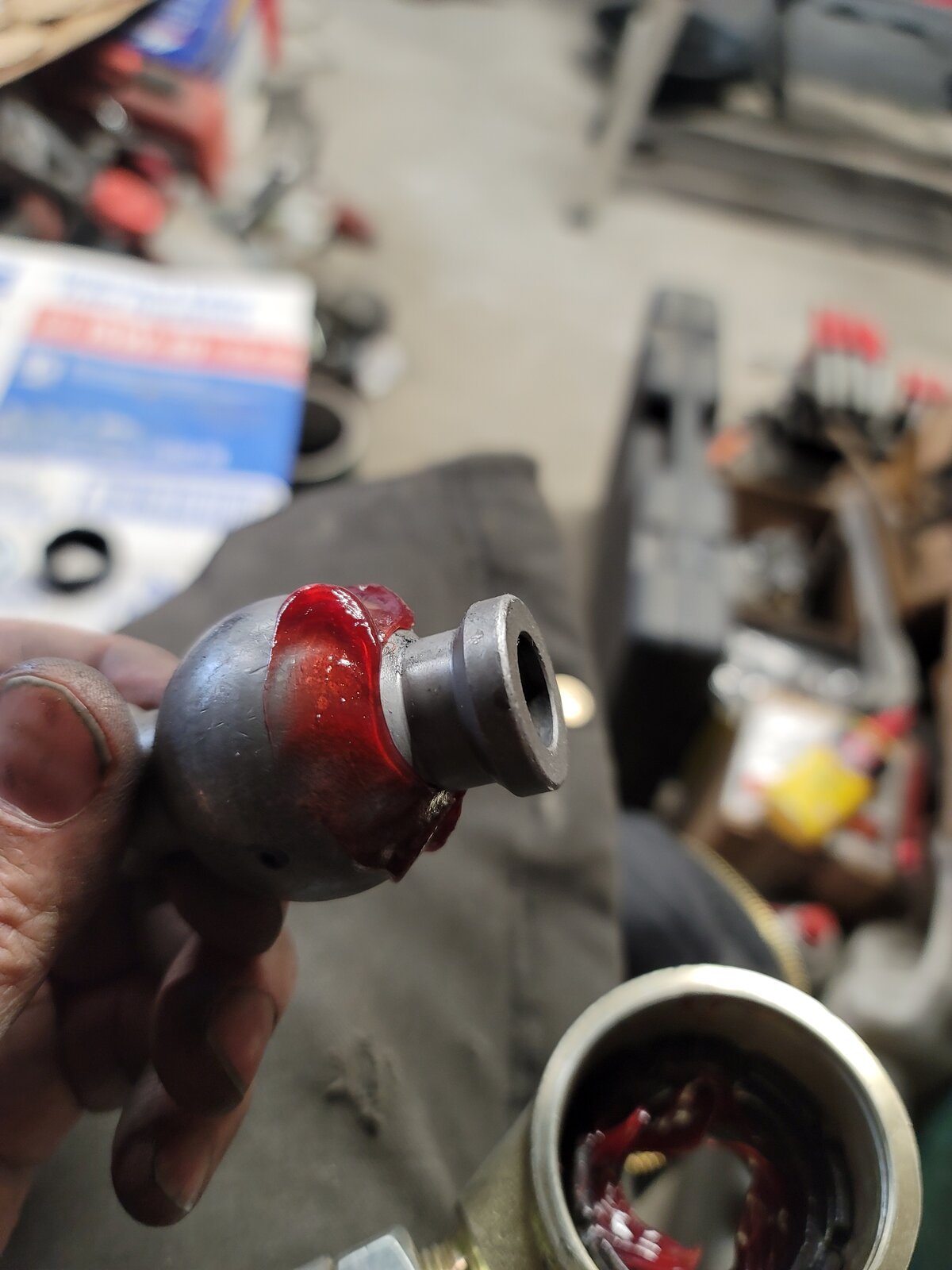

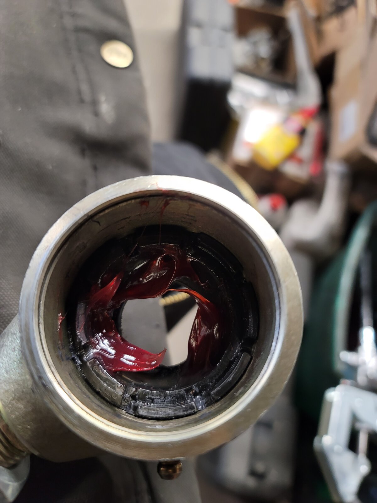

Well not knowing how much I'm adding this amount. The one thing that has become very evident to me is that I need new snap ring pliers.
Then add some to the ball.
Then do the other side.

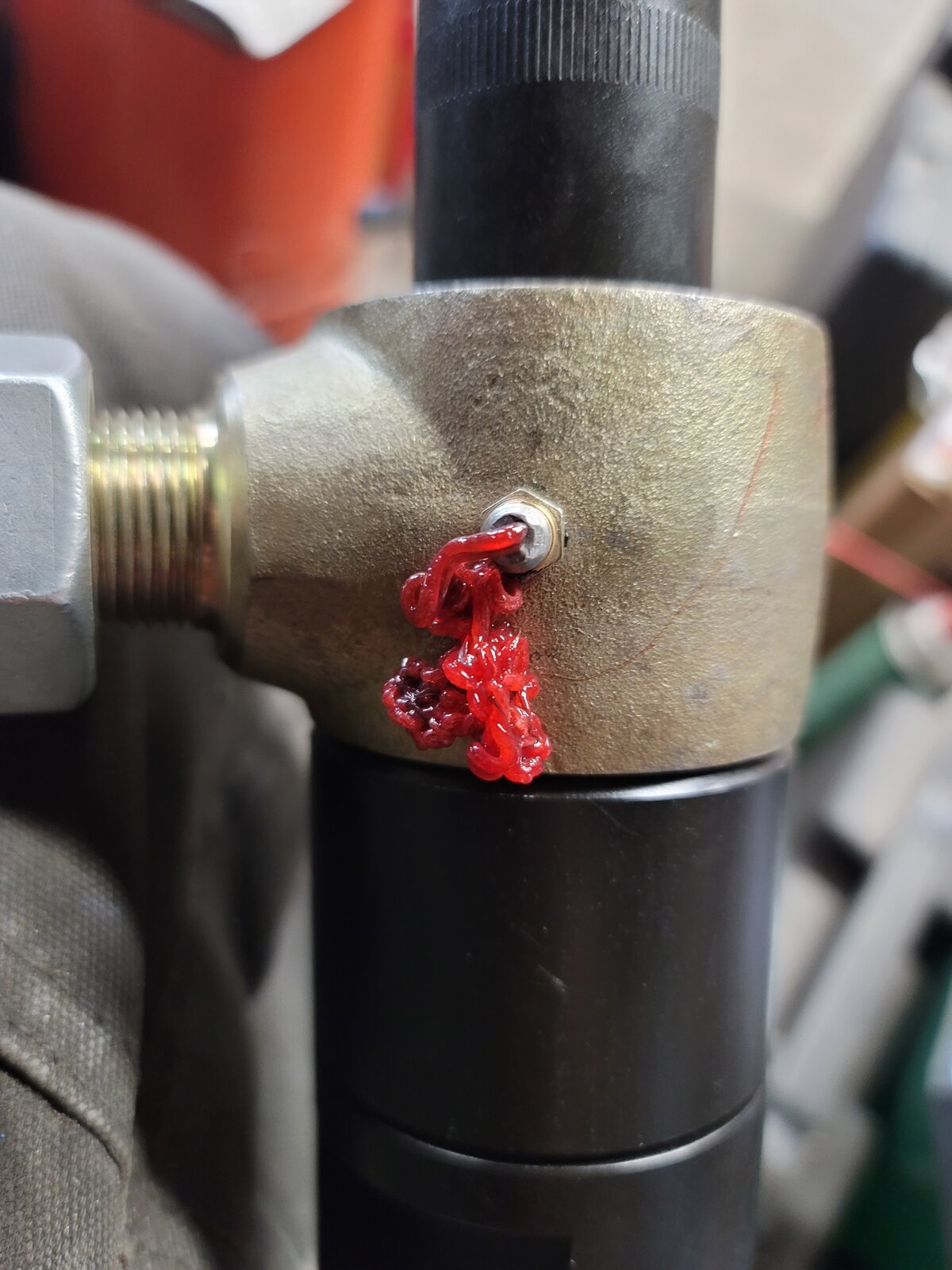

And I get about this much out on reassembly.
So far I've only lost one snap ring. Flew across the garage and found it in the bottom tray of my service toolbox.

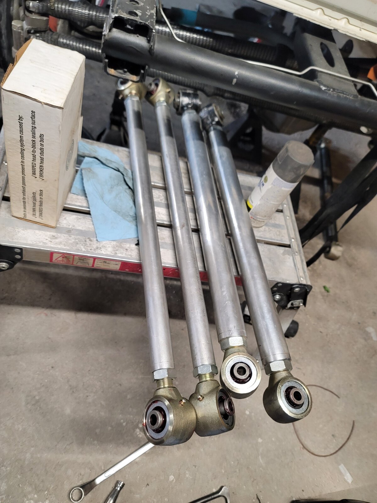

I just did JJs on a full set of new Savvy arms & Currie TBs & TB mounts on axle before they all go on the Jeep. Mine were about as dry as yours and I did about the same level of grease as you. Whatever isn't needed in the joint will be outside to wipe off... Better more to wipe away than not enough.
Do yourself a favor and pull the zerk. Then make sure to line up on of the notches in the urethane race to line up with the zerk hole.
NOW you tell me. 😒
If you pull the jerk aren't you going to get even more grease back out?
That one just must have been lined up?
6 joints greased and done. I'll do the other 4 when I get done with the front axle.

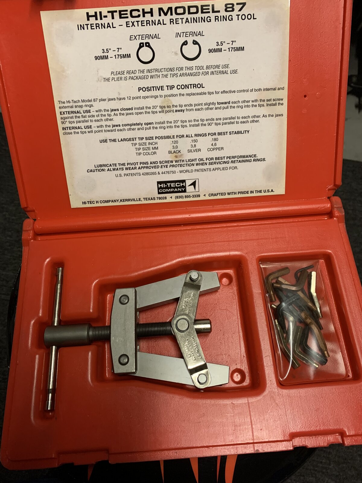

What's everyone's choice for some good snap ring pliers? I'd rather get some before I do the next set.
Best heavy set that I know of.
I’ve done 5 1/2” snap rings with them no problem.

My JJ's zerks also pushed out grease about 50% of the time on initial grease. Based on community posts from many knowledgeable sources, including @mrblaine, I don't think getting the zerk is getting grease in the joint. The zerk is there to counter crappy counterfeit products that 'said' you need a zerk... Currie made the joint tool, from my opinion, to do the job right.
Reactions: Wildman
I'll most likely just replace them all with plugs. I did have a few that took grease after I reassembled them but how well it spread around the joint is anyone's guess. I've seen his comments on this and it was to appease those who wanted the zerk.
I've thought the same on plugs...

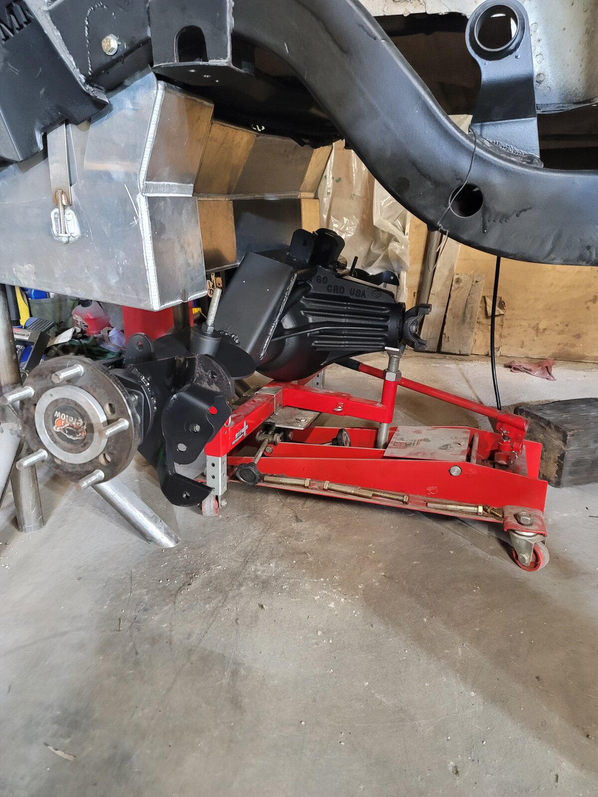

Got the arms installed and will get it centered tomorrow also.
But damn it does look good. Might even throw the rear driveshaft onto it to check that out and make sure my measurements were correct.
