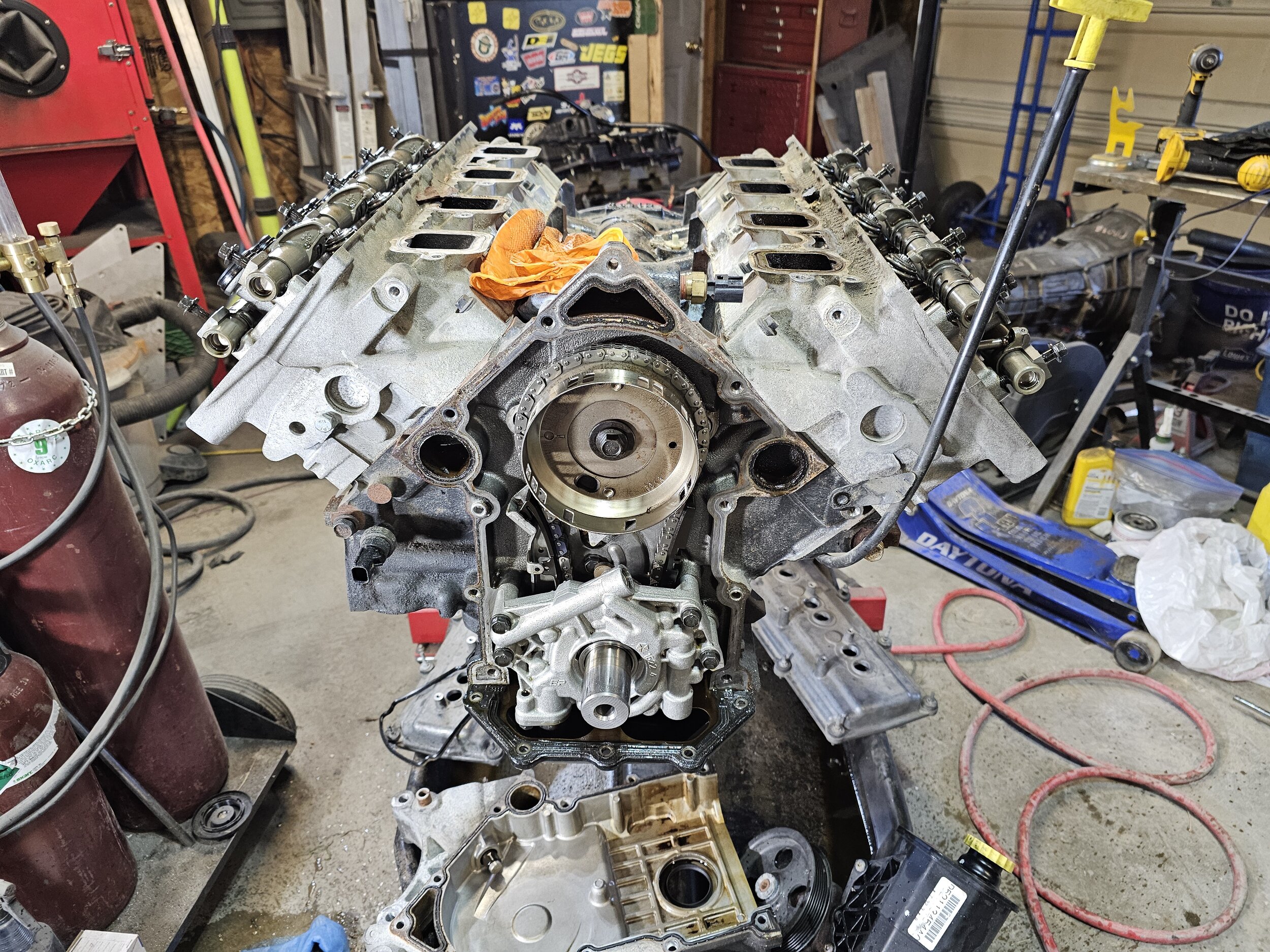

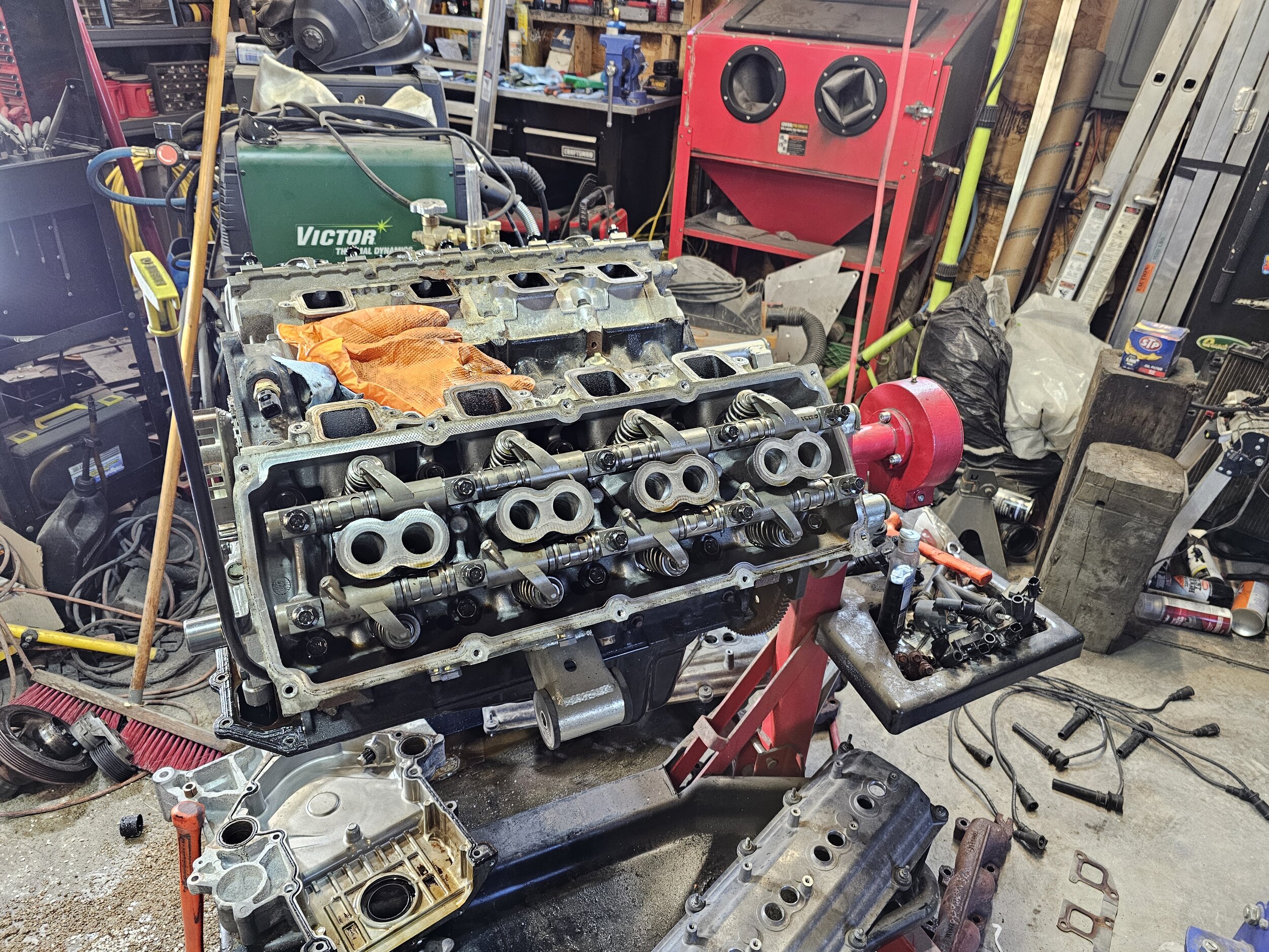

Well I didn't stop like I'd said I would.... Got the valve covers off & the timing cover & water pump off.
Rocker arms are ready to come off & I'll pull the pushrods and then get the heads ready to come off. Yes I'm not just going to drop the stock engine into the Jeep. There will be more to come once the parts arrive. Plus this gives me a chance to clean the block up and make sure all the gaskets are good.

Anyone who knows me KNOWS I can't ever leave things alone... Plus the stock heads had the dropped valve seat issue so I wanted to get rid of that possibility... Which means either Edelbrock heads or??? Ya'll just have to wait and see what's gunna happen.
