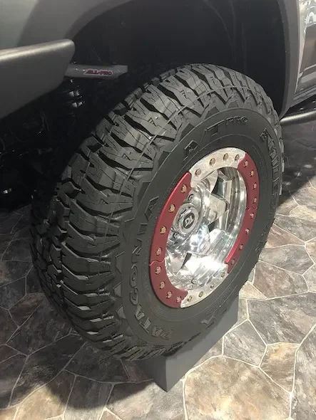

I've run both the Wildpeaks and KO2s. Tire performance is pretty much identical. On the plus side, a set of Wildpeaks can be picked up cheap. They came on JLs and people offload them all the time. Of course these are 17" tires, but $800 to $1000 will get you a set of 5 JL wheels and tires like these. This set was 285/70R17. The only major difference I'm aware of is the KO2 will have a 3 ply sidewall, vs the Wildpeaks 2 ply.
vs 315/70R17 KO2
