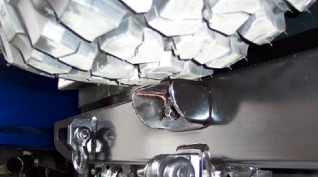

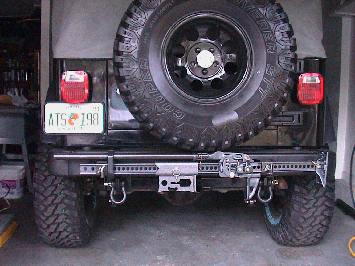

I added about 1” of snubber spacers for my stock spare just adding the MorRyde hinge kit. When I upgrade to ~33”, I’ll be able to pull the added spacers off.
Mine would not fit without hitting the bumper, but then I added a 1.25 inch body lift, so it fits now. Most definitely will need to remove/add spacers to the snubbers and to the 3rd brake light... I just used 1" press in LEDs installed between the wheel and carrier at the 2 lug holes not used on the carrier.

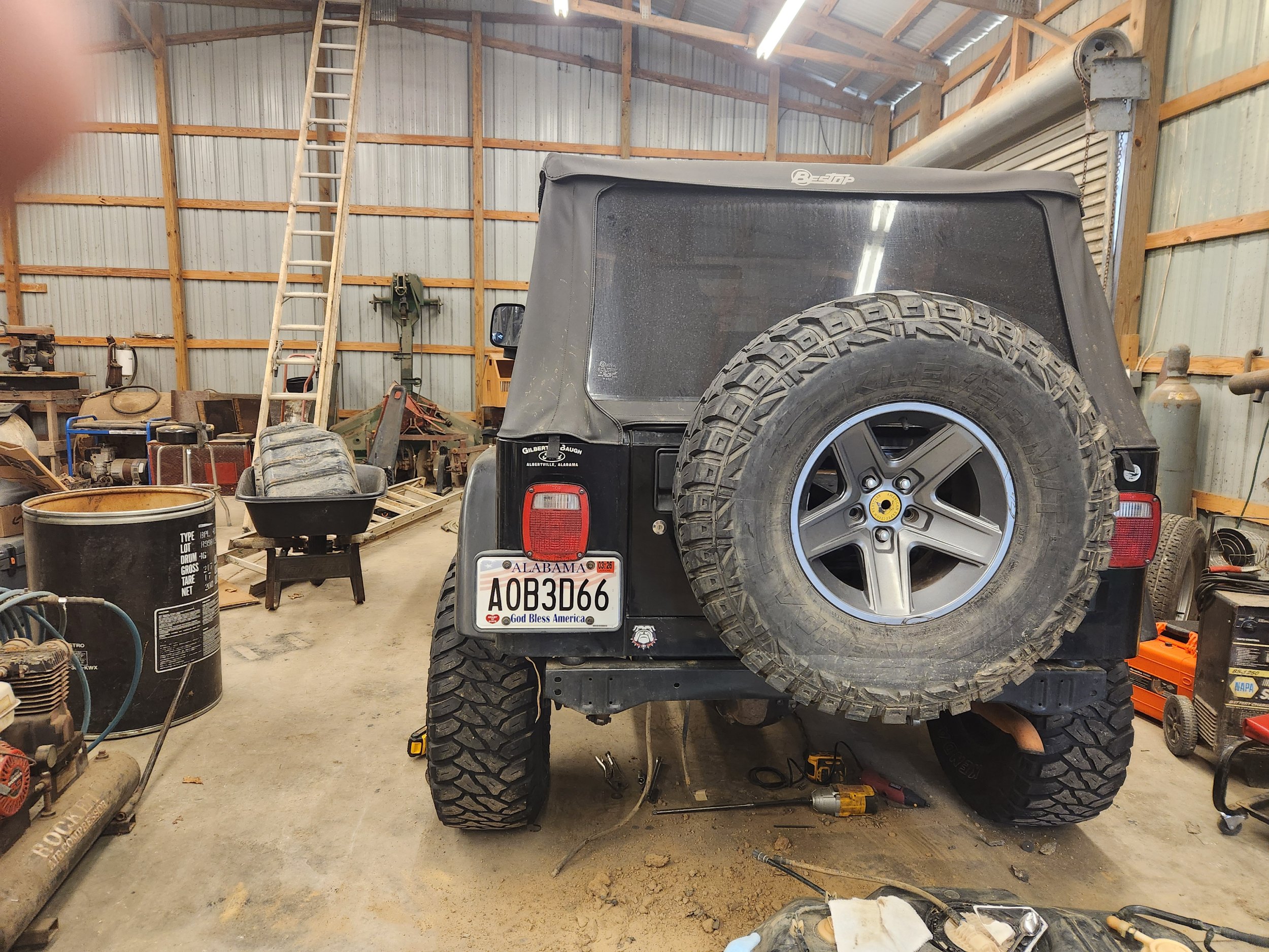

This is a 35x12.5 on a factory carrier mount mashed into the factory snubbers with no extension. 🤫
