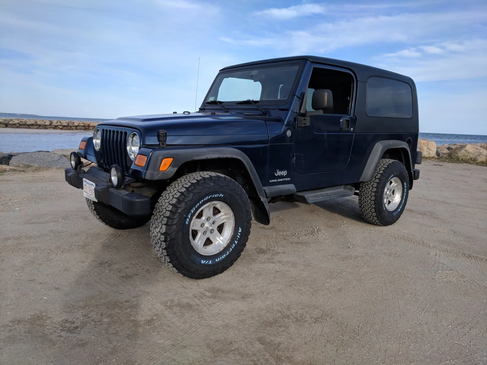

I have a 2004 unlimited with the 3.73's and I just put on 33's with the 2 1/2" OME lift and didn't notice much of a difference in driveability. The 33s are only a 10% increase over the stock 30s. To keep your RPMs the same you would only need to change your 3.73s to 4.10s (a 10% increase). I did go with the BFG KO2 33x1050's since it's a daily driver first and only an occasional off roader. The narrower tires are better on the street and will put less wear on the front end.

How are you making the 10% calculation? If you’re making it based on tire diameter, I.e. a move from 30” to 33” inches, that’s not what is being calculated.

The 10% is based on diameter as well as my speedometer. With my speedo at 60 mph on the highway my gps says 66. 10% difference. A 30' tire has a circumference of about 94", a 33' tire is about 104". So every revolution of the tire your travelling 10" farther or again about 10%.

For one, you haven’t figured in weight.
