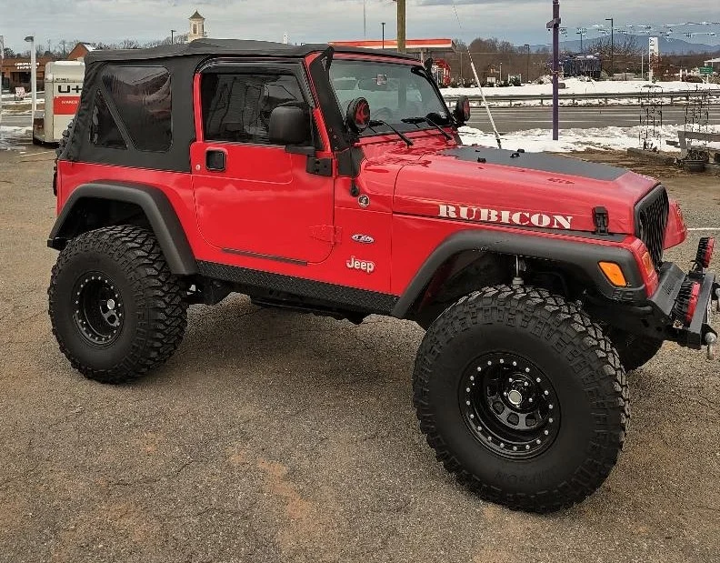

I couldn't justify the cost of the windshield guards and went that route. I thought about just cutting the tabs off though. They cover my dent well and gave me a place for my lights for $25.
Never considered that.. hmm. Some folks on here scoff at risers, but if you need them..

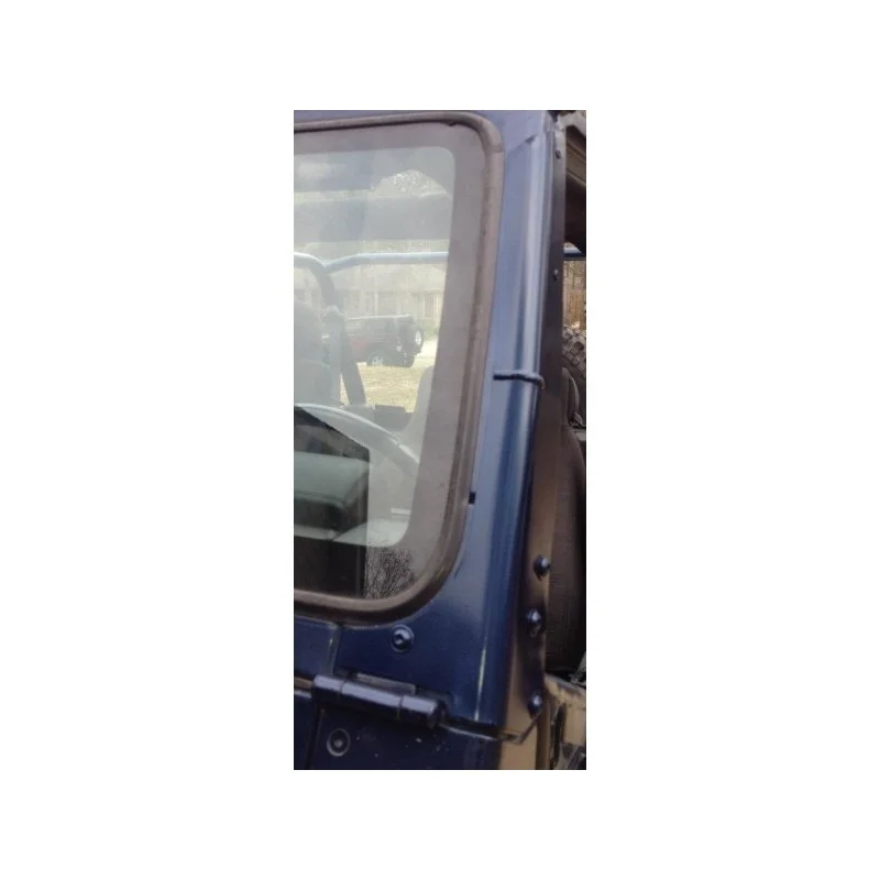

The UCF are 2 piece (2 "planes" for fitment) and there's an obvious seam, which may or not bother me.

Genright talks about grinding the welds so they may be made the same way or similar, just with the weld grown down to not be visible.
I'd rather have aluminum, myself...maybe go UCF and grind the welds down yourself?
I did not have any welds to grind on my Genright ones... they fit perfect form the get go and as listed above they fit to the top of the frame.
I went steel over aluminum just in case I decided I wanted to weld on light mounts or something later down the road... 2lbs different didn't seem like much.
Yeah, their website says they grind the welds so they don't show.
Aluminum would be less about the weight for me and more about corrosion.
