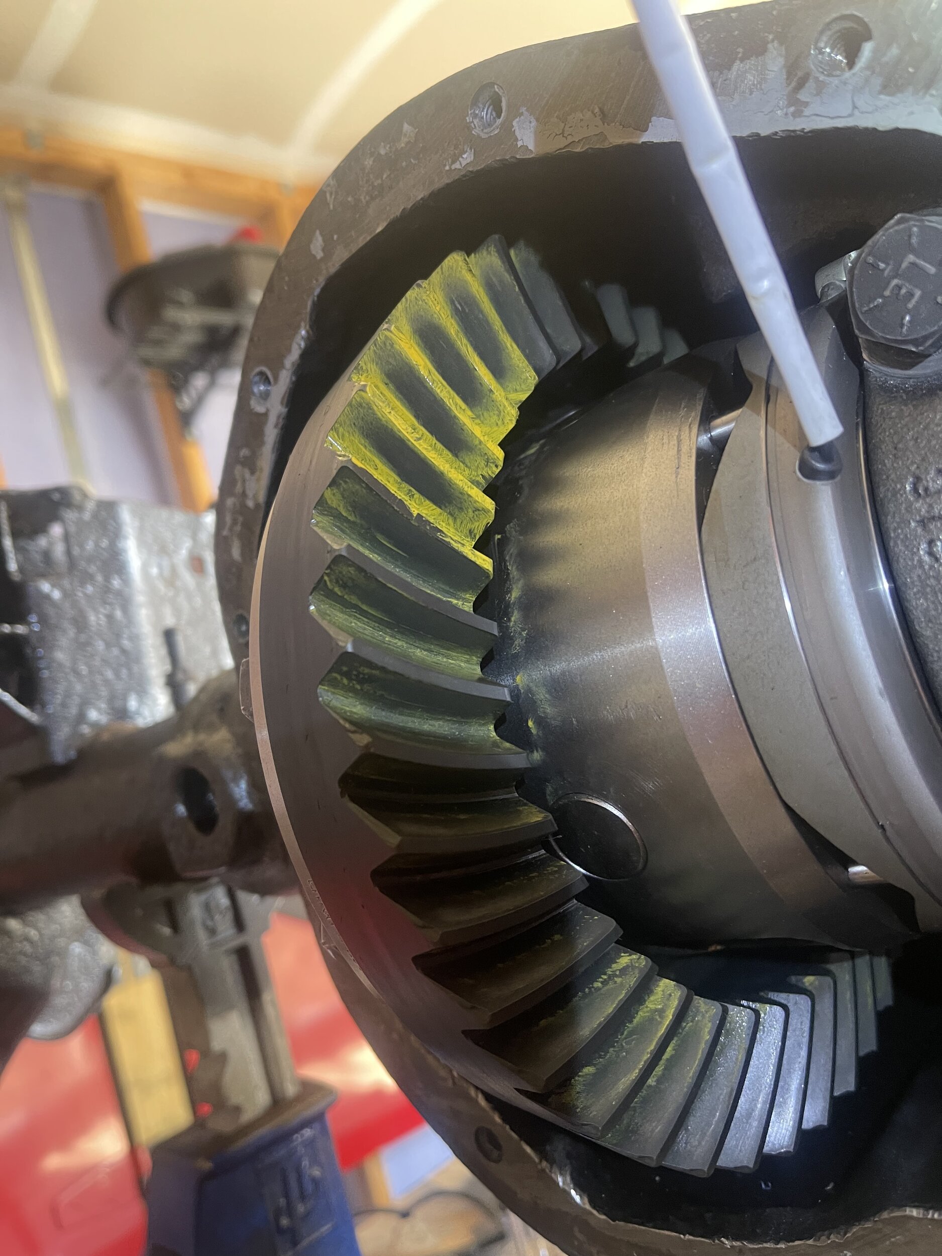

Took everything apart and cleaned it up. Bought some backup parts to compare against.
Turns out my “new” inner pinion bearing from Amazon was a dud. If you compare it against same PN/manufacturer to a bearing from rock auto they are not the same.
Difference is tiny, but it’s enough to cause these issues.
New (good) patterns coming soon
last time I buy Amazon parts

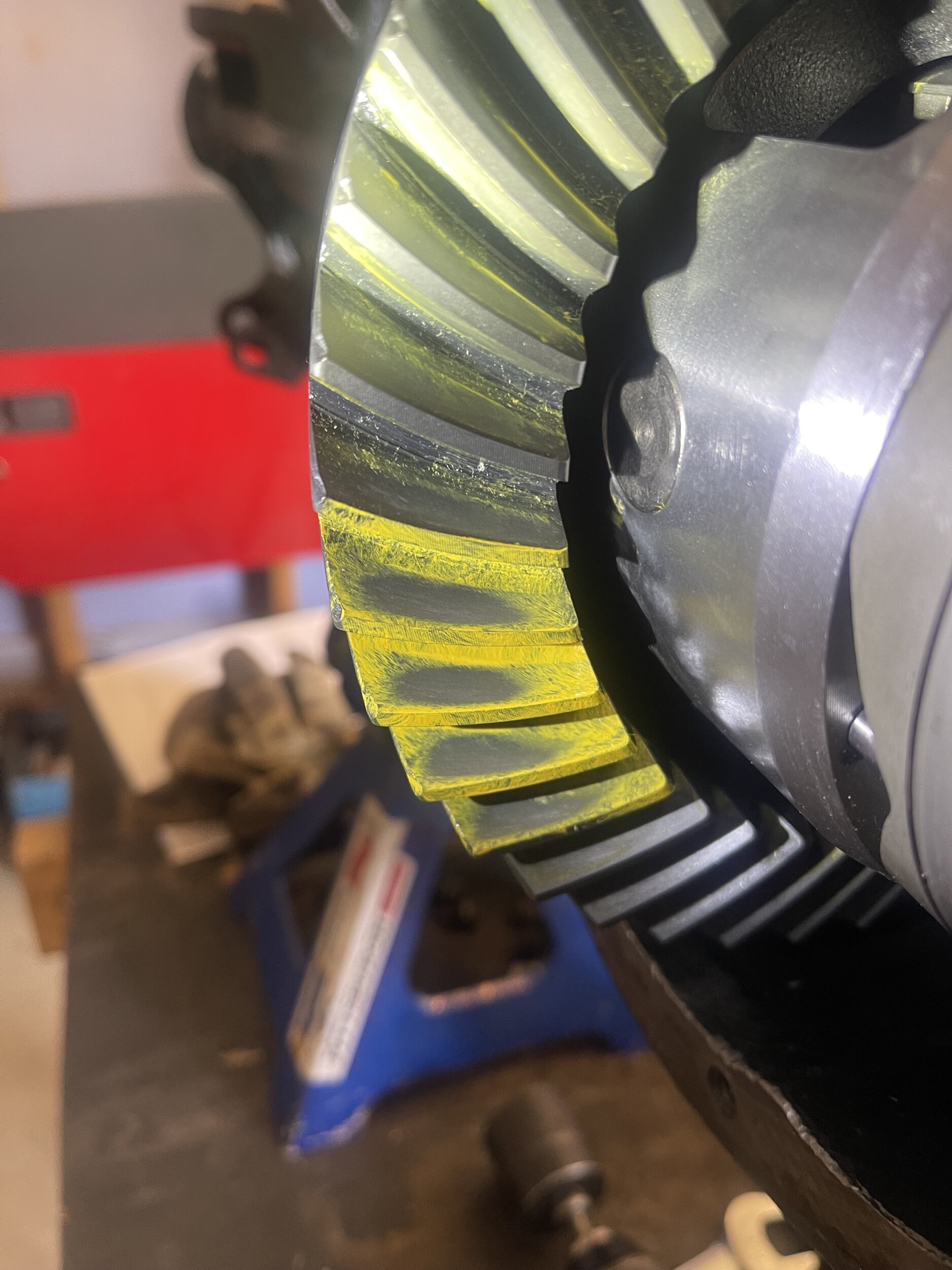

here’s pattern I’m pretty happy with. These are Revolution 5.13s. .042 PD with 8 backlash.
I tried everything I could to get the us standard gears to a runnable pattern and gave up.
Revolutions took an hour and a few adjustments.

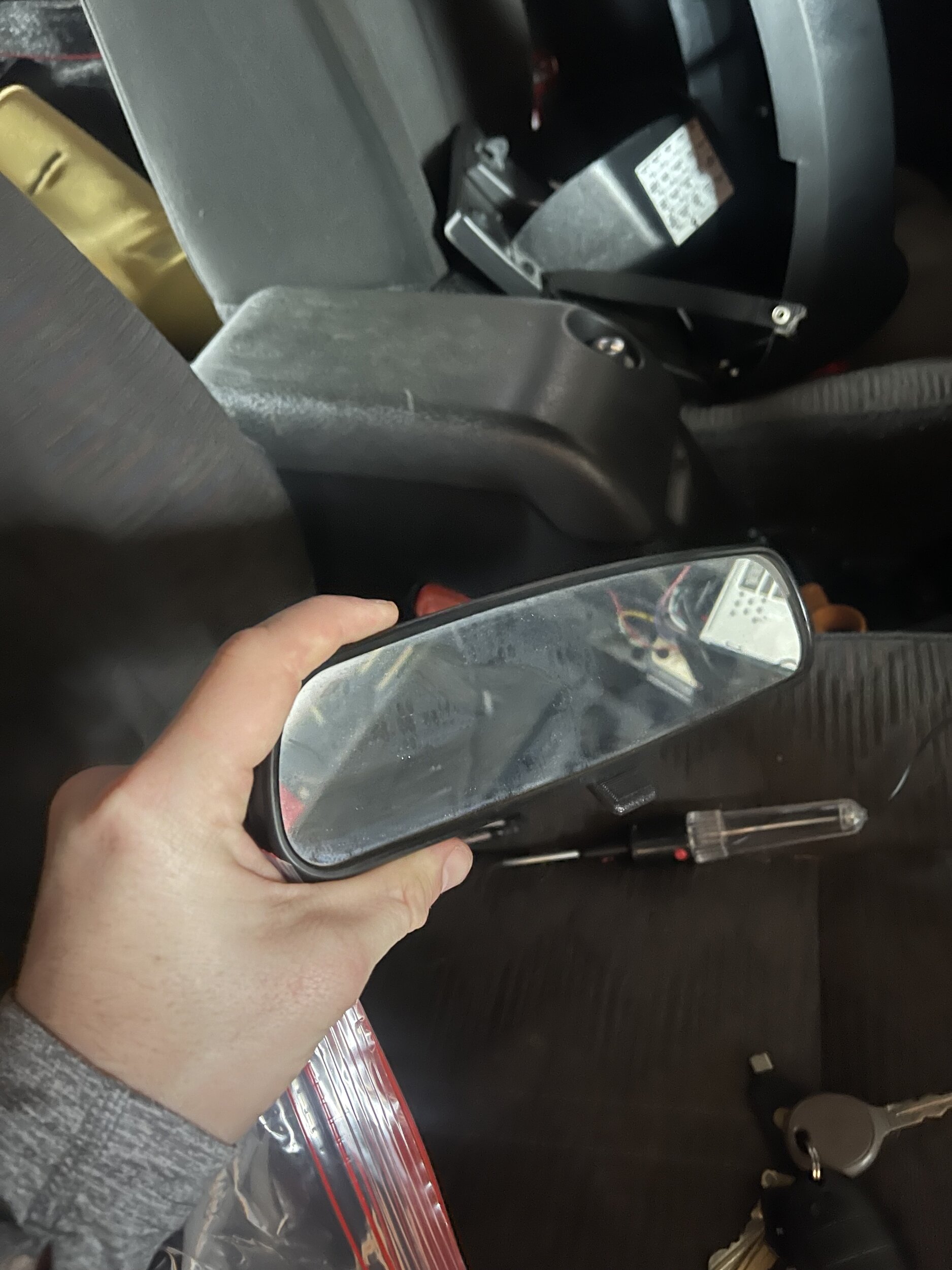

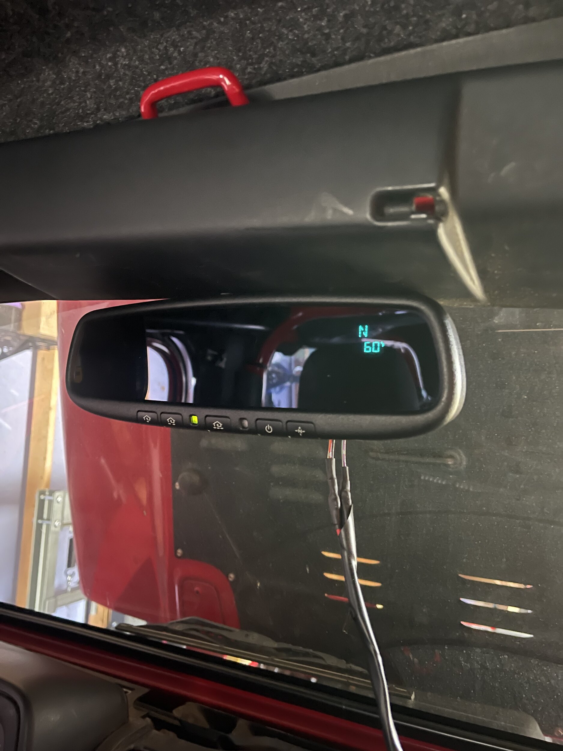

I’ve been working non stop and Jeep projects had been on hold. This morning I had some downtime and wired up a new (to me) rear view mirror.
Gentex 453 from a Nissan (with home link).
4 wire job + some tedious running of wires from grill where temperature sensor is mounted to glovebox area where my wires are tucked.
Took about 2 hours to do right. 30 min to test and confirm it would work. Old mirror pictured because my wife didn’t notice the difference.

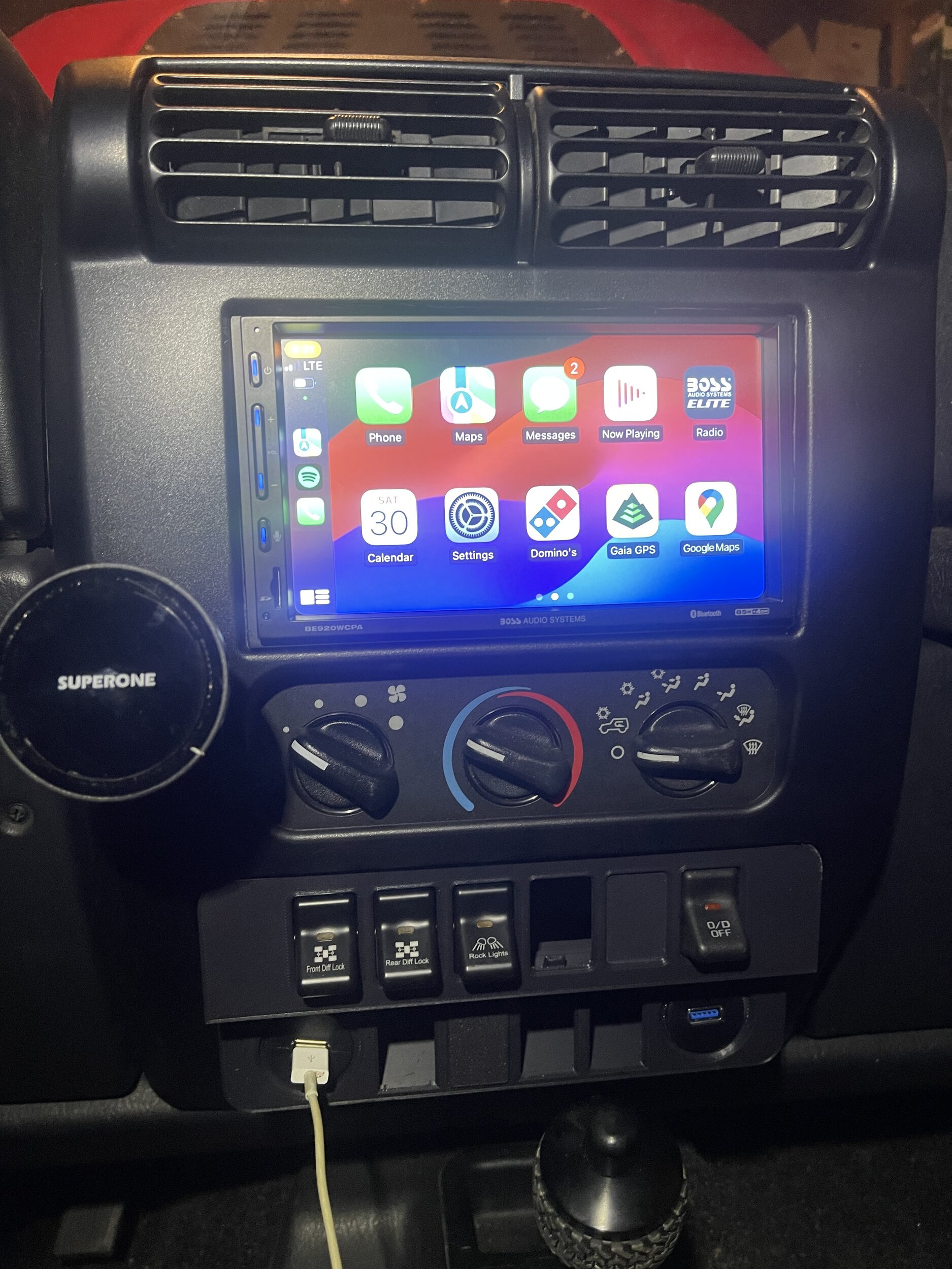

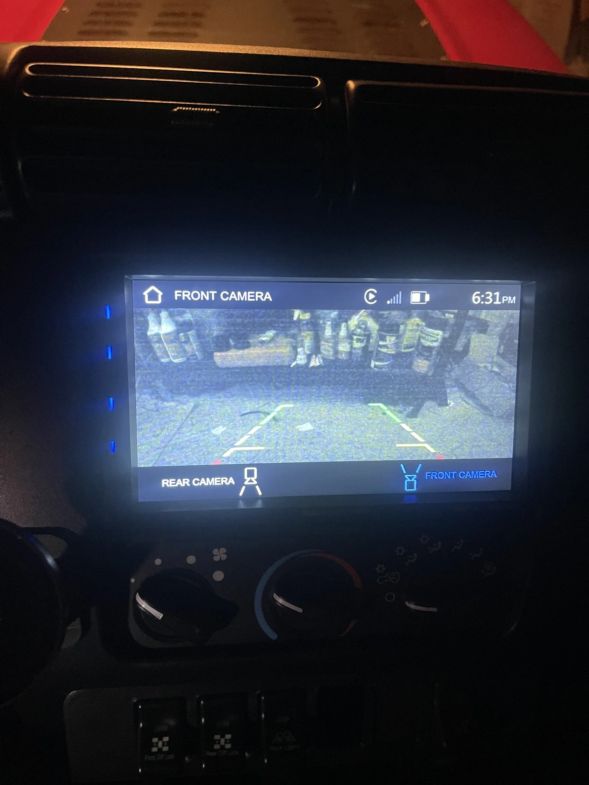

This weekend I wrapped up a few projects that have been lingering.

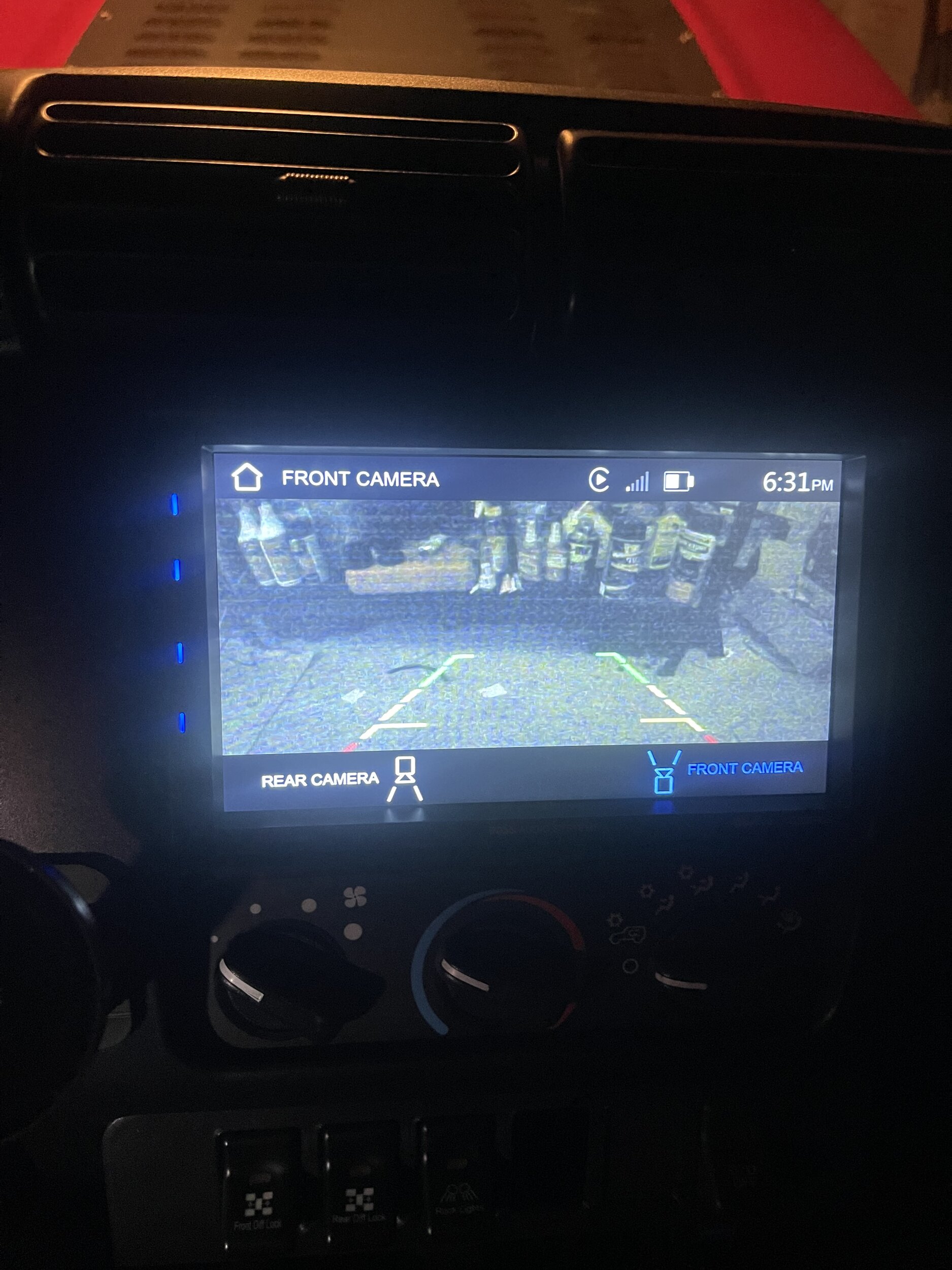

Double din radio with CarPlay

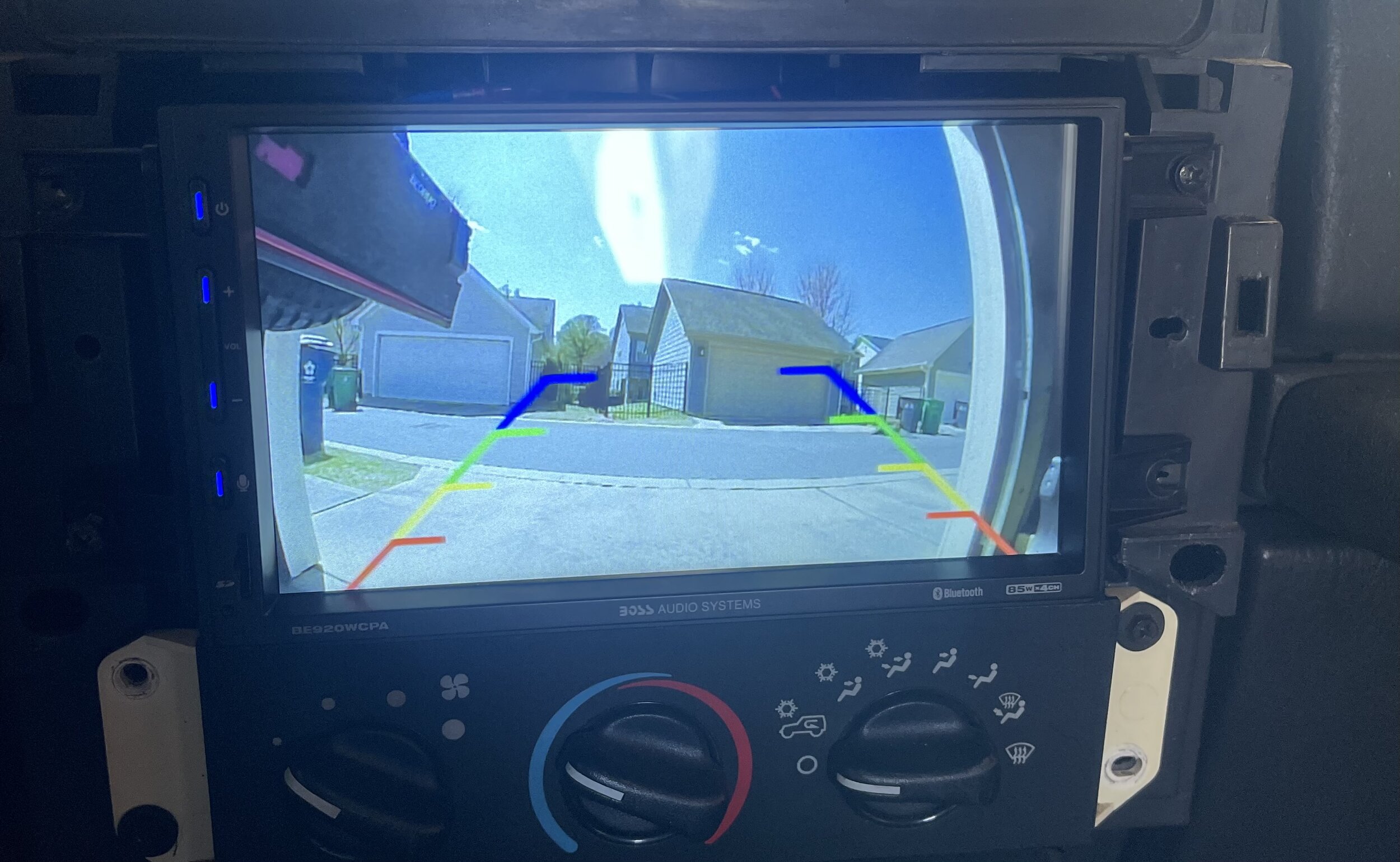

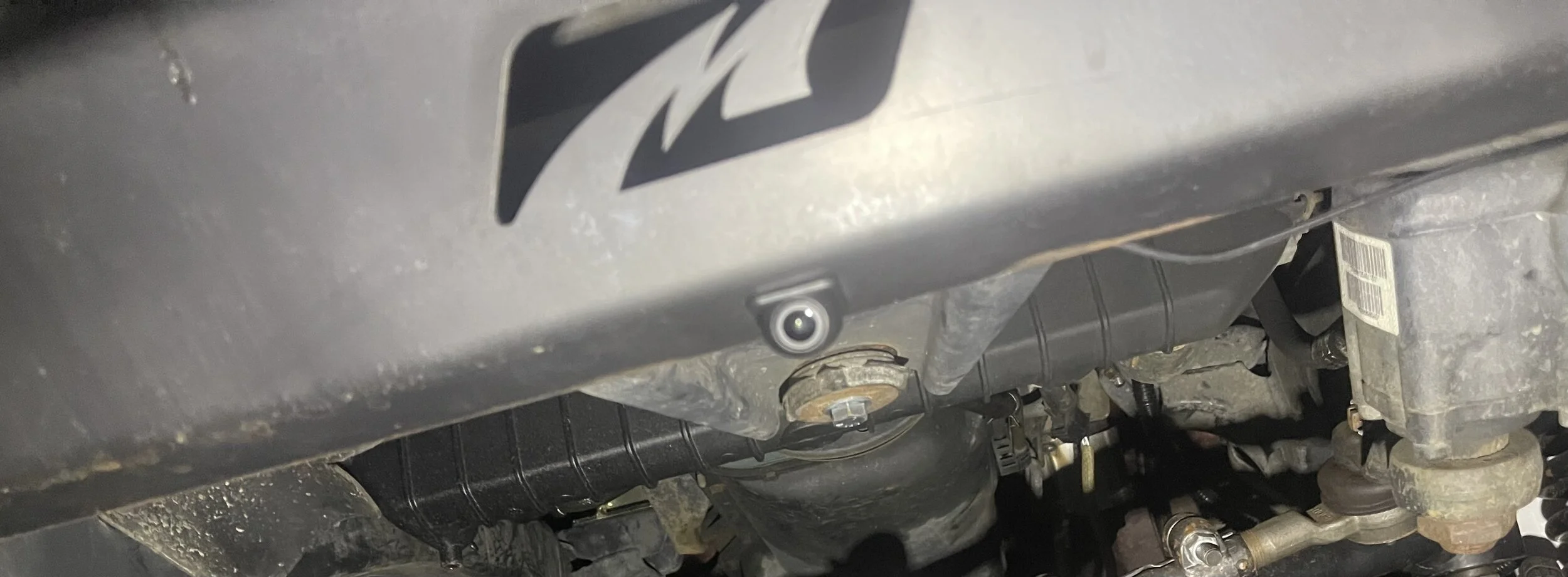

Front/Rear view camera

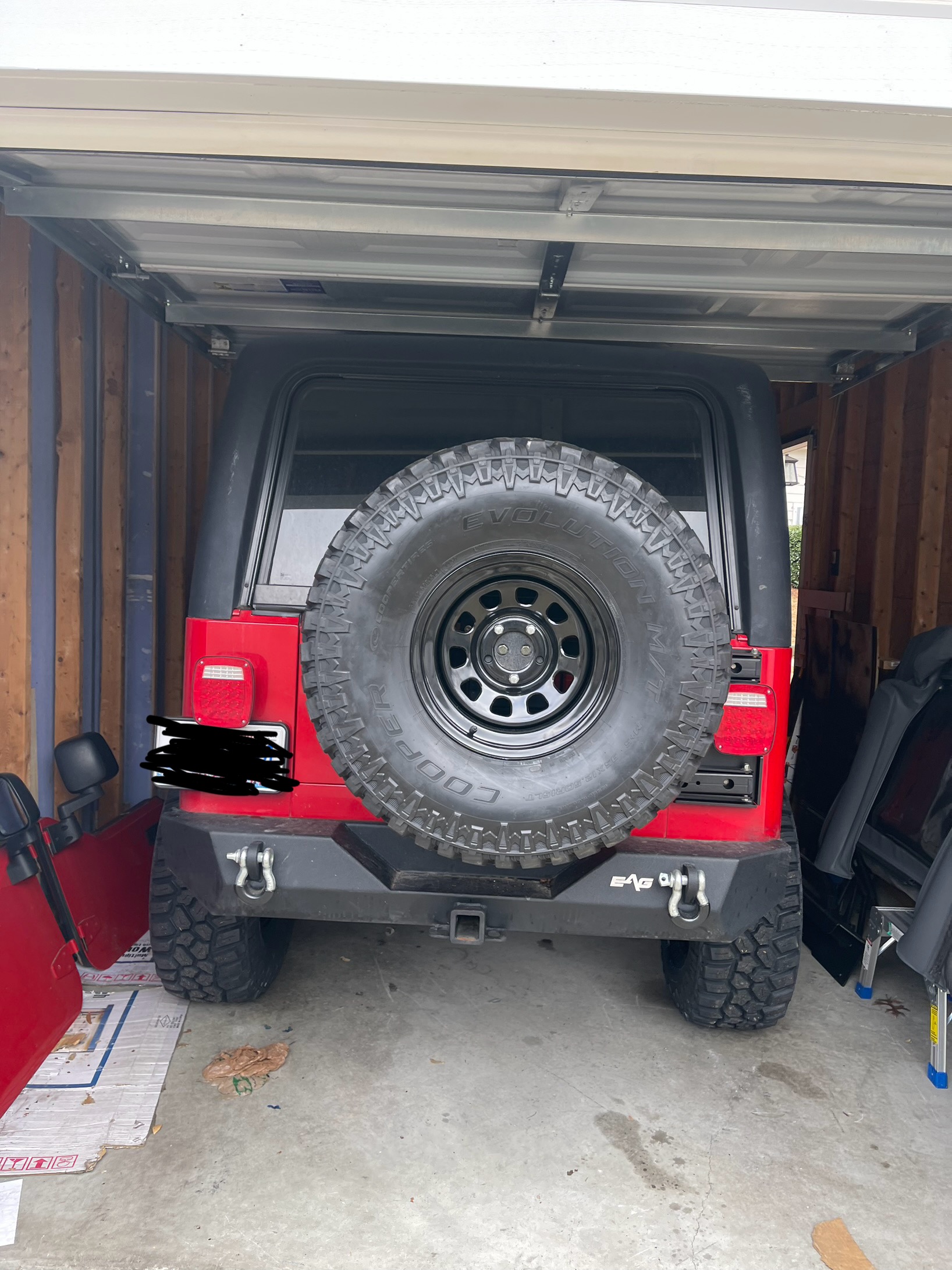

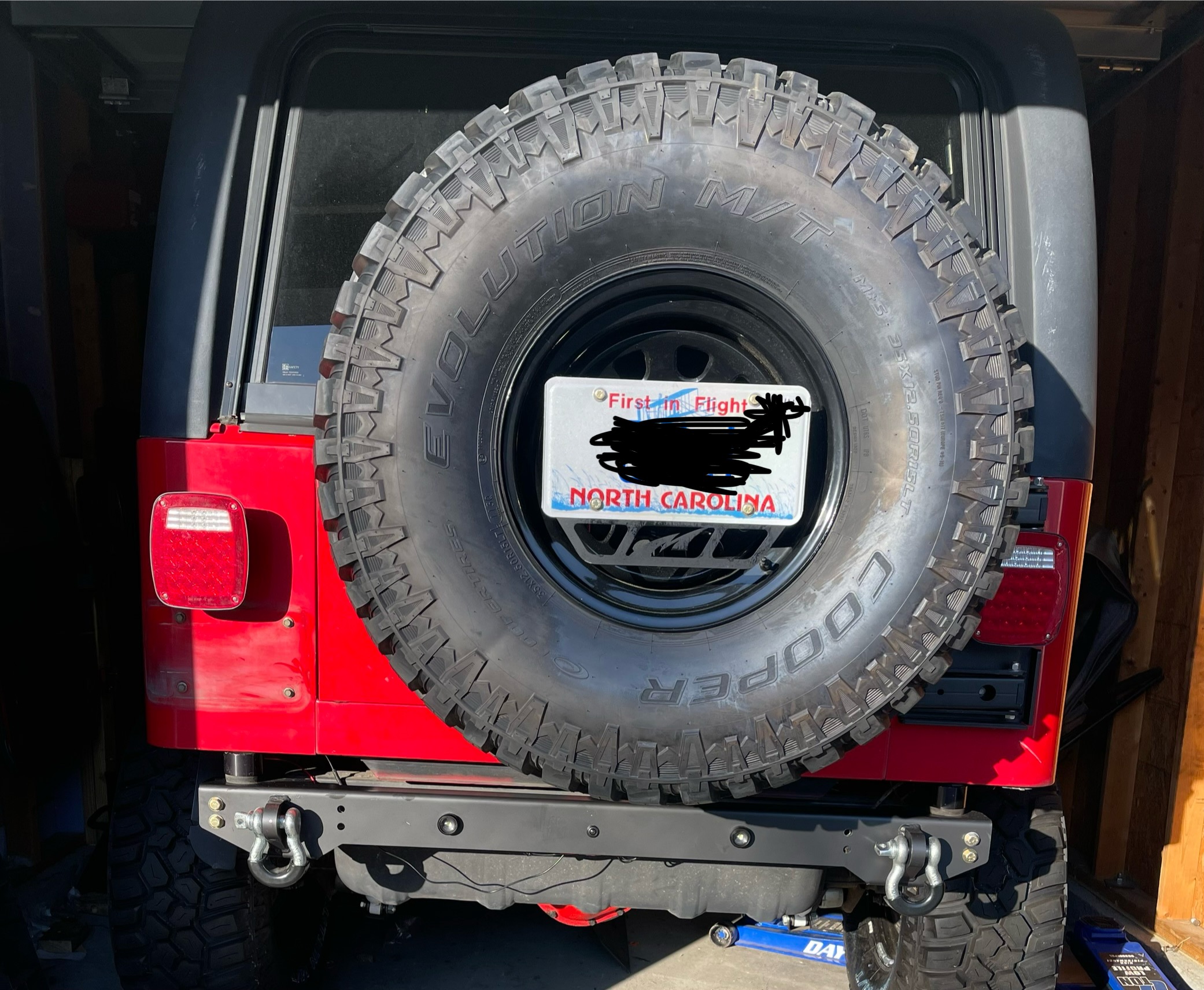

Moved license plate to spare tire
The double din radio didn’t want to fit. Crutchfield says it does, the dash kit I got says not. Nothing a little dremel couldn’t fix
I’ve always disliked the rear bumper that came with my LJ. it was fine while I worked on other parts of the build, but it was time to go.

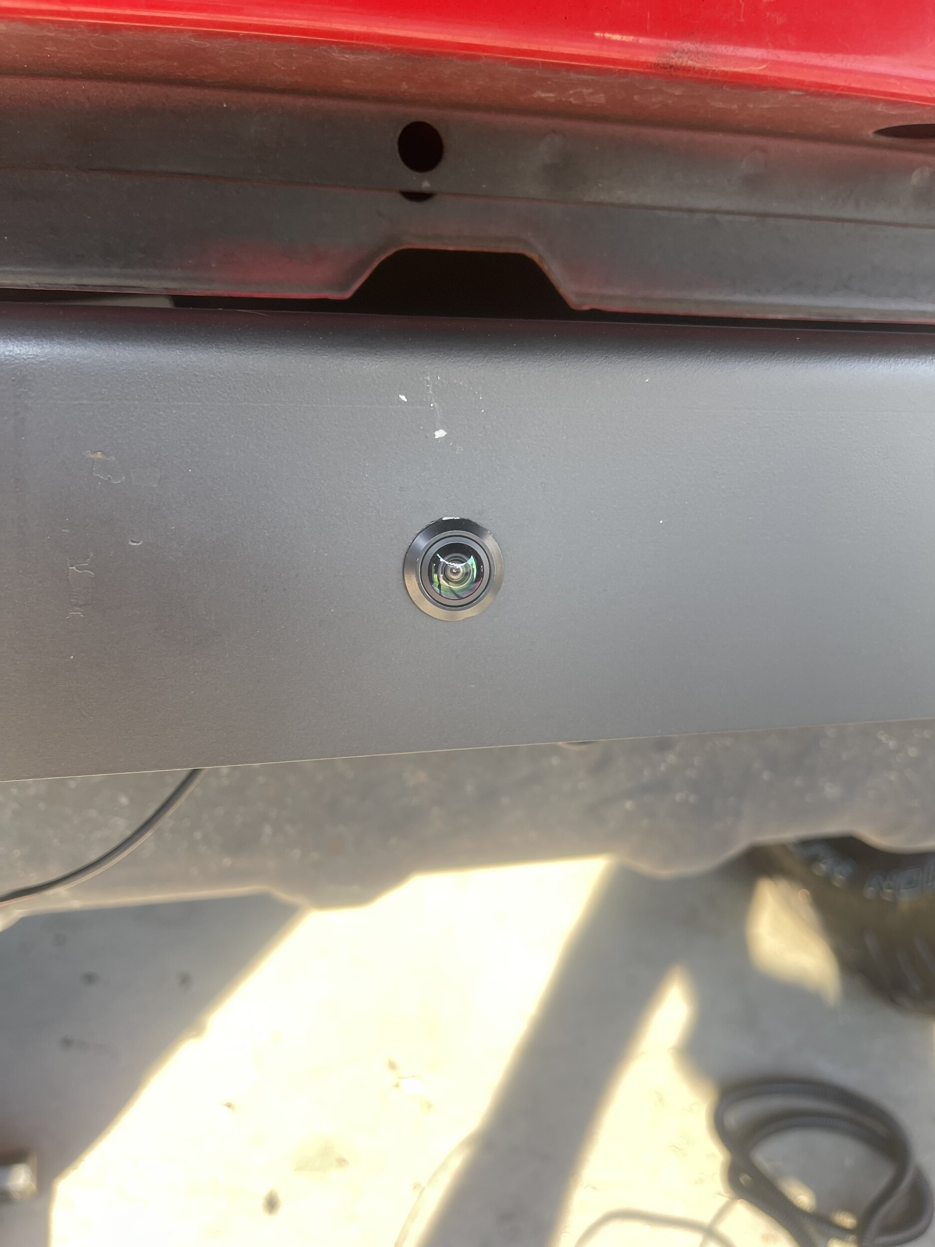

I grabbed a genright TJ bumper and flush mounted my rear view camera. I grabbed the frame tie in kit and reverse LED kit as well.
As you can tell, I haven’t tucked all the wires away at rear bumper yet. I’m still flushing out a few details there.
I have license plate lights to wire as well, but haven’t gotten that far yet. That’s next weekends project.
An astute eye might notice the new switch panel under my AC. I have 3 new items being wired in here to fill most of the gaps. Just haven’t finished them yet, so slots sit empty right now
