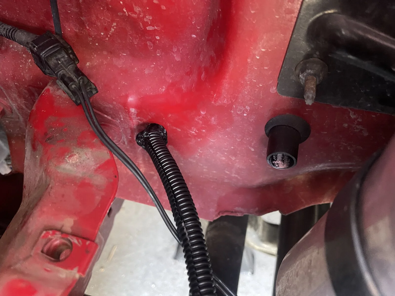

Forgot to upload pictures few weeks back but I was cleaning Jeep today (as you can tell - it needed it) and saw this.
I went with Spod approach and drilled a new 5/8th inch hole on passenger side of firewall. Threw rubber grommet and wire loom over Eaton wiring harness and ran to engine bay.
I haven’t wired the rear Eaton yet but might enlarge hole just a bit to fit that second harness through. Haven’t gotten that far yet.

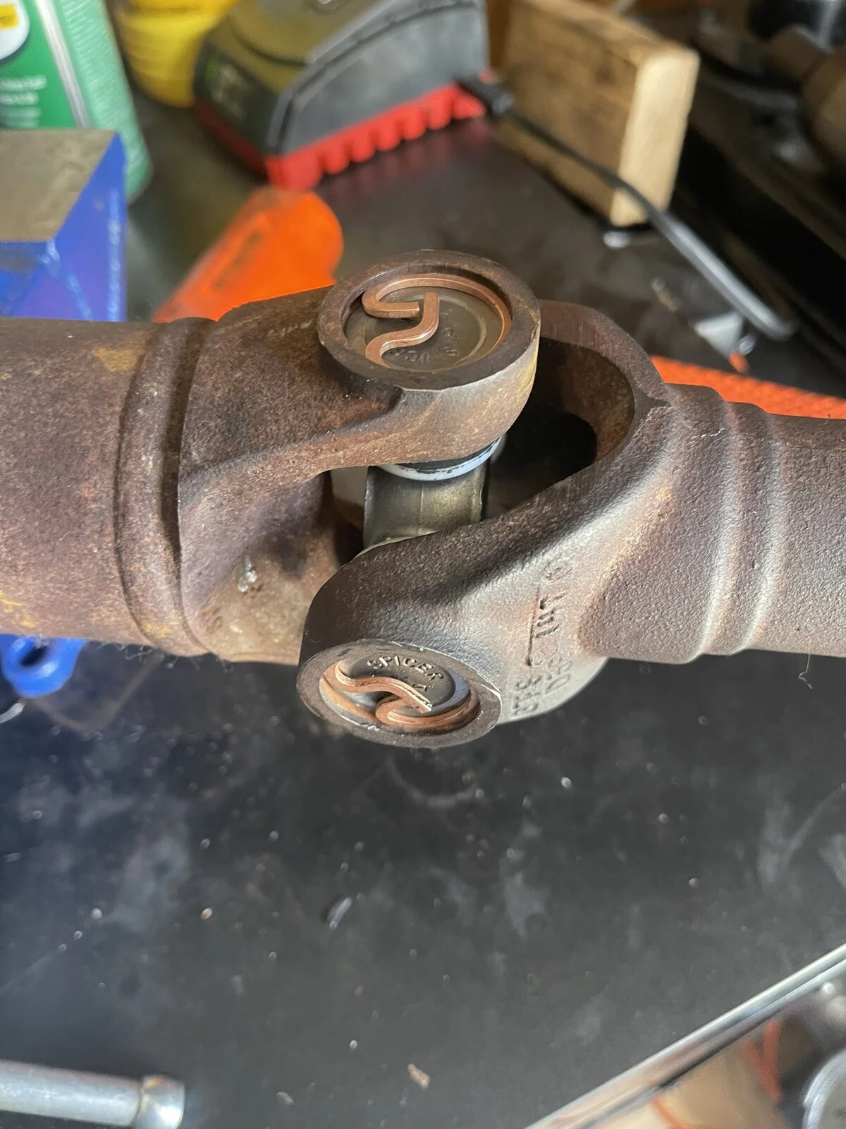

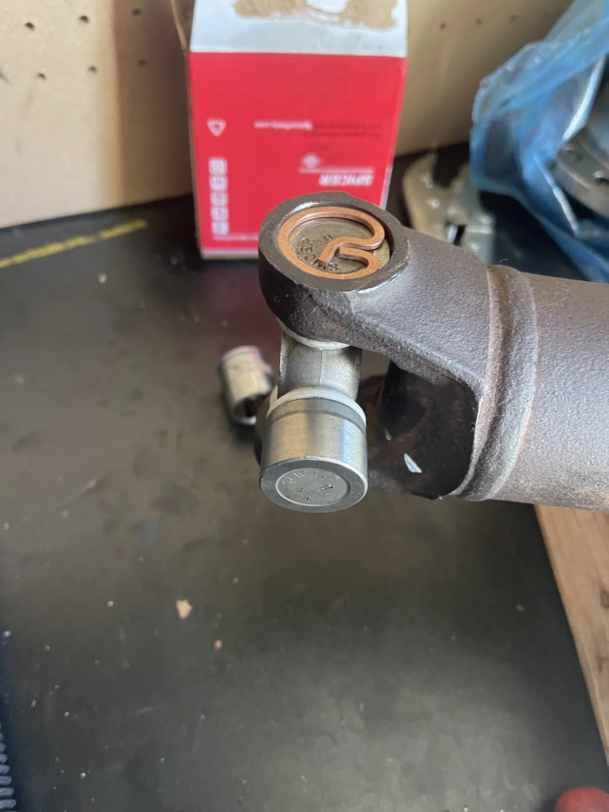

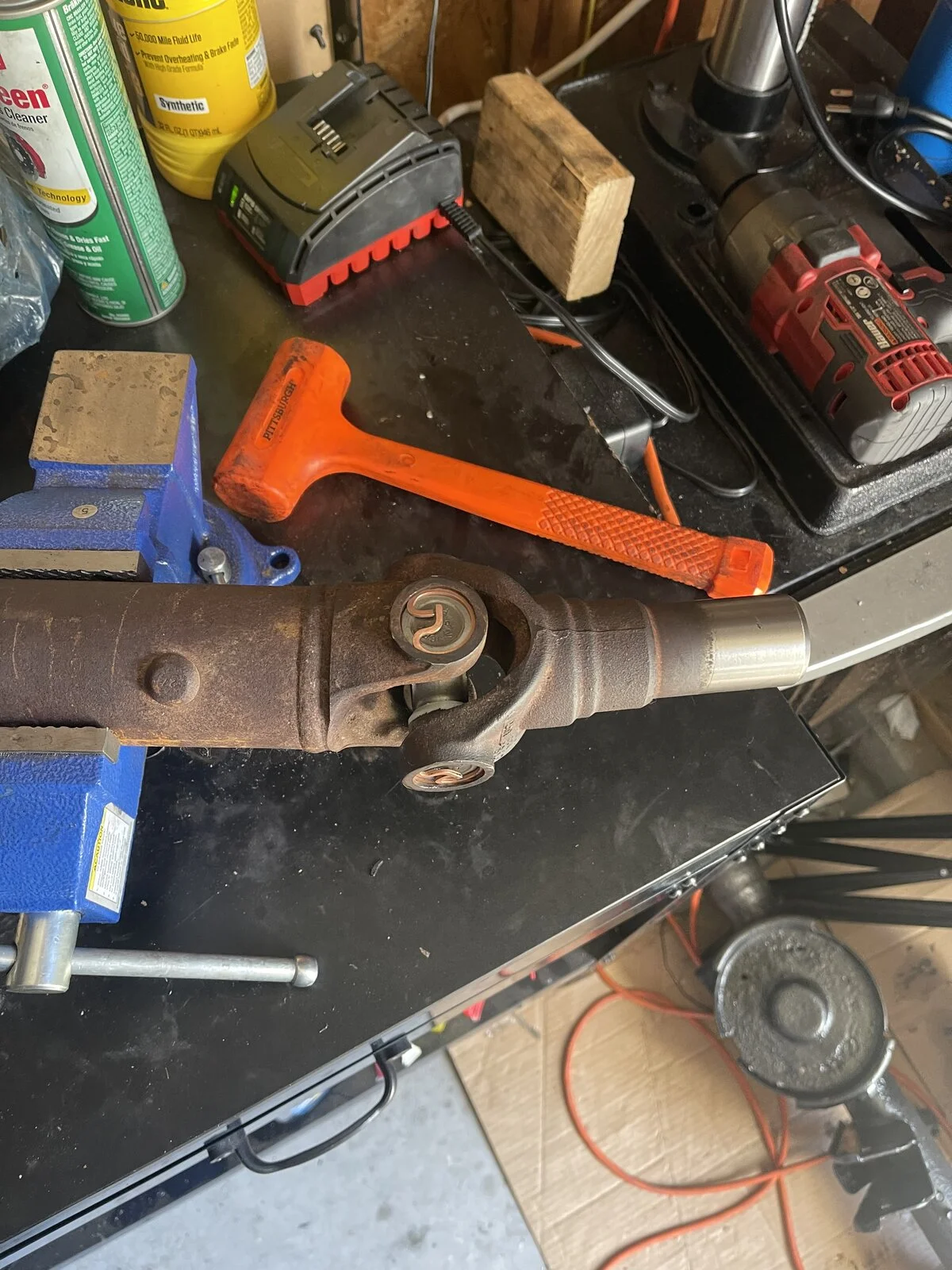

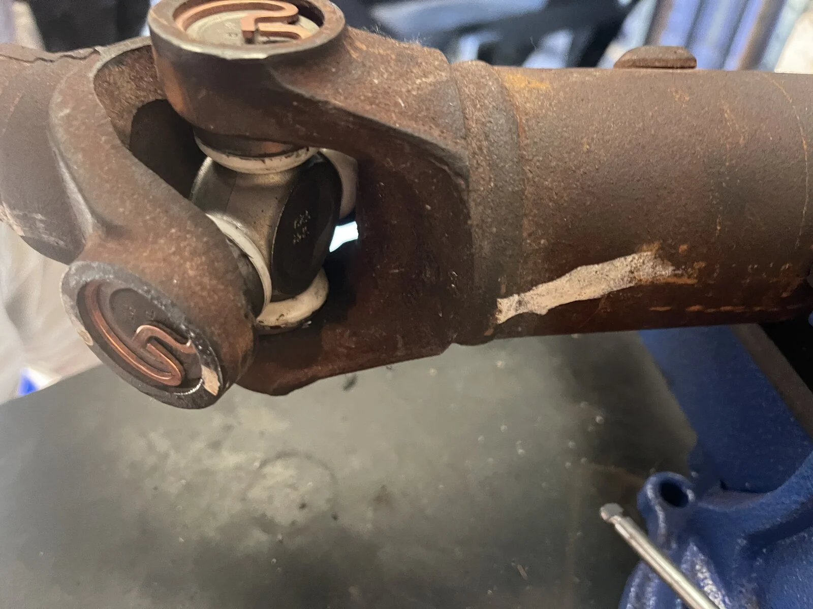

I have also known my driveshaft ujoints were bad (original 2004). So I started pulling those and swapping in new ujoints.
Have a few stripped bolts on front driveshaft I’m going to have to troubleshoot tomorrow but hopefully that gets me set up.
Rear went back together real easy. The joints yesterday wouldn’t stay straight. They just flopped if not supported.

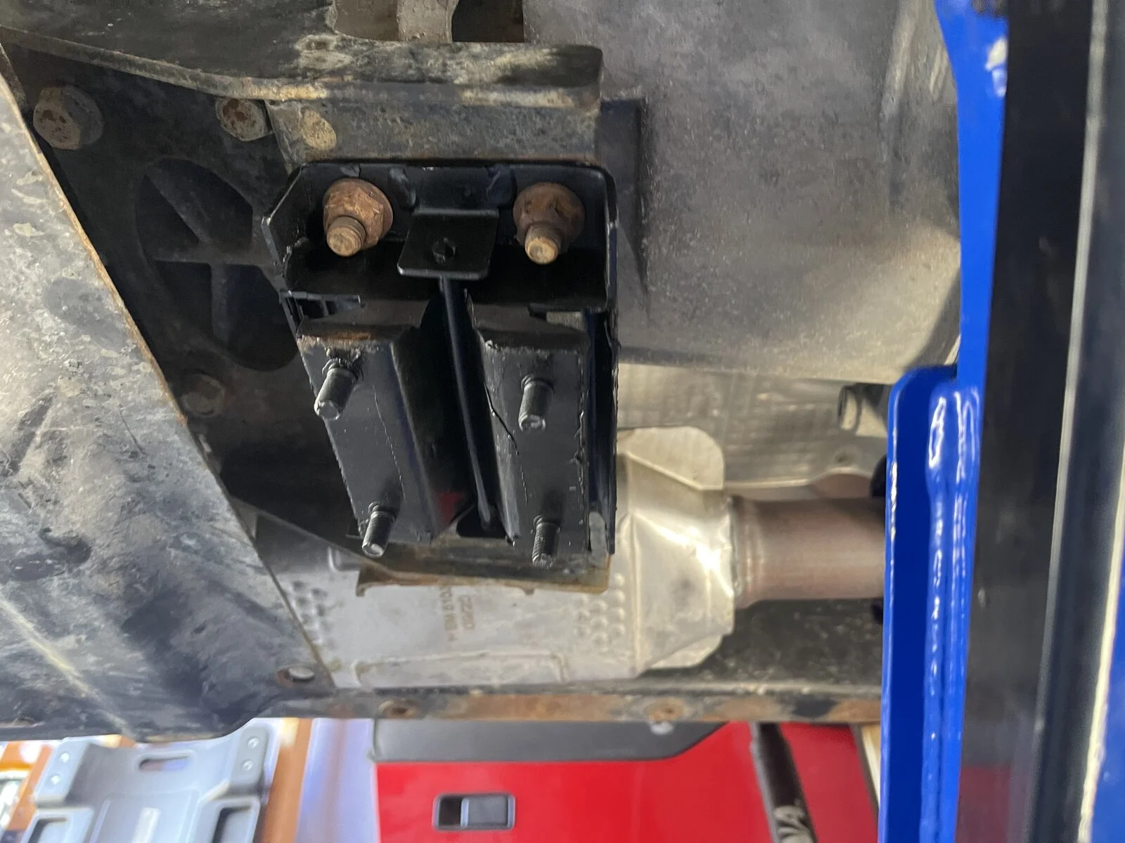

Took opportunity while skid plate was dropped to swap out transmission mount. The ujoints and this mount have been in my parts bin for a year, just hadn’t gotten to yet.
