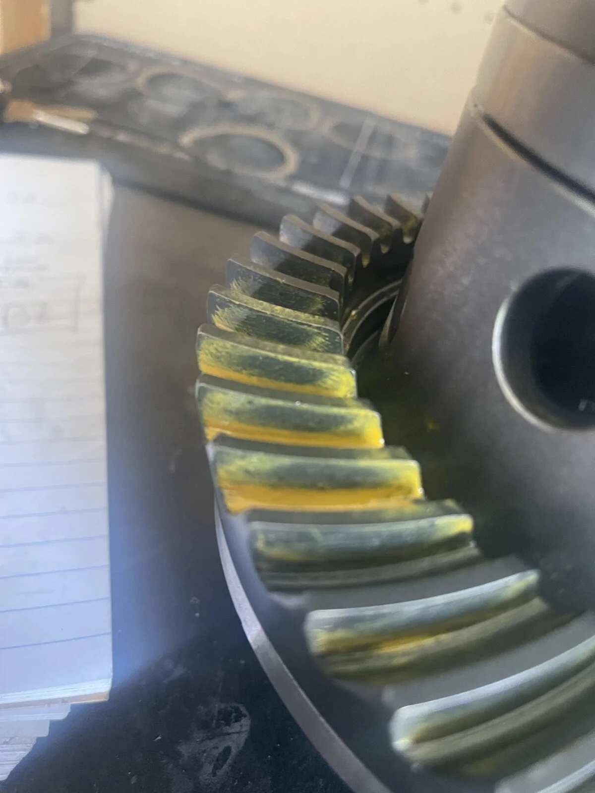

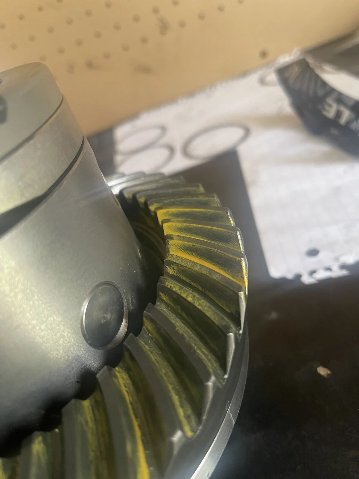

Here’s .032. I like this a lot. There’s a very thin line across the top on both drive and coast. Pretty centered. I know we’re nitpicking at this point but might as well do it right
I'll let you choose between 31 and 32, that way you can't blame me later!

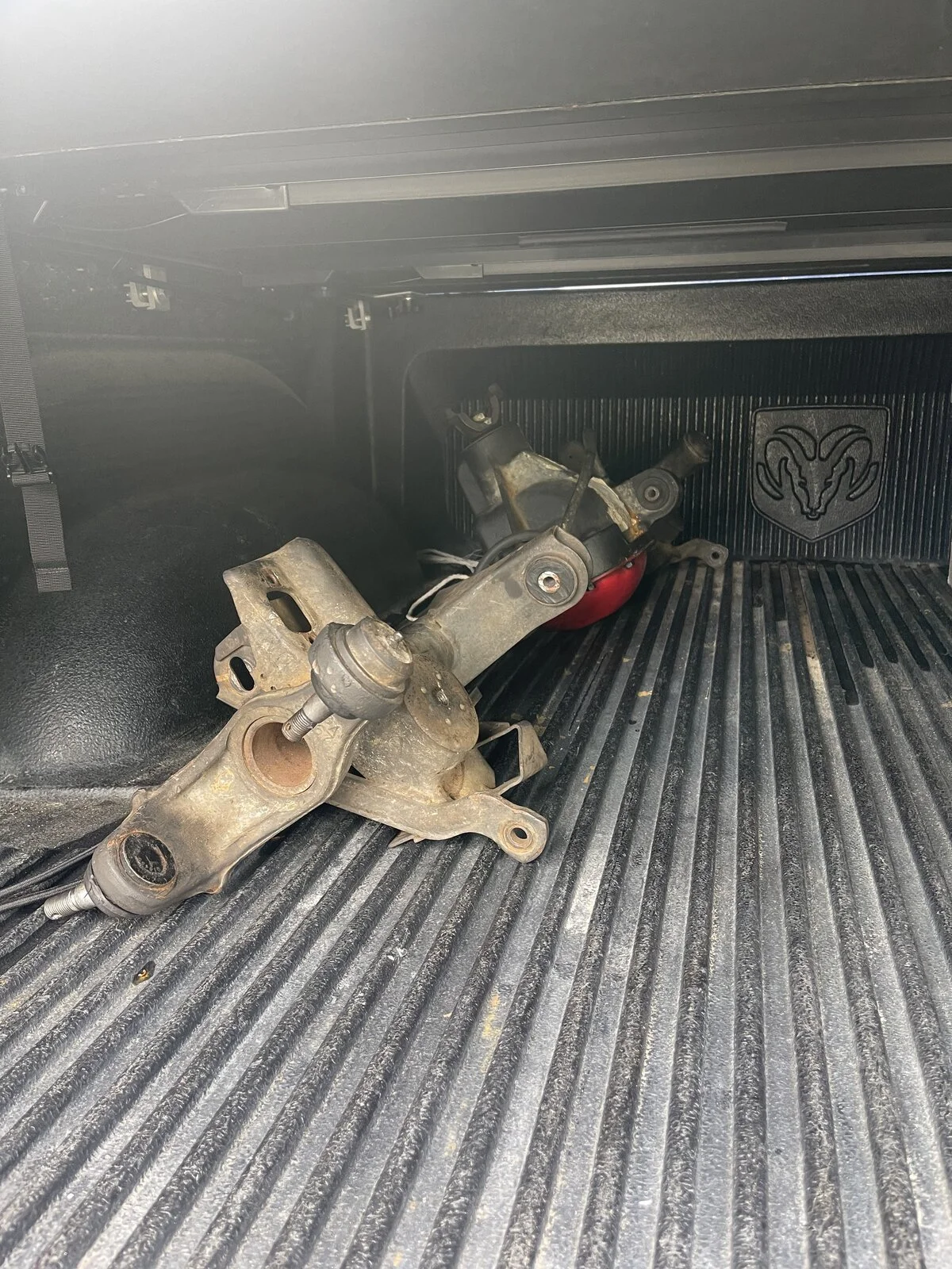

Old axle pulled and waiting for @MountaineerTom to pick up tomorrow.
What's @MountaineerTom going to be doing?
I'm glad I'm not the only one wondering what's going on!
Rear steer.

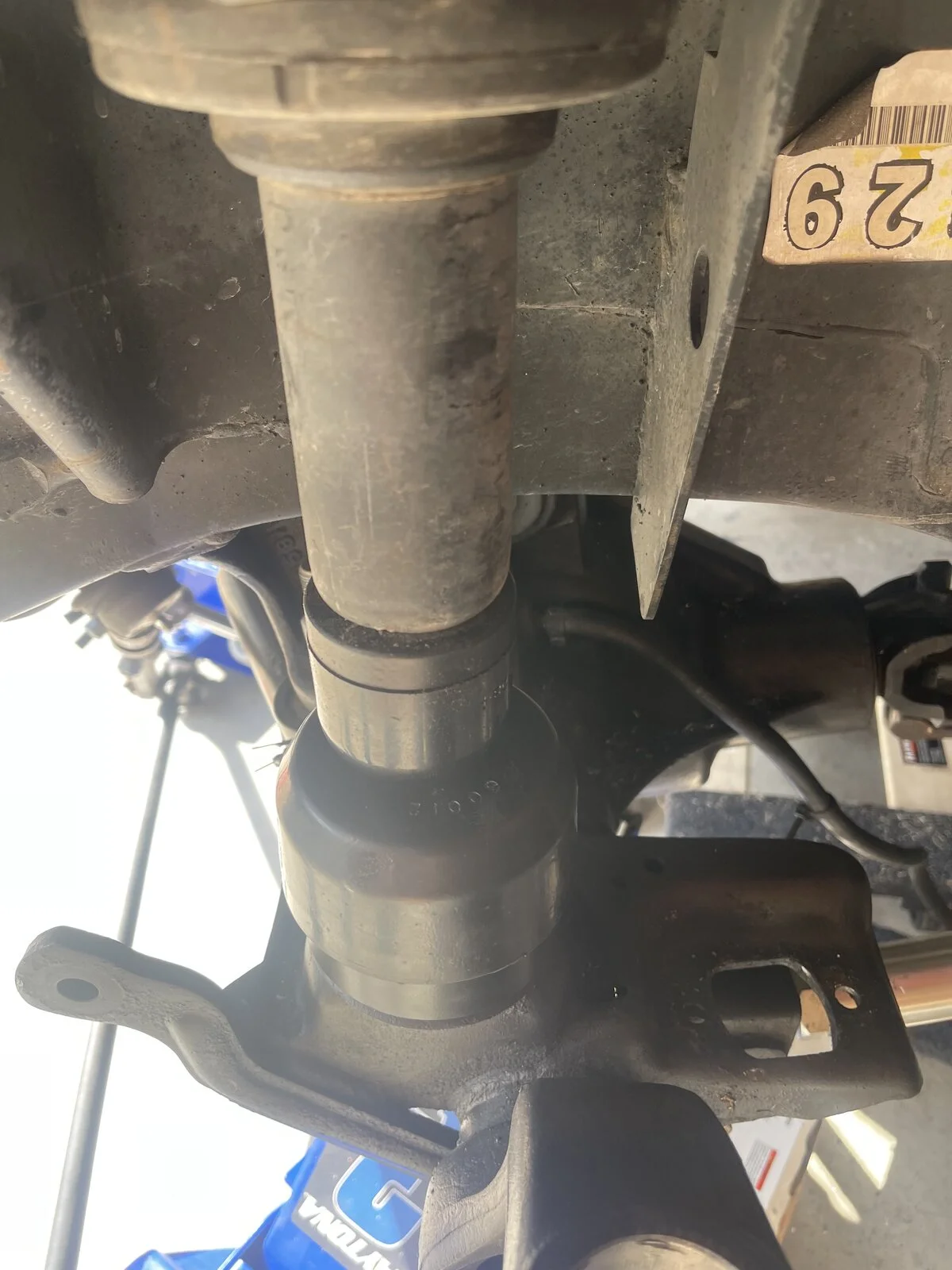

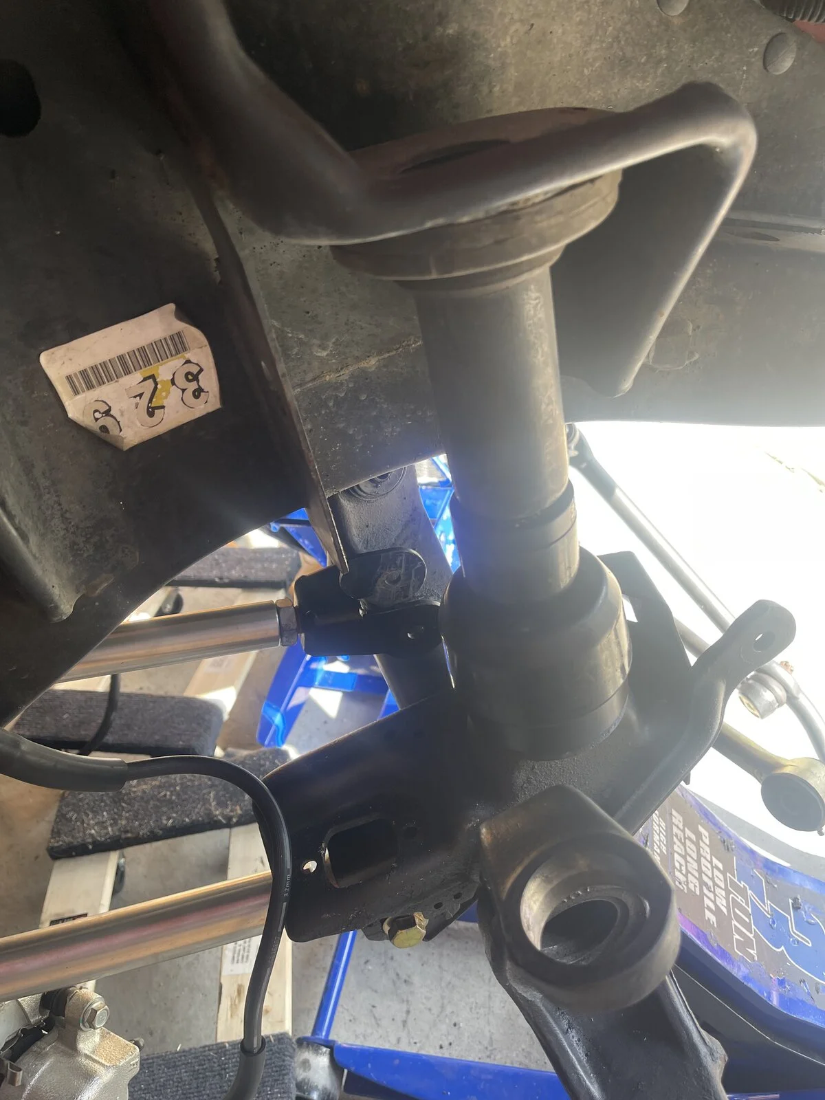

No real updates in the last week. I learned the (hard way) I need knurled ball joints for new axle.
Amazon has decided 2 day prime = 5+ days so whenever joints show up I’ll button the front end up.
