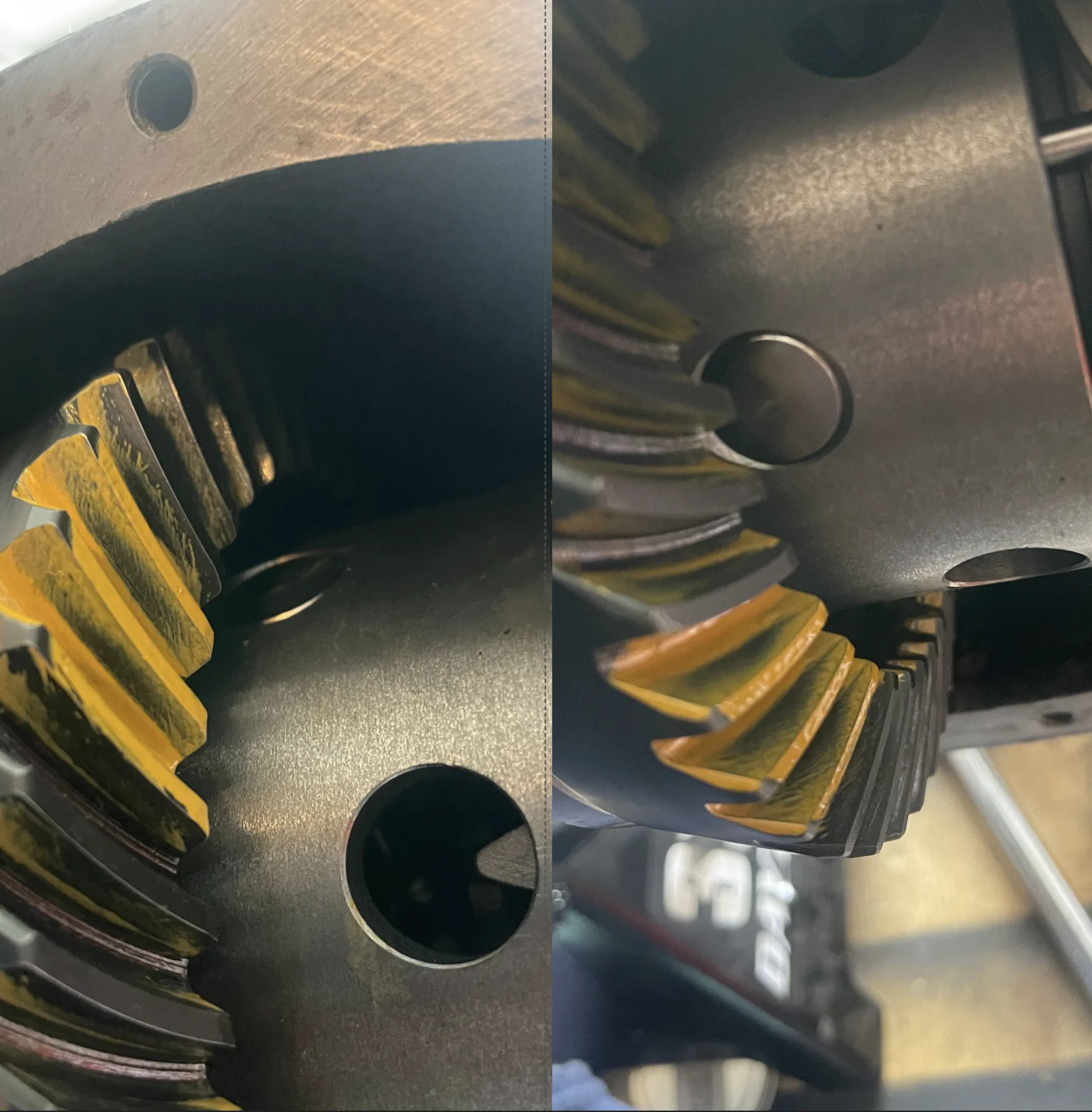

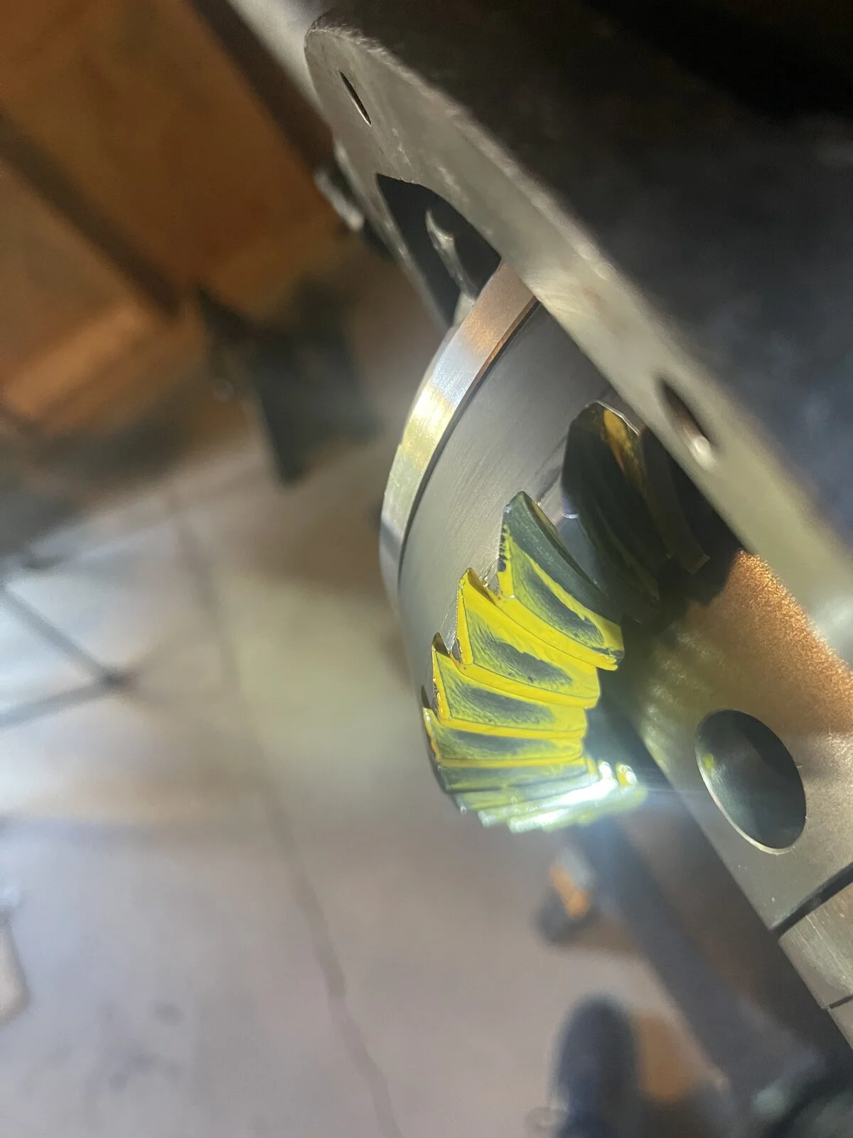

Had few things come up and didn’t get to work on this much.
Here’s where I’m at currently. This is try 2. First was way shallow. Added .02 and ended up here.
LP Dana 30. BL is at 8.5ish.
Thoughts from anyone who actually knows what they are doing?

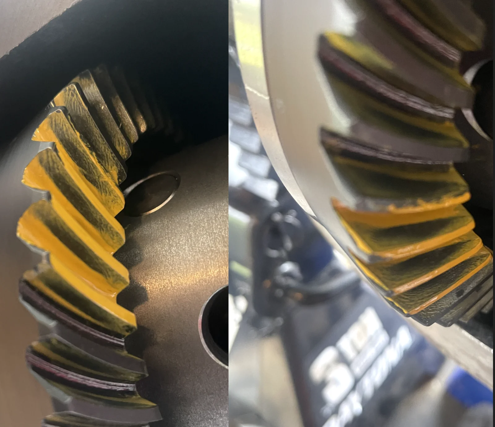

heres where at now. This is around 41 thou. For reference the picture above was at 50 thou.
Checking my understanding here - I think this pattern is bad because the line on the root of drive side.
The coast side doesnt look horrible, its a bit off center from toe to heel but pattern looks mostly centered vertically?

Sorry I was out chasing gators on the golf course all day! Still a tad bit deep. Drop 3ish thou and check.

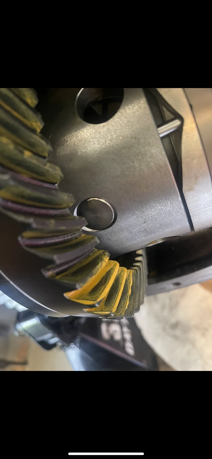

This is about .039. Backlash is just at .006.
Looks quite a bit better to me? I probably should go to .037/.038
You are very close. Yes, drop 1-2 thou

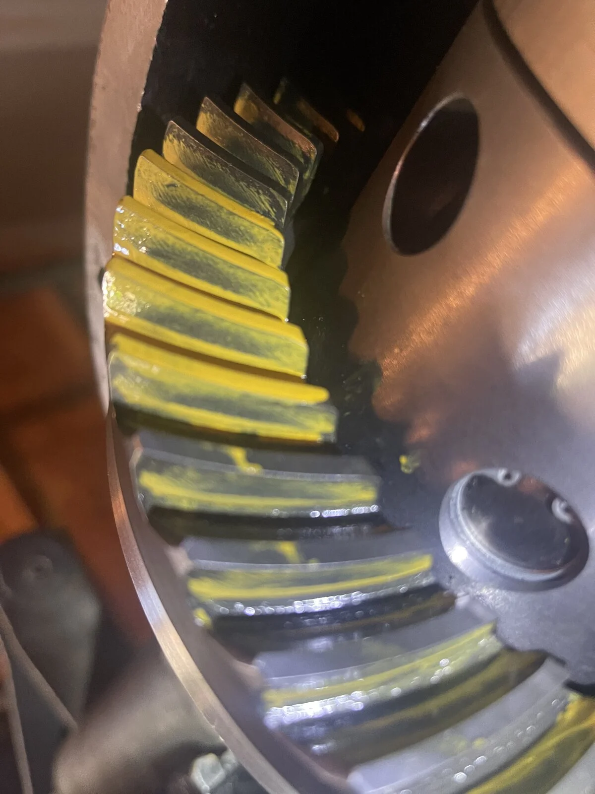

I tried .038 and didn’t get much difference. I’ll try .037 in morning. One of those two will work.

Remind me what axle this is. Pull the locker, clean the bearing seats again, reinstall and make sure it's seated properly. If you aren't, make sure to put the bearing caps on snug before running a pattern. To me that's a lot of difference for a 1 thou change. I'm traveling today so hopefully someone else can chime in if I'm out of WiFi range.
