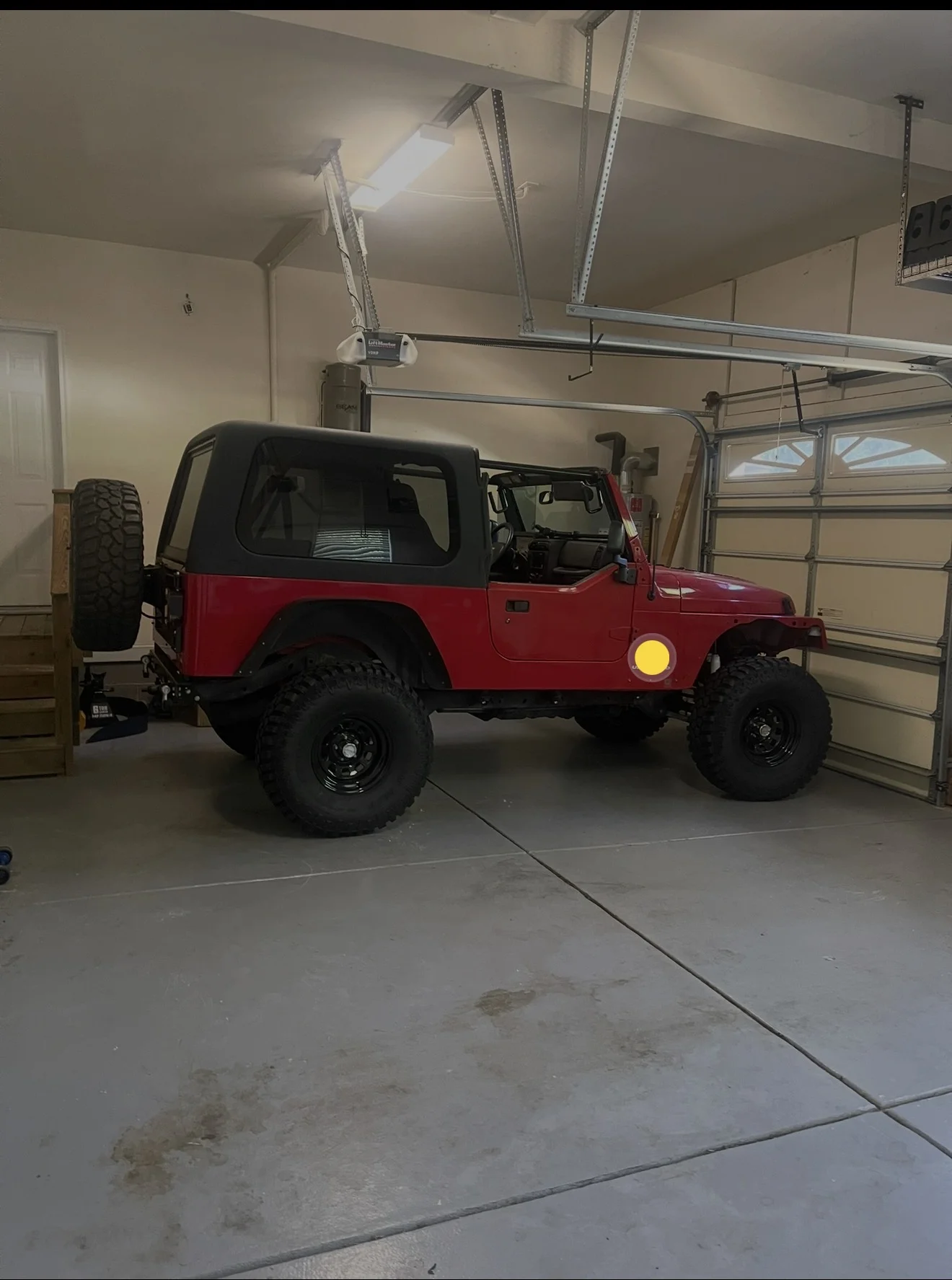

I haven’t put my hard top on LJ in 2 years and am considering selling it. It’s a 2 piece + with some light damage/scuffs to the top.
Will let someone claim it here for a fair price before I post on marketplace.
2 piece? Pic?

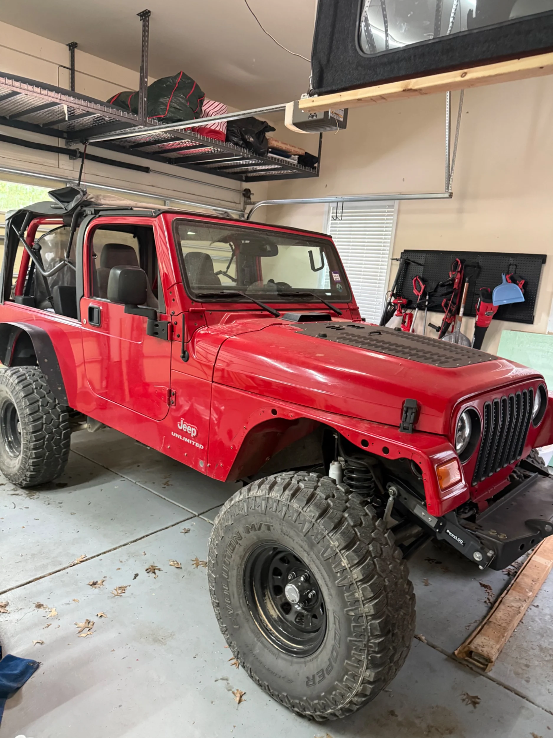

This shows roughly the two piece layout. Covers back seat / trunk and the separate piece covers front seat.

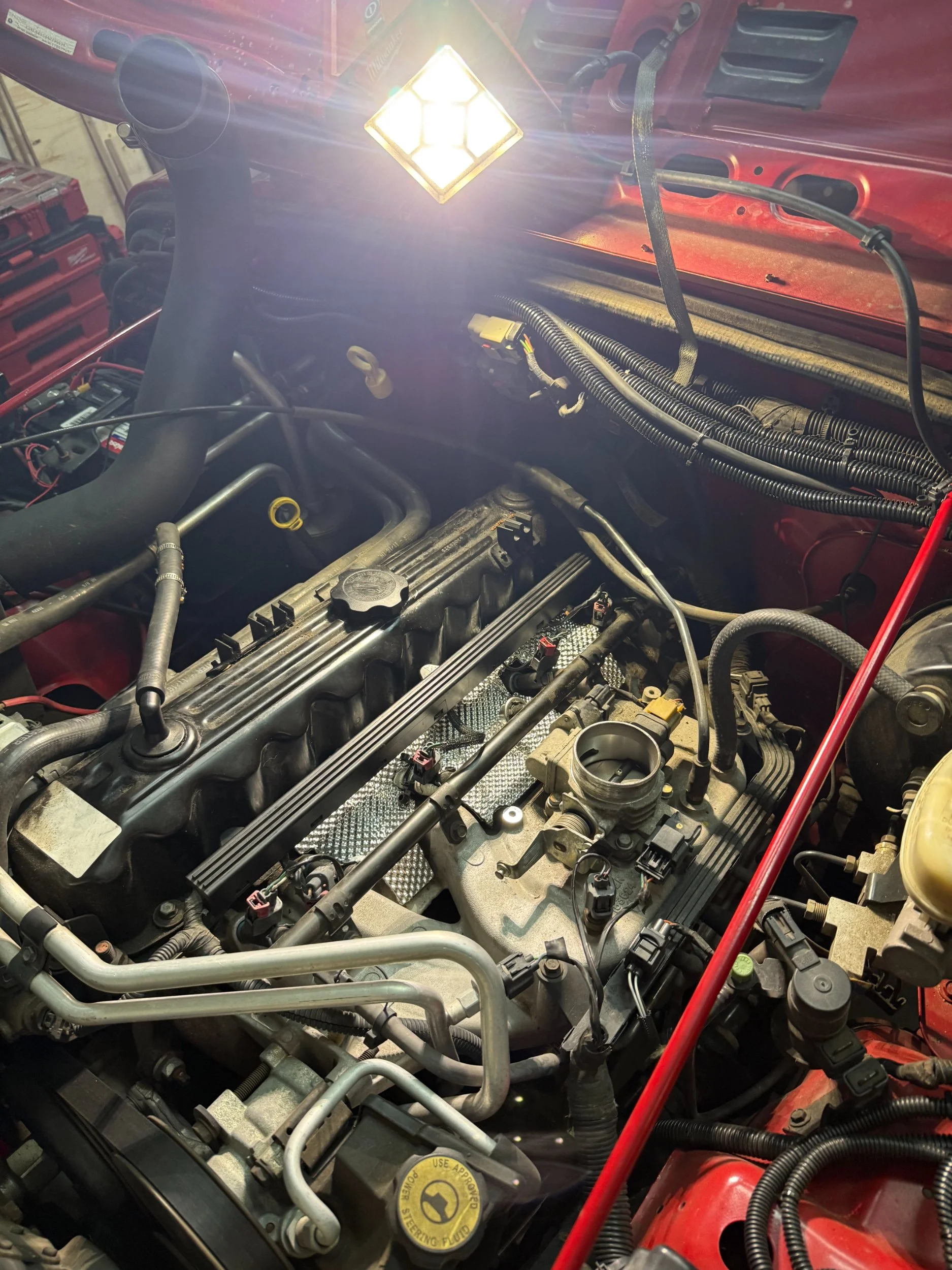

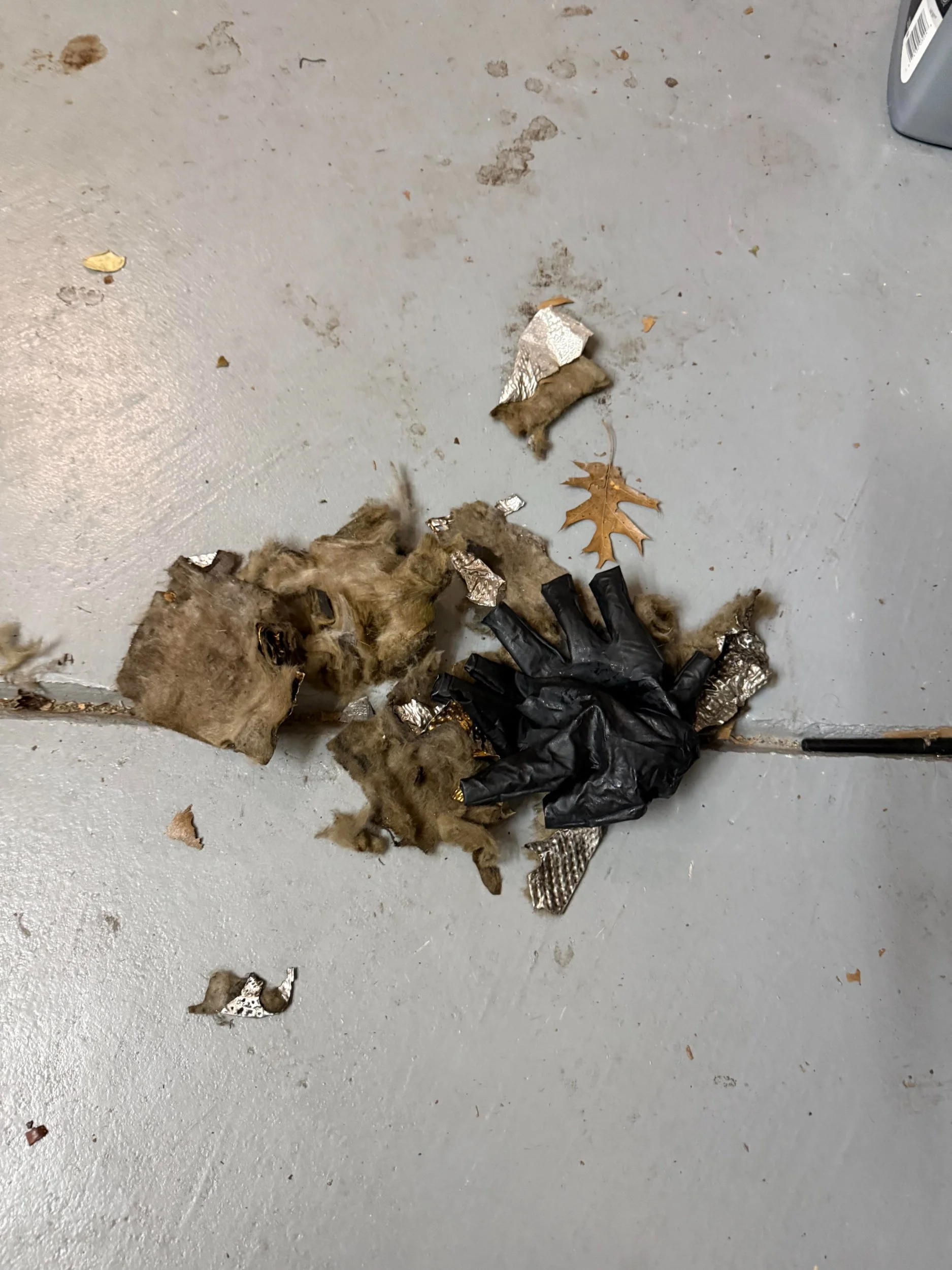

Jeep threw a cylinder 3 misfire from heat soak last weekend at Uwharrie. New heat shield and injector shield showed up yesterday and I threw them on tonight. Should fix the problem. First picture shows my old heat shield. Definitely original and looked like this laying on the exhaust manifold. New one looks shinny again - at least for a few days.

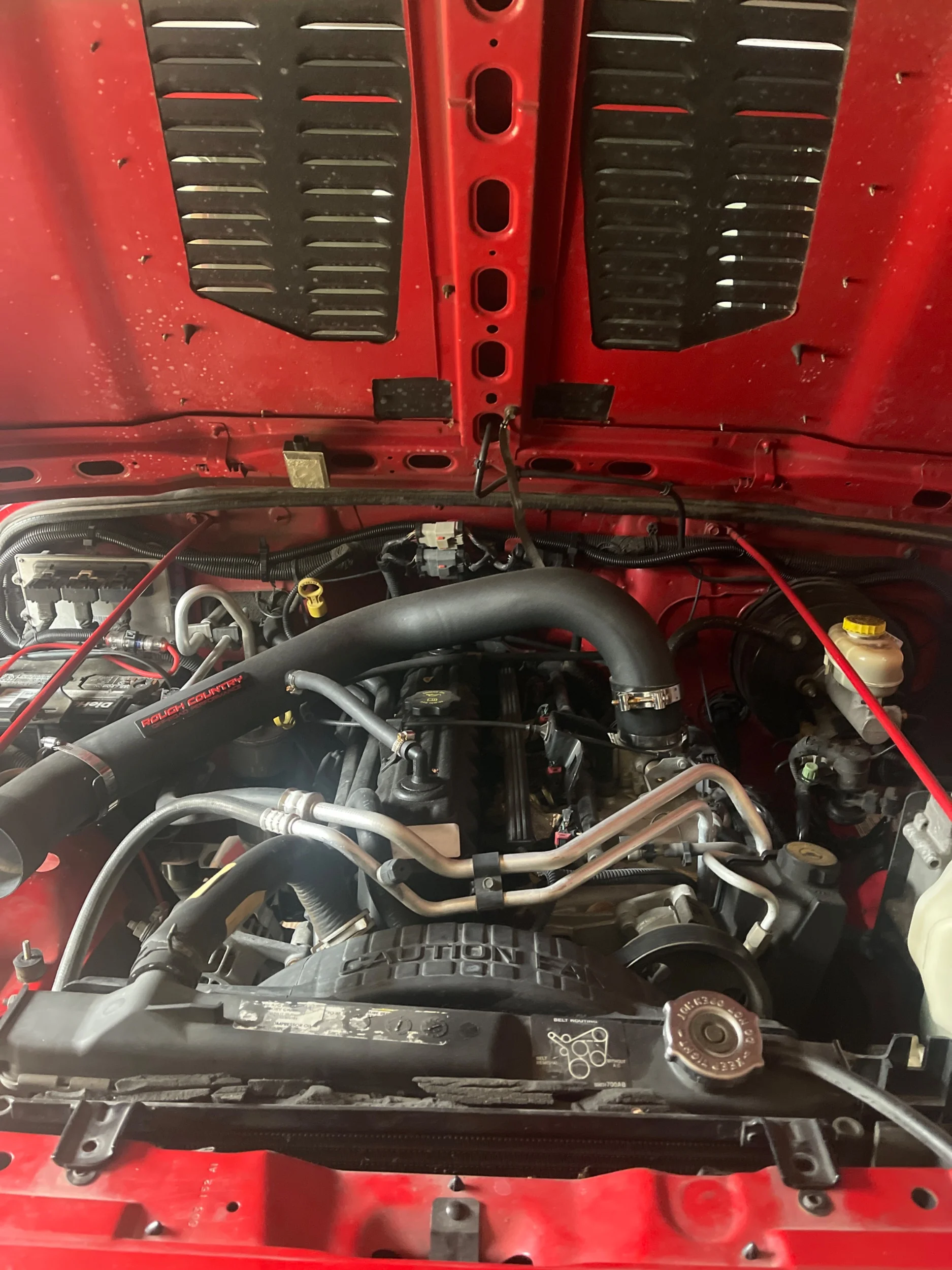

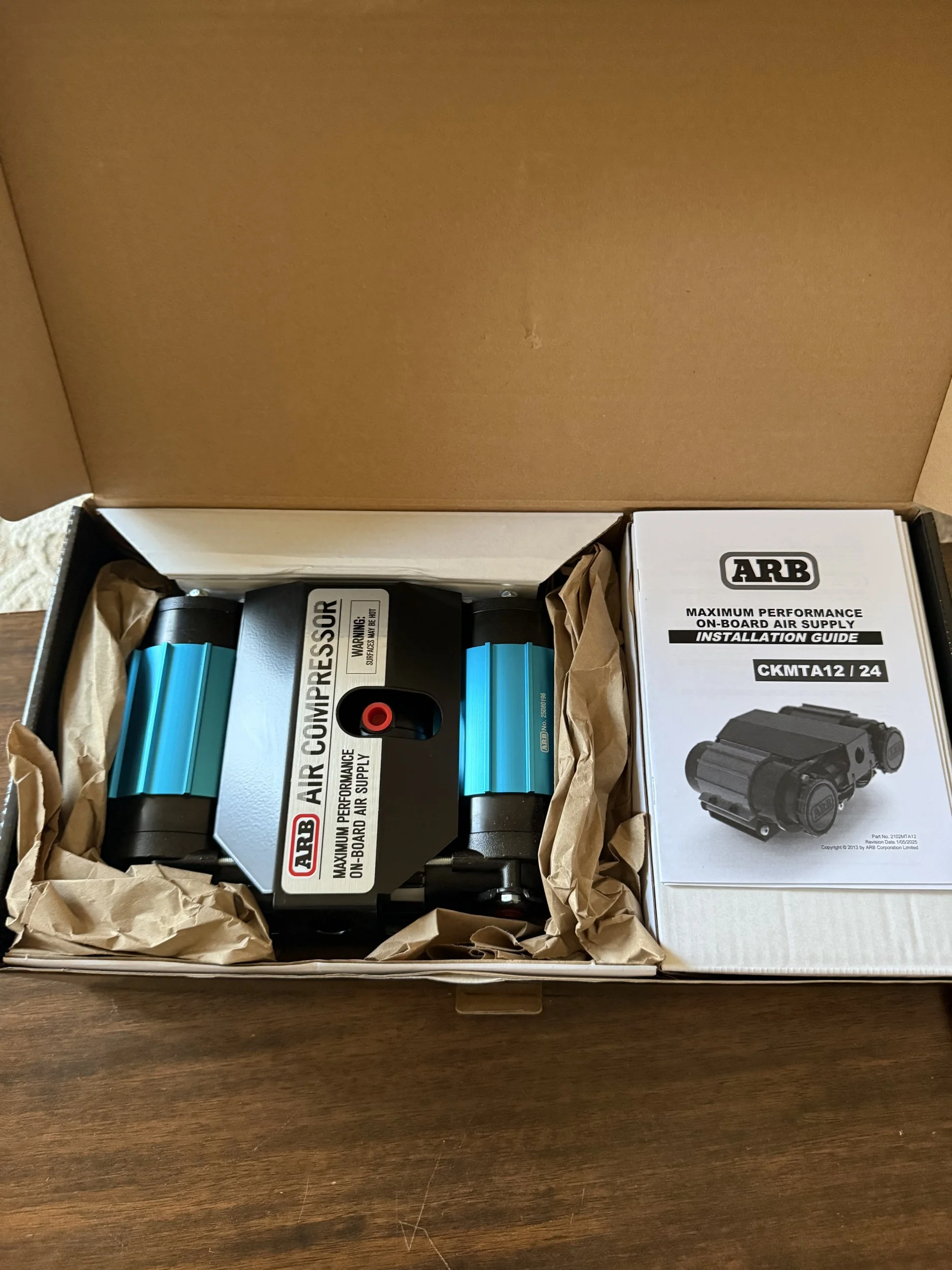

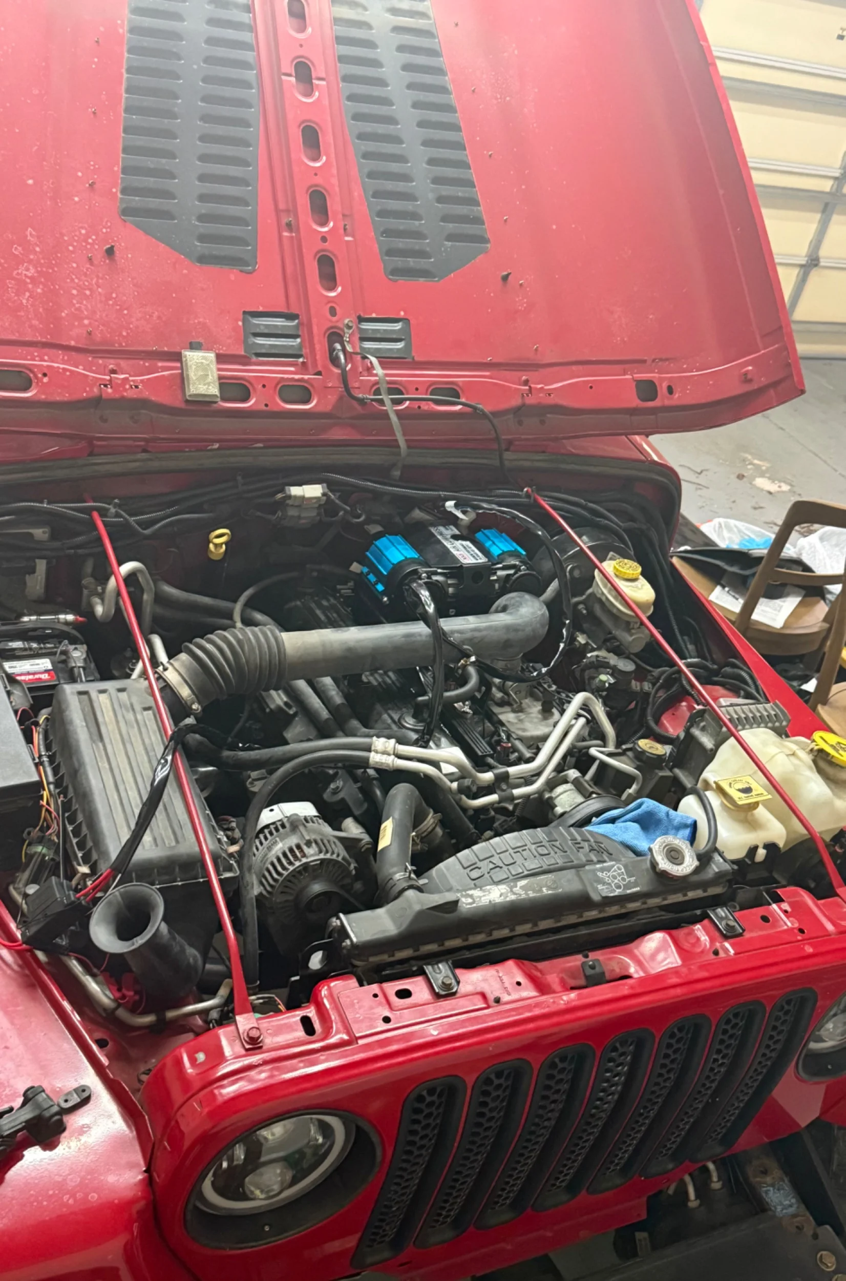

This weekends project is finally installing the dual ARB compressor I bought months ago. Step 1 was ripping the cold air intake off and tossing in the trash. Step 2 was replacing with a 20 year old new (to me) stock version.
Have the wiring harness laid out and need to relocate some other wiring from my lockers. The spots worked when I had the cold air intake but don’t with the stock box.
Hopefully have system working by tonight
