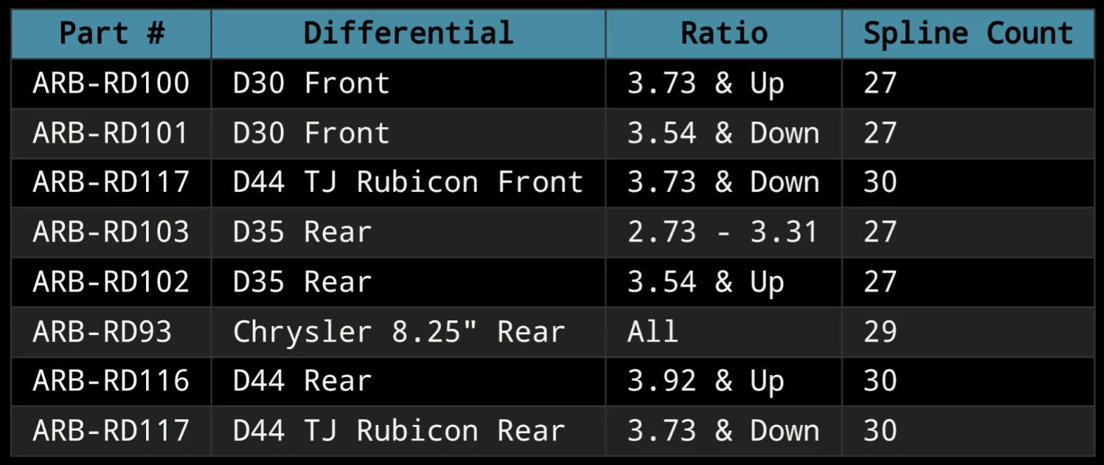

That sounds very odd. Did you call Eaton [800-328-3850] to make sure? I know when I bought my ARBs, it was very confusing because the "3.73 & down" and "3.92 & up" weren't accurate for a Rubicon due to the thick cut ring gears. I had to contact them to make sure I bought the proper ones.
No I haven’t called. I’m probably a month out from actually installing so hasn’t been a priority. Have a few projects to button up before I get that far. I agree it’s odd and am hoping someone here knows specifics.
Which arb did you have to get @sab? I’m intending on putting 5.13 thick gears in my rear Dana 44 so likely need same setup you ended up with for your rubicon
I ended up with the RD-117 for both my Rubicon axles. However, they're not installed, yet, so I've not confirmed fitment 100%.

In my research for the eventual demise of the factory lockers, I found quite a bit on the ARBs. The difference in a RD116/117 in a Dana 44 is thick vs standard cut gears. As long as the gears are correct for the carrier, either will work in a Dana 44 housing.
https://wranglertjforum.com/threads...le-carrier-breaks-explained.20622/post-335808
Interesting. 3.73 and down is what Id need in rear w thick 5.13s. Thanks for info.
Yes, what I remember from the conversation was that you use 3.73 and down with the stock Rubicon thick-cut 4.11 gears. If you re-gear after that, you have to order thick-cut gears to keep that locker. However, if you re-gear and put the locker in simultaneously, you can use the RD-117 with thick-cut gears or the RD-116 with thin-cut gears. It's very confusing...

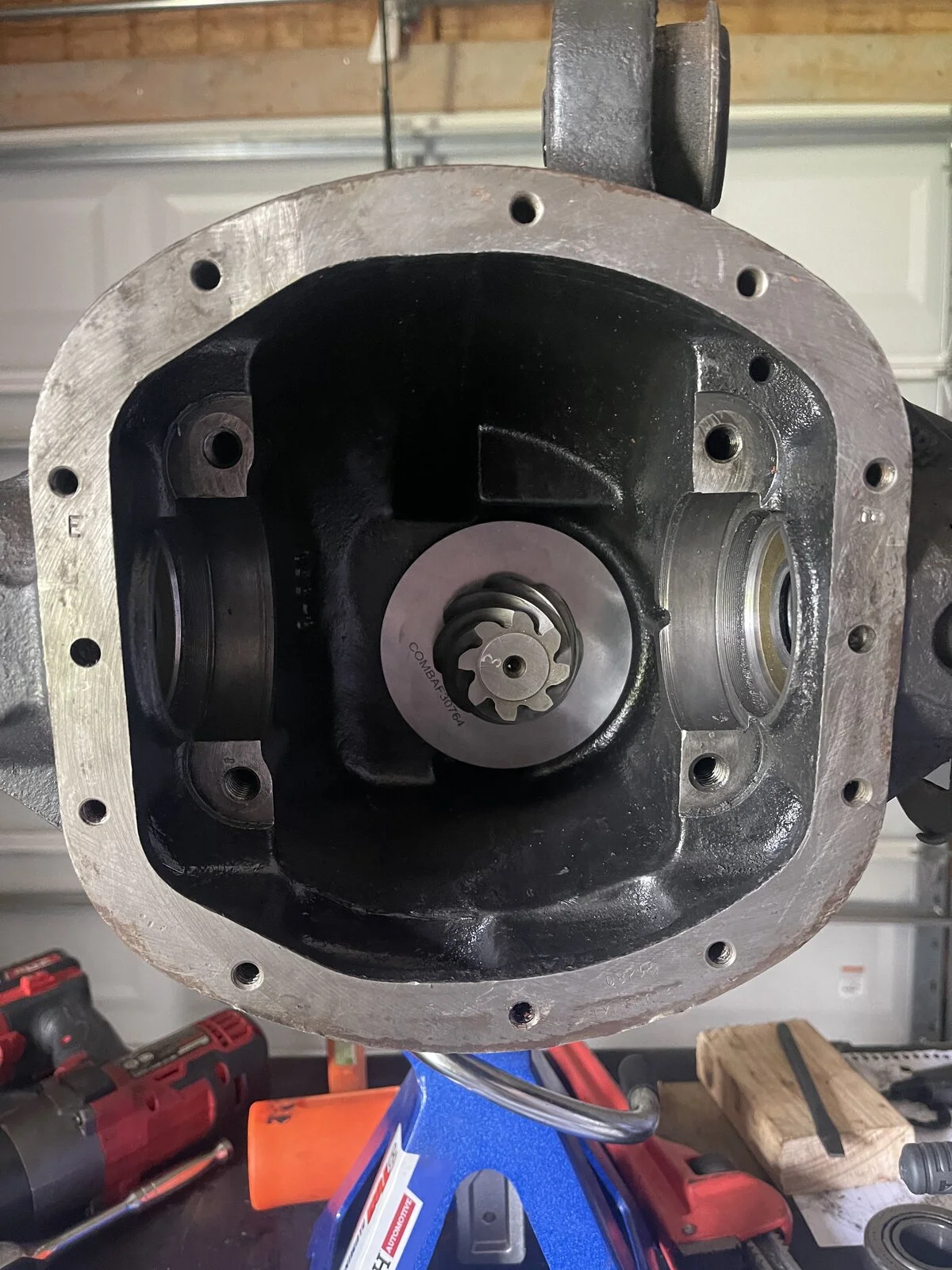

New bearing arrived. I pressed on. There’s a chance this could go a tad bit more but I didn’t want to hurt anything. Spins freely. The gap looks bit large?
Reactions: PNW_LJ
I pressed bearing a tad bit more but it’s seated.
